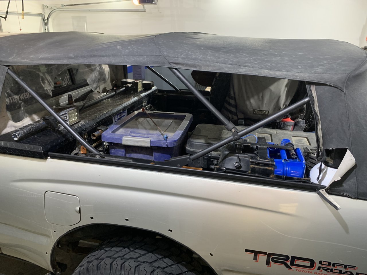

    And yeah I think trying to make everything more efficient, have more space, have true dry storage, and make camp pack up a little faster. Currently my high lift is mounted to my tool box, which wasn't a big deal even when it was loaded with all my boxes. That changes with the addition of even a soft top, I can't just jump into the bed and grab it. You can see here, in order to get it, I need to unload half the truck I realized the pain when I needed to get it in Bald Eagle to free the chain saw from the tree I was cutting.
    That's not a bad idea. I love the idea of a drawer system too so I don't need to carry as many boxes either. Would shorten pack up time too. Downside to that is the ability to carry mulch or wood to split.

    I don't have drawers but boxes that slide under the platform. I can easily remove the center section to haul wood. I originally designed it all to be easily removed though for when I needed the bed.
    I need to redesign it as the years haven't been to kind to it but I think it'll remain similar. Still had the side pockets in the bed in this pic.

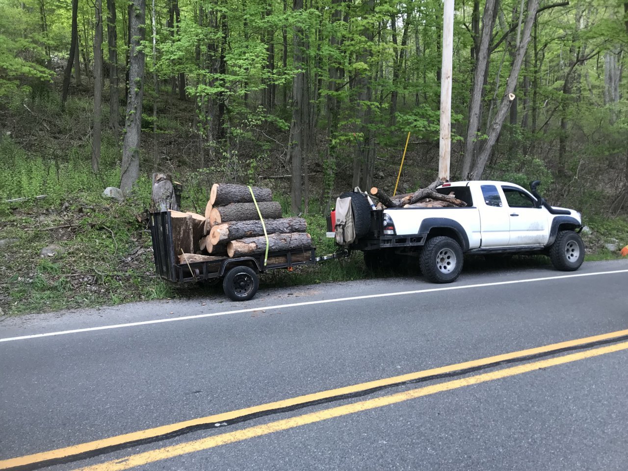

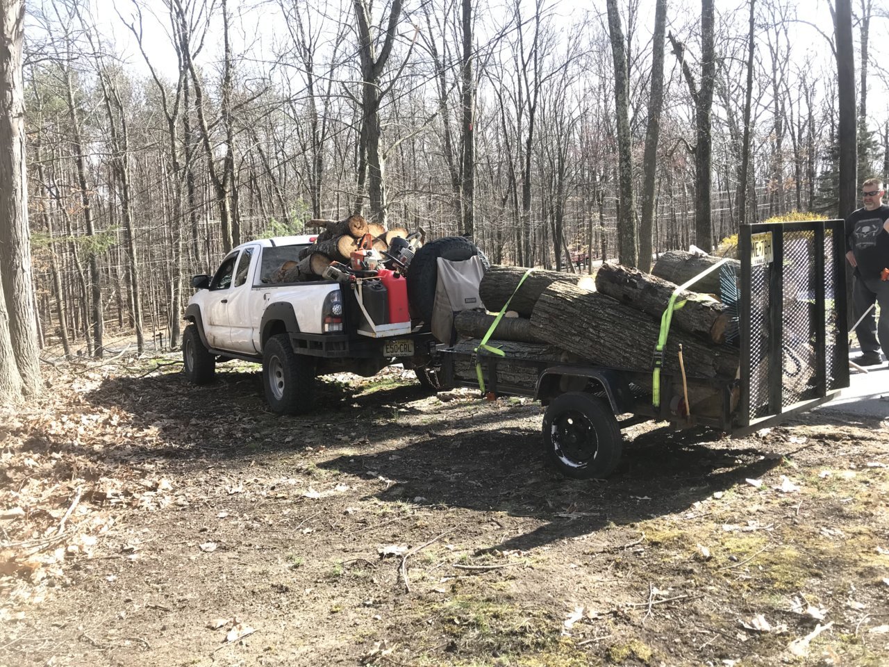

    Four banger for the win
    FA8A6371-282D-4D18-AB1B-9CA91A7C0B0F.jpg FF73AEAC-EBB2-4440-A9A9-419F4CF25B2F.jpg
    Reh5108[QUOTED] and HomerTaco like this.

    Looks like airbags FTW - no squat there
