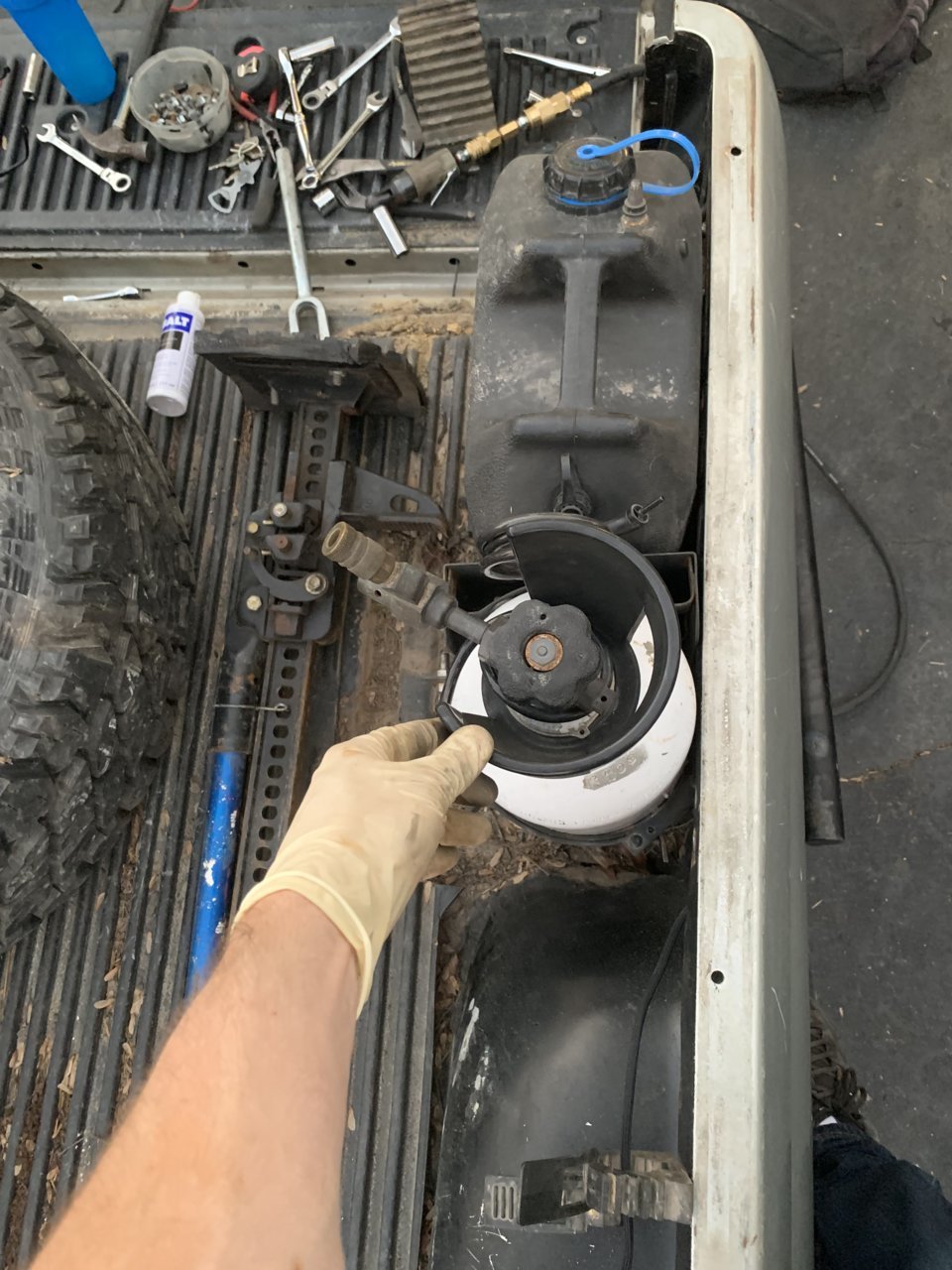

    Made some (slow) progress. I replaced the pre filter on the fuel pump for my second gas tank, replaced the gasket, cleaned up the rust and sealed/painted the seams of the entire tank. Probably unnecessary but might as well do it while I have the chance.

    Now at least I can put it on with peace of mind it should last another 10+ years (though maybe not the used pump).

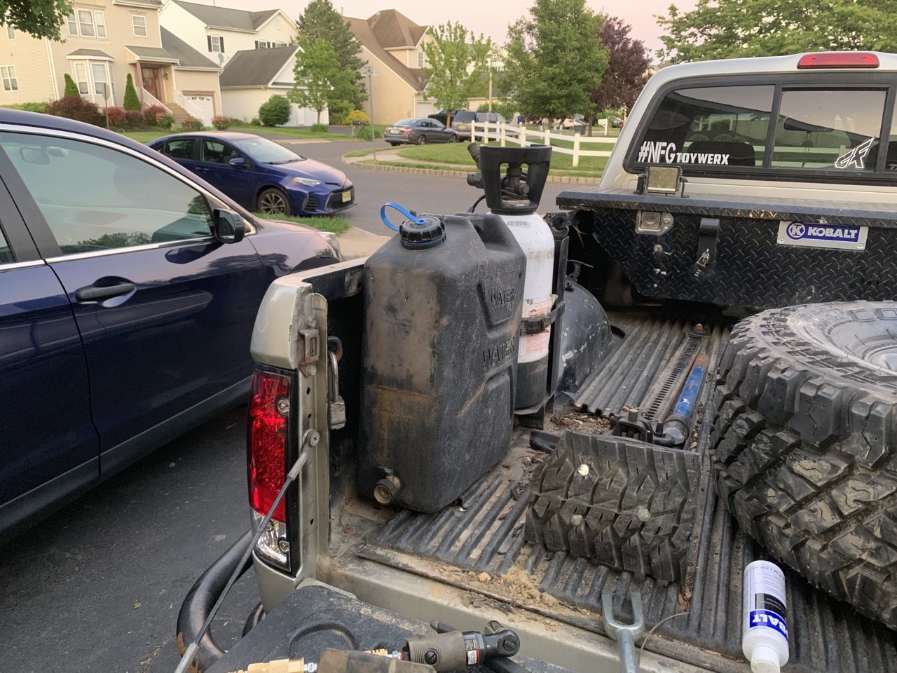

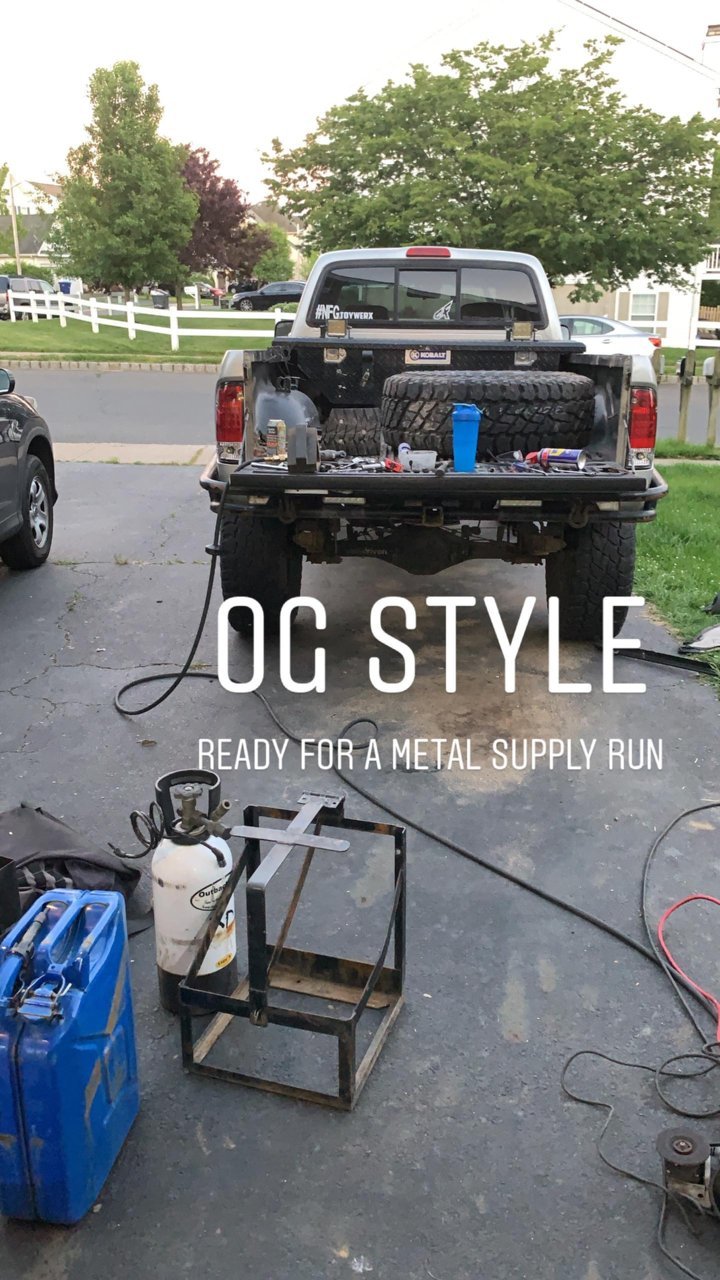

    Took a step back last night to take some huge steps forward hopefully. Realized I am running out of time before my next trip and even though the bike is back to stripped I need to make some serious progress on the truck soon to get my anxiety in check.
    Also did a POC for the bed redo.
    This will accomplish two things. Not needing to remove the water can as much to have access to it. I can just put my hose on it and use gravity. And it will keep this stuff in line with the wheel well making packing boxes easier.
