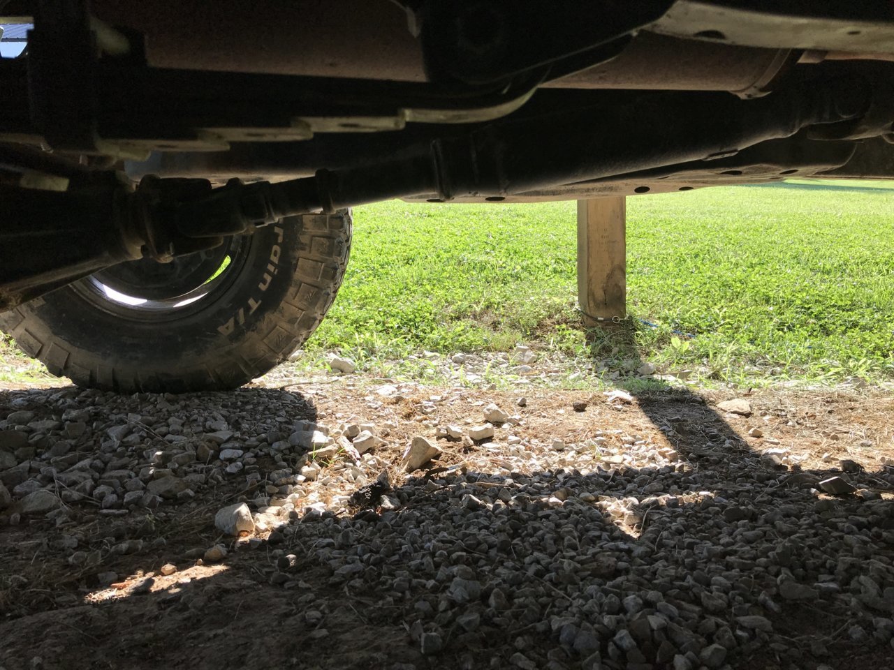

    And finally, the reason for all the work...
    [​IMG]Untitled by Michael Halat, on Flickr

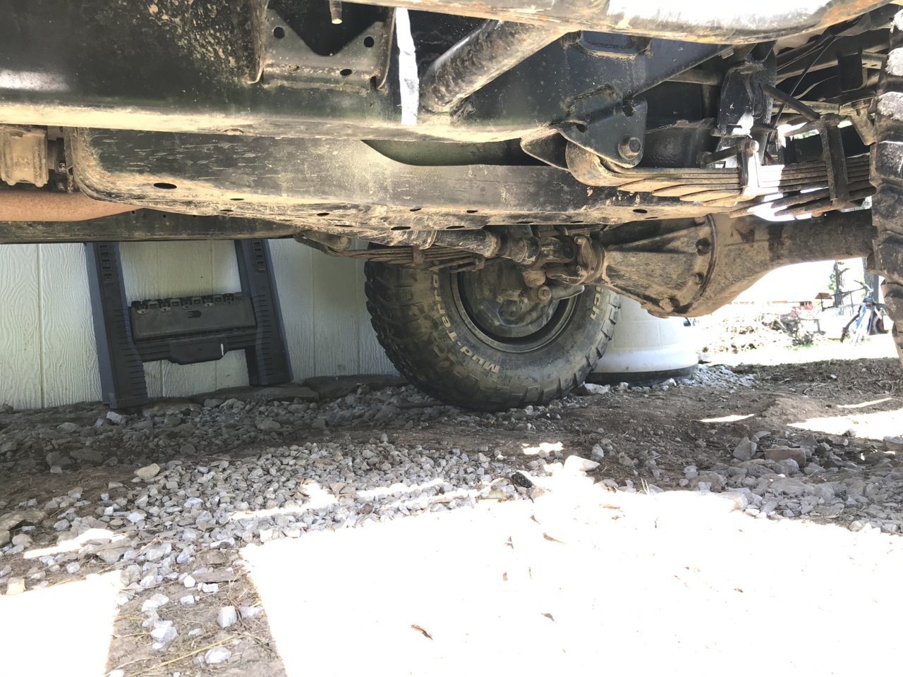

    I wish I took before photos. If any of you can throw up a photo of your current gas tank hanging down, I'd appreciate it.

    It’s a little less impressive when the skids on. The skid fought me the whole way too.
    But if I am hitting the tank/frame at that point I’ll be well into the drive shaft too. :rofl:

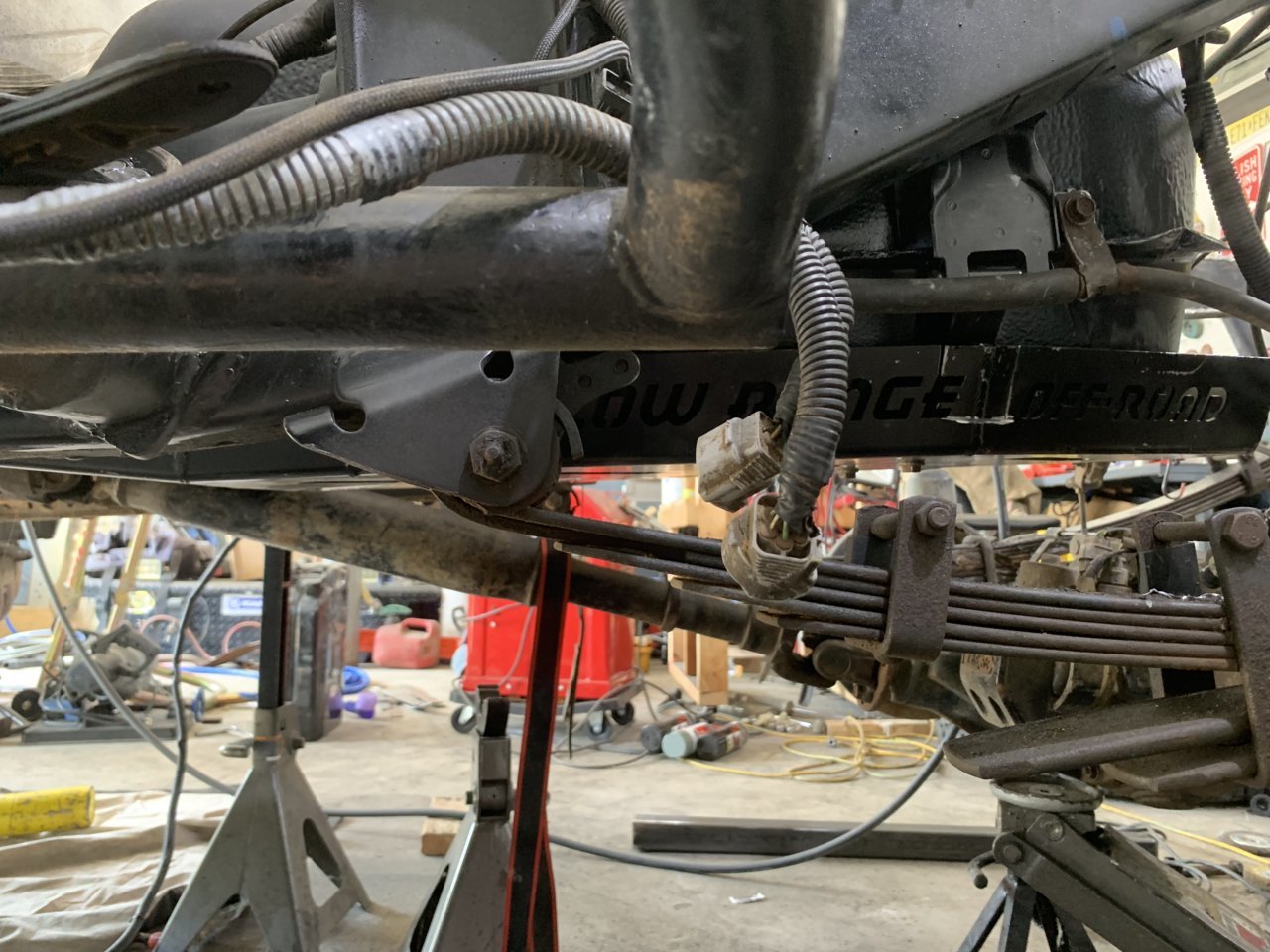

    I was gonna say, you may be needing a new drive shaft if you ever hit the tank again

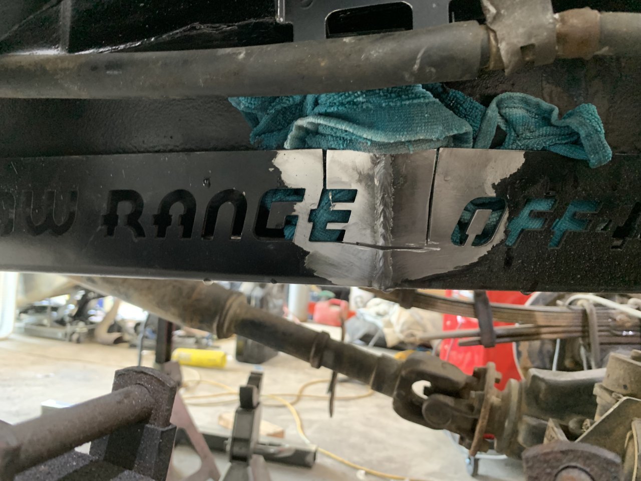

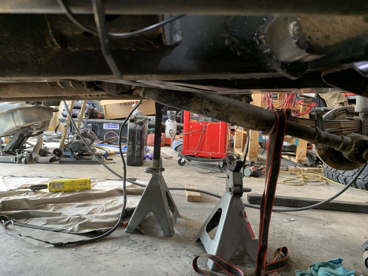

    Yup, have had it since Christmas lol. I had to cut it for the strap to fit but I will be welding that back together in a few minutes.
    Good thing I carry a spare. :rofl:

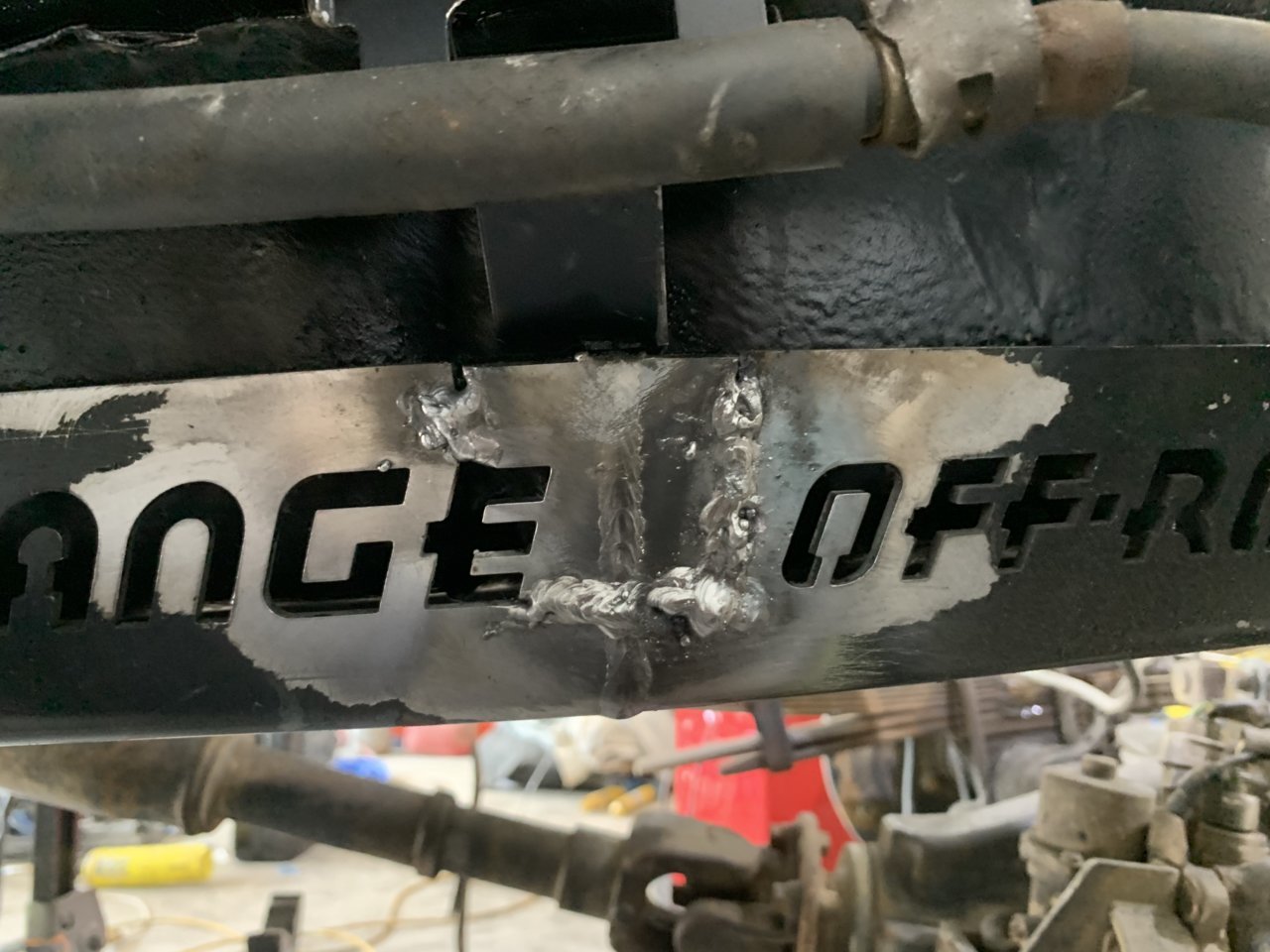

    Oof. Already missing mig.

    Frame plates? Those are going to rust terribly with those letter cutouts

    Lol no that's the gas tank skid.

    Did you....??....right there???

    :rofl: yes. But with an empty tank and wet rag behind it. But yes I was still worried about an explosion. :rofl:
