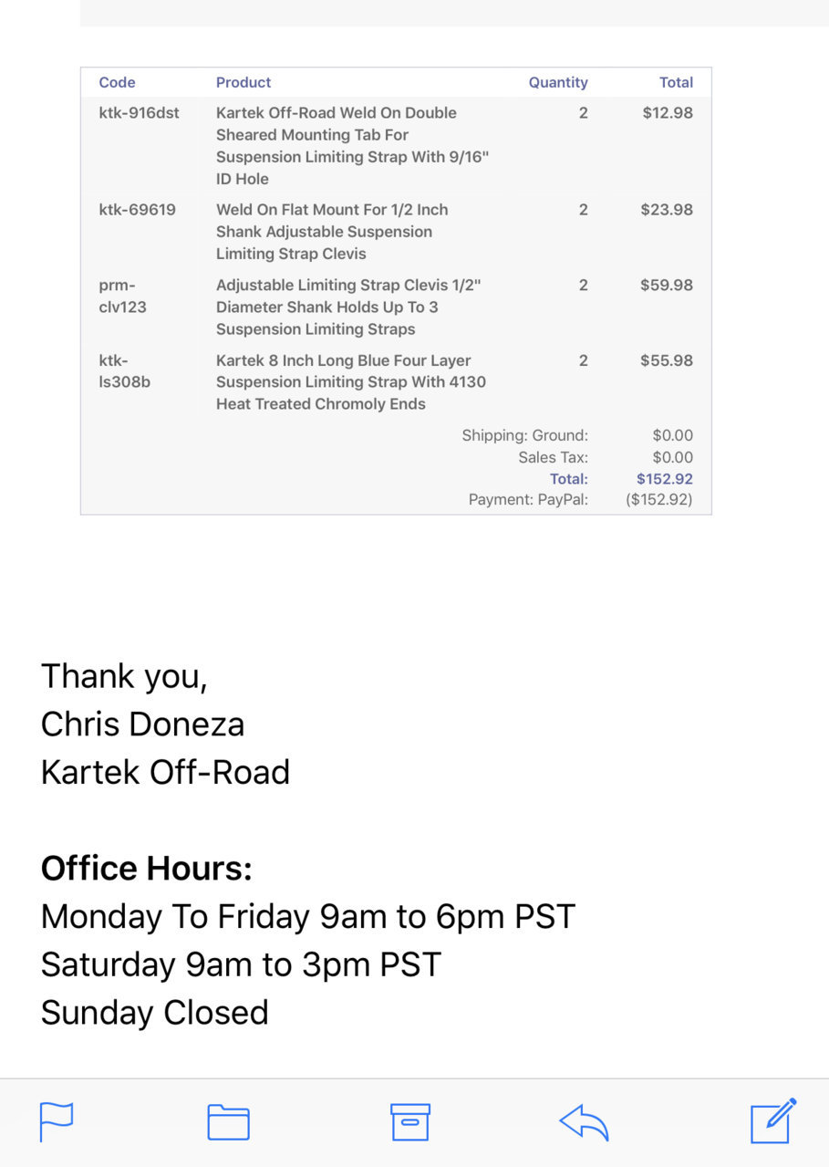

    Interesting, the ones you ordered were the old part number for the silver Clevis they no longer carry.
    As much as I love the black clevis bling this price is much better. Single I guess?

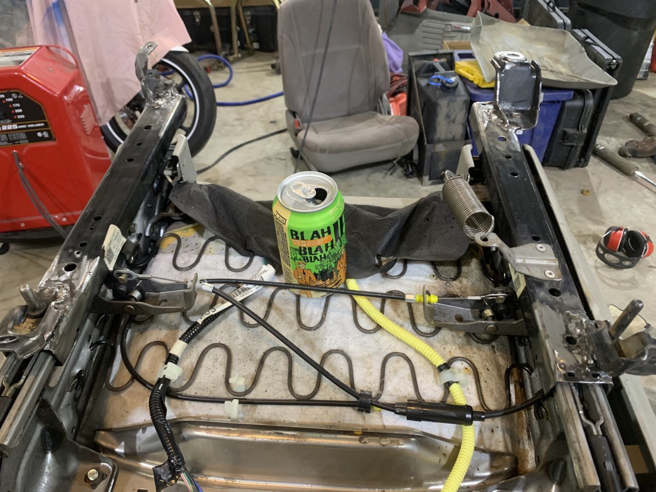

    Finished the passenger seat tonight. Test fit it and it’s money! I’m so stoked.
    Stick was hard. Really hard. The welds look like ass and I definitely blew a hole through one of the mounts but I was able to semi fill it with low amp 6011 rods and some tack/fill techniques. Have I mentioned how much I miss MIG? This is the sadomasochism of the welding world. BUT I was able to weld almost every leg all the way around and I definitely think it will be beefy enough. I started with 6013 in the hopes of pretty welds but I ended up finishing a large part of it with 6011 for the ability to fill the awkward gaps the mounts naturally have. The 6013 just traps way too much slag when there are huge gaps, or I just am bad at using them in those situations. Regardless I’m stoked on completing my first super thin metal project using stick.

    Single.
    The other is for mounting multiple straps on one clevis.

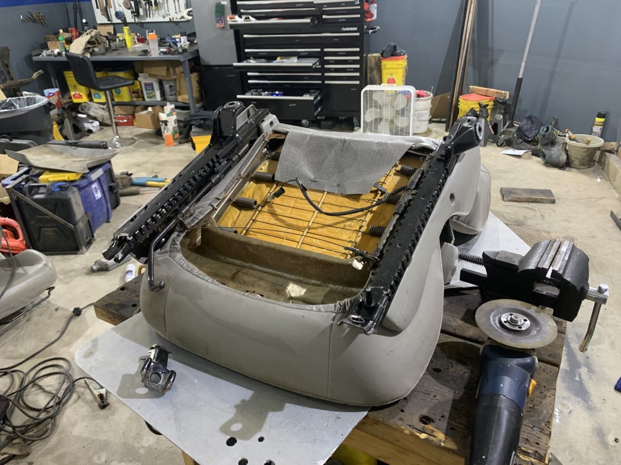

    Finished the drivers seat last night and got the passenger seat in the other day:
    [​IMG]Untitled by Michael Halat, on Flickr
    I had a very difficult time tacking this seat in the cab compared to the passenger side. I ended up tacking the first two front legs and felt like I was tilted towards the drivers mirror so I retacked it. In the process of my tacking issues I unfortunately burnt my vinyl floor and had no idea. Poor wet towel placement on my part.
    Thankfully it's under the seat.
    This showed the inherent issues with the original setup:
    My stick welds went much better this time around. Used mostly 6013 this go around and learned to control the slag better.
