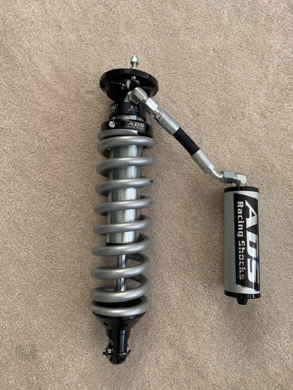

    Funny you should ask. I literally just had these come in today.
    In the beginning I thought going through ADS was my best course of action. I was sold on the idea of getting the top out protection that they introduced in all the 2nd/3rd gen shocks and I would be one of the first first gens to have it. I did later learn I would lose 1/2” of travel at the wheel to do so, but I still felt it was the best route to go since they said a strapped setup would make me lose more travel. The problem was with KOH, something happening to Tyler personally, and miscommunication it took 2 months to get my shocks. When I got the shocks in, I saw they had 700lb springs on it. This of course worried the shit out of me because almost no first gen’s run 700’s. I call Tyler to ask if this was in error and he said no he did it on purpose. He said that based on what I told him on how I use my truck (I want to drive extremely aggressively when I can off-road) and with my weight (5k unloaded) that he felt the 700’s would work better for me rather than overly preloading 650’s. He said if they feel too stiff to back the preload off and I should be good. I am still obviously skeptical but he’s the shock guy so he should know better.
    So in the end the custom work done is:
    Aggressively valved (we’ll see)
    Different hose/resi configuration based on measurements/fitment I did to clear 35’s
    Top out protection
    The thing is I won’t know till I get them on and really beat on them. I told him I did not care as much as on road softness, I just don’t want a shock that will fail me off-road.
    But after all this, I find myself wishing I went to @TMFF because he knows first gens in and out and was giving me advice every step of the way. I know when it comes time for rebuilds, I’ll be going to Tim for the rebuilds 100% and wish I got the shocks valved through him in the first place if you want something custom.

    Wow, that has already been an adventure and they aren't even mounted yet.
    It is nteresting that Tyler recommends 700s. I run those on my Kings now but I am very heavy. And I always get a ration of crap from all the guys about having 700 lb coils on my firsty.
    Speaking of extended lengths... What do those measure from the top of the top hat to the ~center of the lower shock mount?
    I will look forward to hearing the tale of what your impressions are, both immediate and longer term.

    compressed/extended lengths of the ADS?
  20. Feb 21, 2020 at 6:52 PM
    #1740
    cynicalrider
    cynicalrider [OP] #NFG
    Jul 25, 2012
    #83399
    17,116
    Jersey
    01 SR5 TRD 4x4, '23 Bronco Wildtrak, 2017 HSQV FE350
    Drop bracket lift and booger welds
    top of the top hat to the center of the lower shock mount is 19 3/4”.
    this is something I don’t have exact numbers for. I’d be interested if someone does.
    Also in case I haven’t posted it in here before, these are the measurements I got with my uca setup (icons with delta joints) with stock lca’s.
    Driver: 19 7/8" before CV boot rubs, and 20 1/4" before the CV binds.
    Passenger: 20 1/2" before CV boot rubs, and 20 3/8" before the CV binds.
    I thought it was interesting that the drivers side binds/rubs faster than my passenger side. I assume this might be my alignment setup? Not sure.
