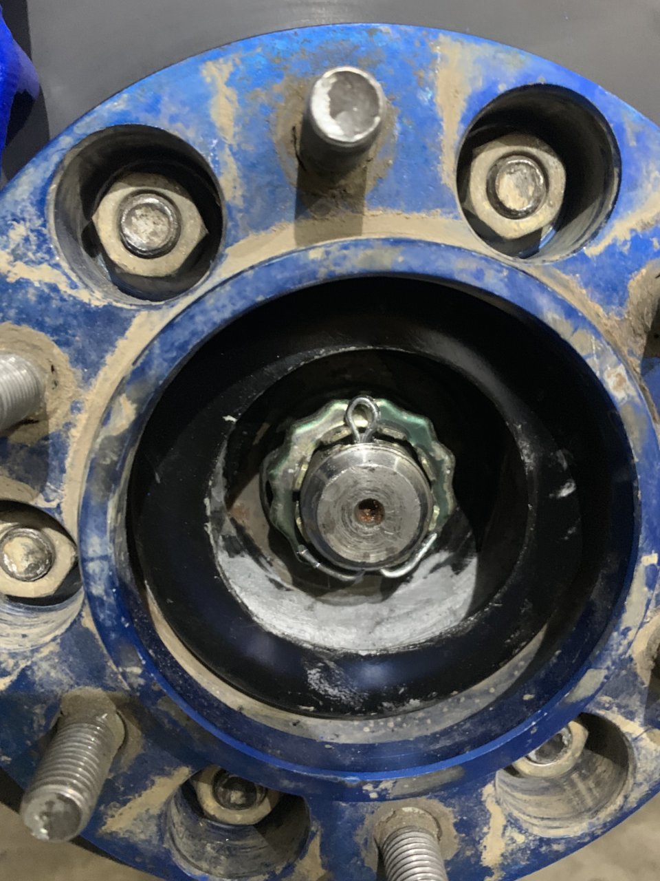

    I would toss a cotter pin on that CV spindle. That $.05 worth of metal could save you from from going end over end down the highway if the nut backs off.

    it’s got the full cage thing over the axle nut and cotter lol that was just when I was inspecting it.
    Looks lika dis.
