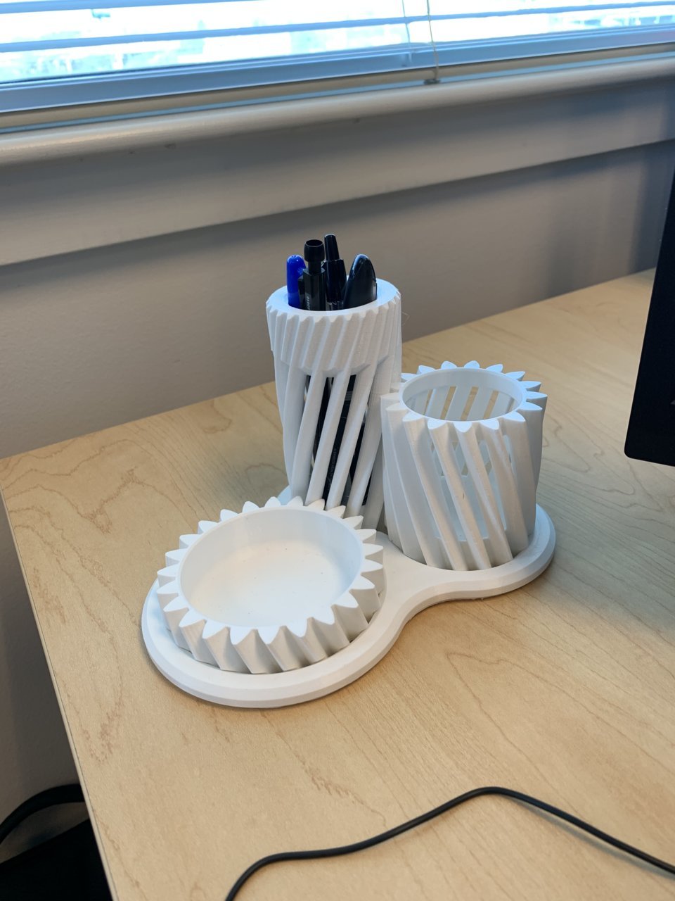

    I had one I used at work that I really enjoyed playing with.
    A4296DA0-4E89-4DBF-9767-CB14B54E247C.jpg These gears actually could turn. I’d love to get one to play with for dumb stuff.

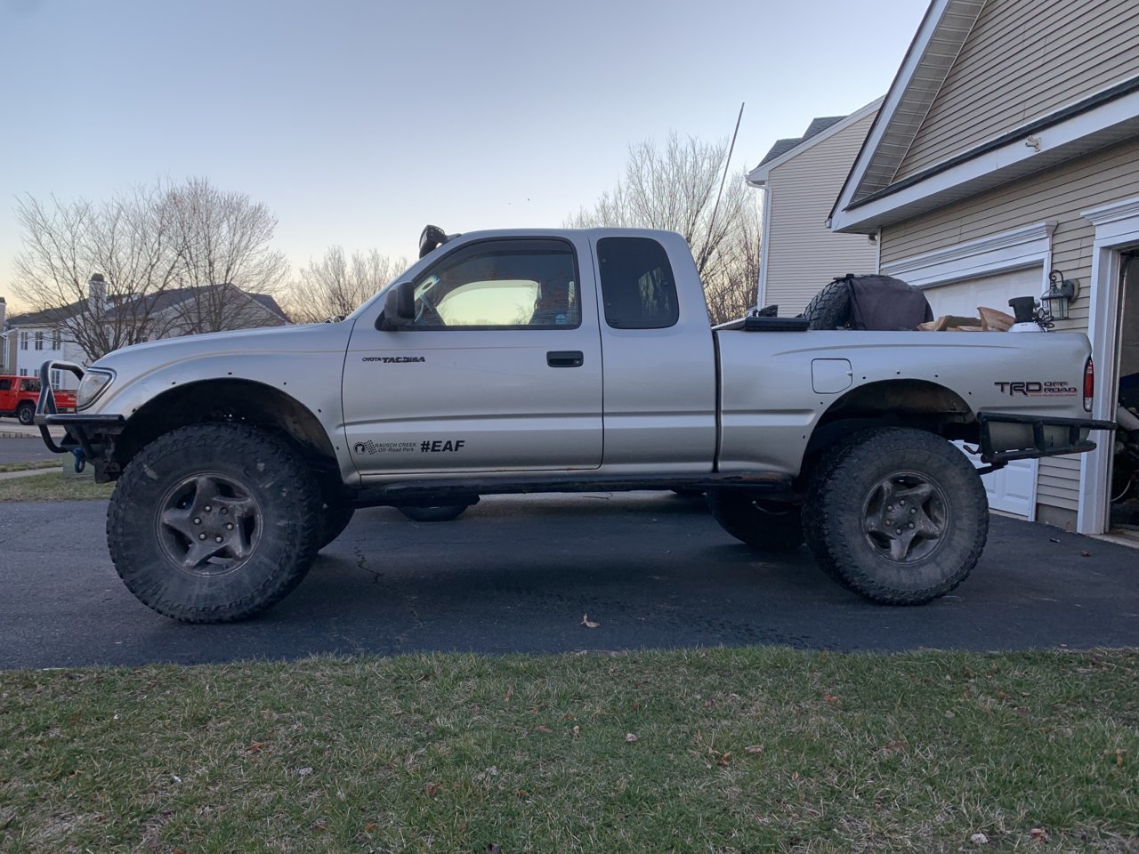

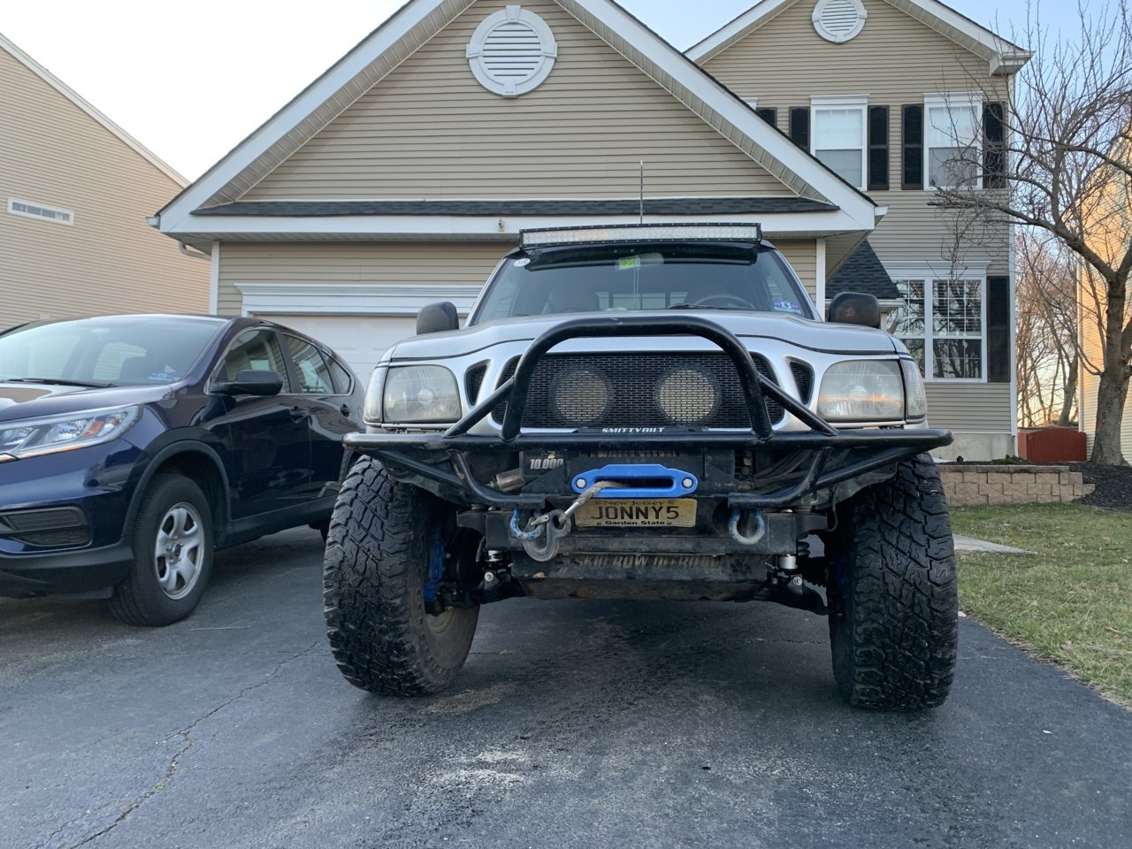

    Got some pics of the truck on all 4’s.
    Was afraid the 700’s would have if lifted sky high but def not the case.
