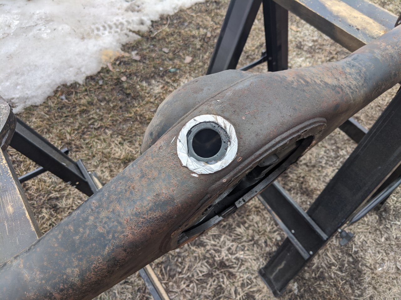

    Did you pull the third to do it? I'm feeling lazy. Might just double nut the two studs to pull them, replace with bolts, pull the drain plug and weld it up, and refill it... :notsure:
    @slander You said you used regular bolts right? I rather those than allens.
  15. Apr 1, 2020 at 8:48 AM
    #1795
    slander
    slander Honorary Crawl Boi
    May 10, 2013
    #103909
    8,964
    Hickory, NC
    02 Tacoma, fixed with curse words.
    Yea I used 2 regular 14mm bolts i had laying around replaceing the bottom 2 studs, you know the size that's holding like 90% of the truck together LOL!! Those are now my drain "plugs". I personally dont like Allen heads either. If you have to you can also screw in a bolt from the backside as a stud if some of yours pull out and you cant find any studs.
    I would keep as many studs in there as you can as that would suck royal ass to try to get the 3rd back in without them.
