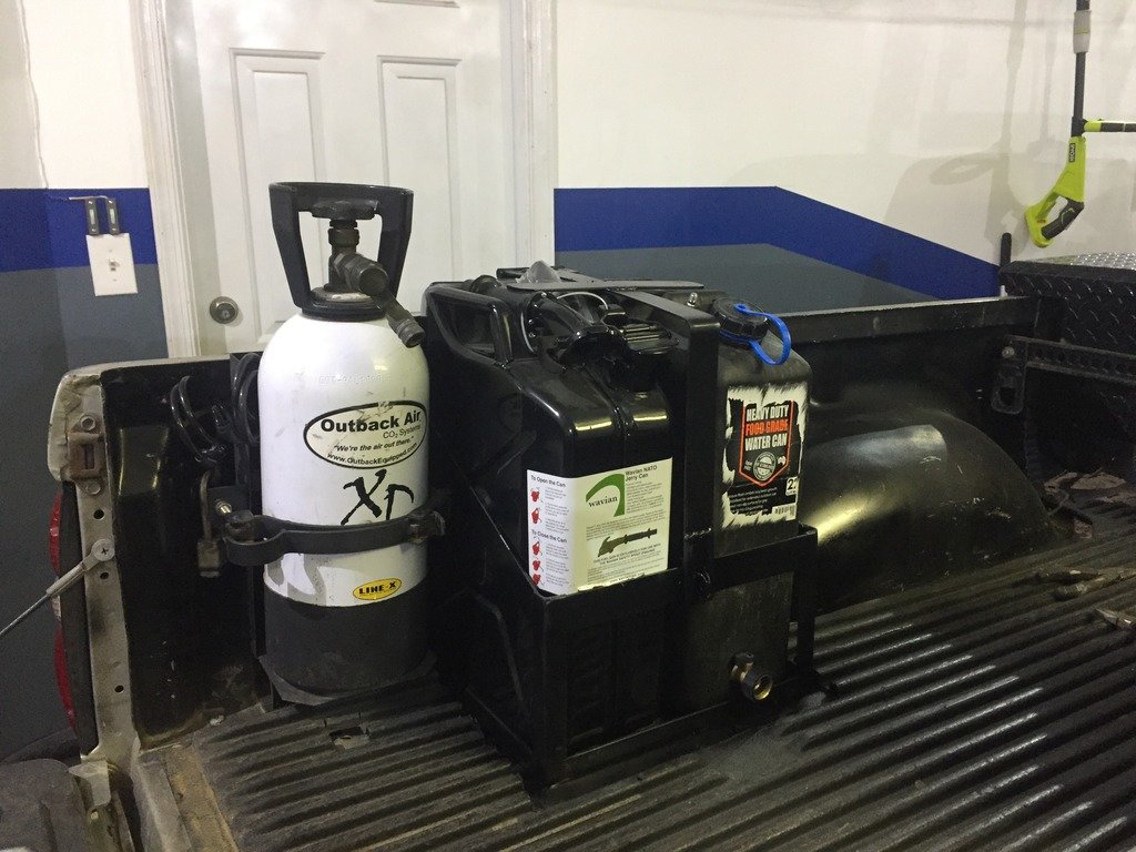

    Well finally finished both of these projects. This is how the new water carrier/CO2 mount sits in the bed now:
    [​IMG]Untitled by Michael Halat, on Flickr
    Much more compact and streamlined than before:
