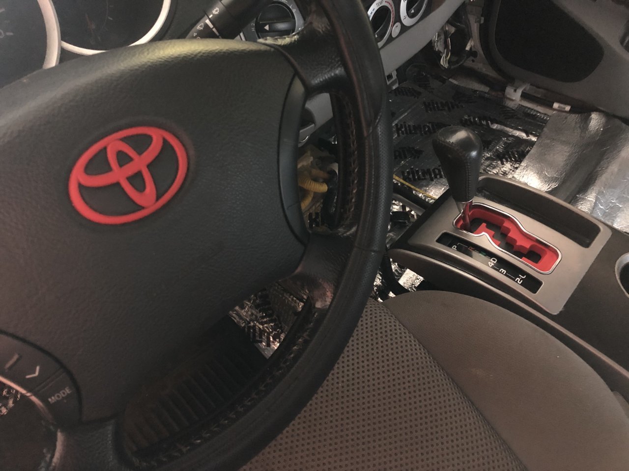

    since the thread just got revised (lol)... since I’m doing all my sound-deadening right now and my interior is all a part... I decided (yes my ADD and OCD kicked in laying hours of Kilmat) to match my lower Shifter Tray with my custom Steering Wheel paint job. So when I install the upper cover you’ll just see a hint of red behind the cover (and it ties in the steering wheel too)
    silly, but why not and it’s gonna look cool ,, good for at least 7 BHP too

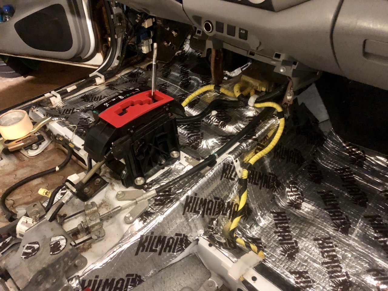

    Cowboy - absolutely do the sound-deadening (I know we’re off the thread, sorry). But yes, a must do!!!
    I’d say the best way to quickly summarize/describe the benefits of adding sound-deadening is: my Taco went from a sounding like a tinny noisy truck to a calm peaceful German sedan over night. It’s crazy quiet in there.
    The “Funniest” part of me deciding to sound-deaden my floors/cab all started with me simply wanting to install a vinyl flooring kit to replace our carpets (beach guy; lots of sand & dirt), which like so many of our Taco mods, leads down that deep never ending rabbit hole.
    Even my pretty much stock stereo sounds like added high end speakers and an amp.
    Doors are a must as well. It’s crazy how much road noise comes through the doors and floor. And “NO”, our Taco floors are not thick at all: maybe an 1/8 of an inch (other than stress and mounting areas). So much road and mechanical drive line noise comes right through the floor. I honestly had no idea how much noise creeps in and overwhelms our interior until I sound proofed.
    Note: I’m also adding thermal wood flooring foam on top of the Kilmat, then the regular wool pad. So it’s gonna be extra quite and comfortable.
    did I mention it actually helps keep the heat out, and the AC in?
    for a double endorsement: I just ordered more KILMAT to do the ceiling as well.

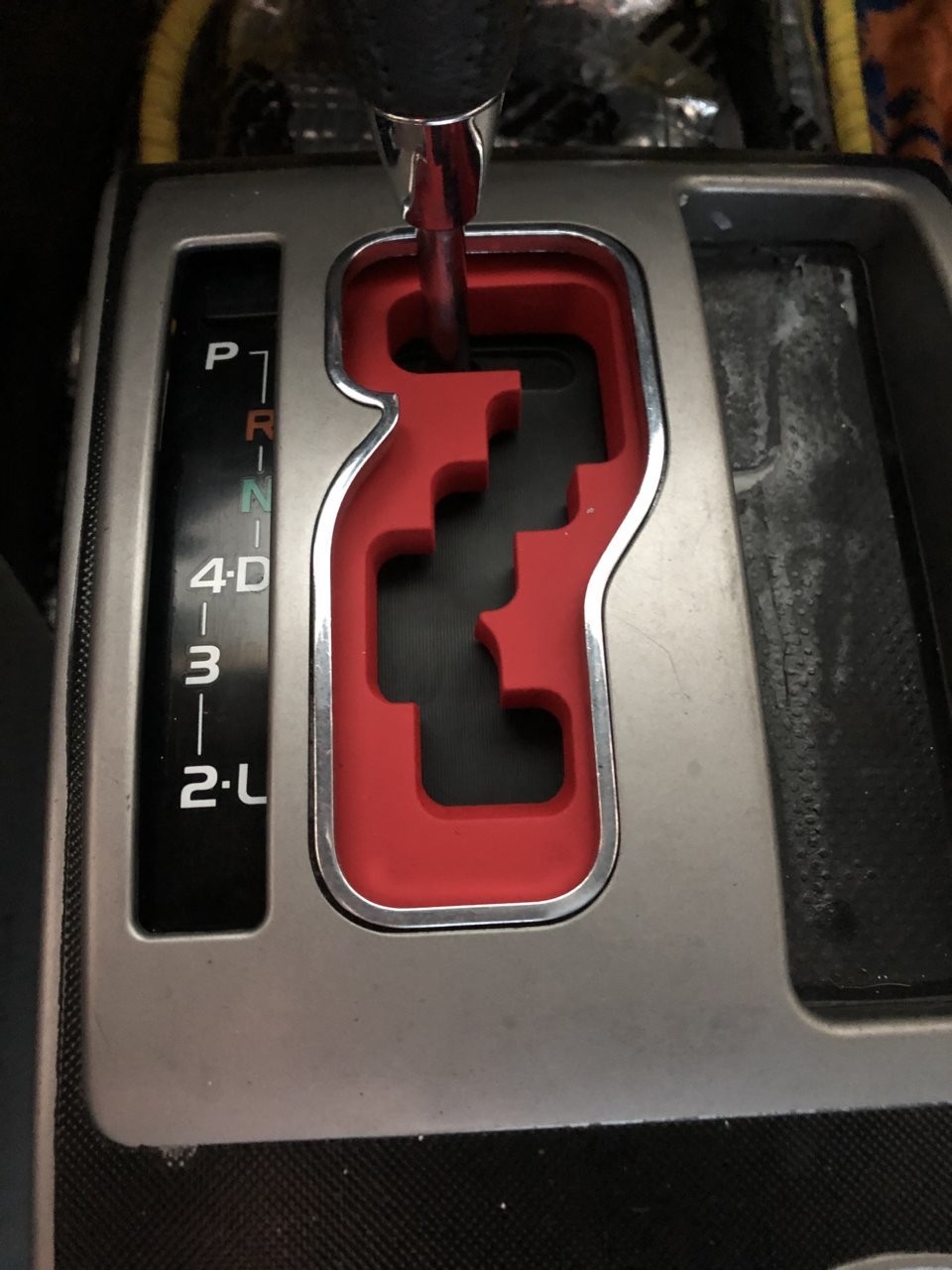

    Back to the steering wheel and shifter. Before I painted the plate, I double checked moving the shifter through all the gears, fast and slow; the shifter never hits the sides, so I’d say it’s gonna hold up quite well. The only wear would come from them cleaning days.
    But again, I think it really ties in the custom steering wheel emblem; giving her a “special edition” factory look.

    Cowboy , I’m loving the peace n quite so much (it’s almost like I’m in a Vacuum chamber),, Rabbit Hole continues for sure:
    Ceiling is next; just waiting on my Amazon order to show up.
    side note for if and when ya do the floor: once I was happy with every inch covered with my KILMAT, I went with good old construction wood flooring padding (sound & thermal foil) from Home Depot. Grabbed a big can of 3m and basically cut and glued it over the KILMAT. Ended up doing 2 layers. It’s a lot cheaper $$ than let’s say official car padding.
    Gives a nice cushion under my Wool padding (wanted extra padding mostly do to I’m switching out my Taco carpet to a vinyl flooring Kit).. and I like the idea of knowing I have that much more sound-deadening under me after all the hard work of removing everything to do the floors with sound-deadening.
    shoots

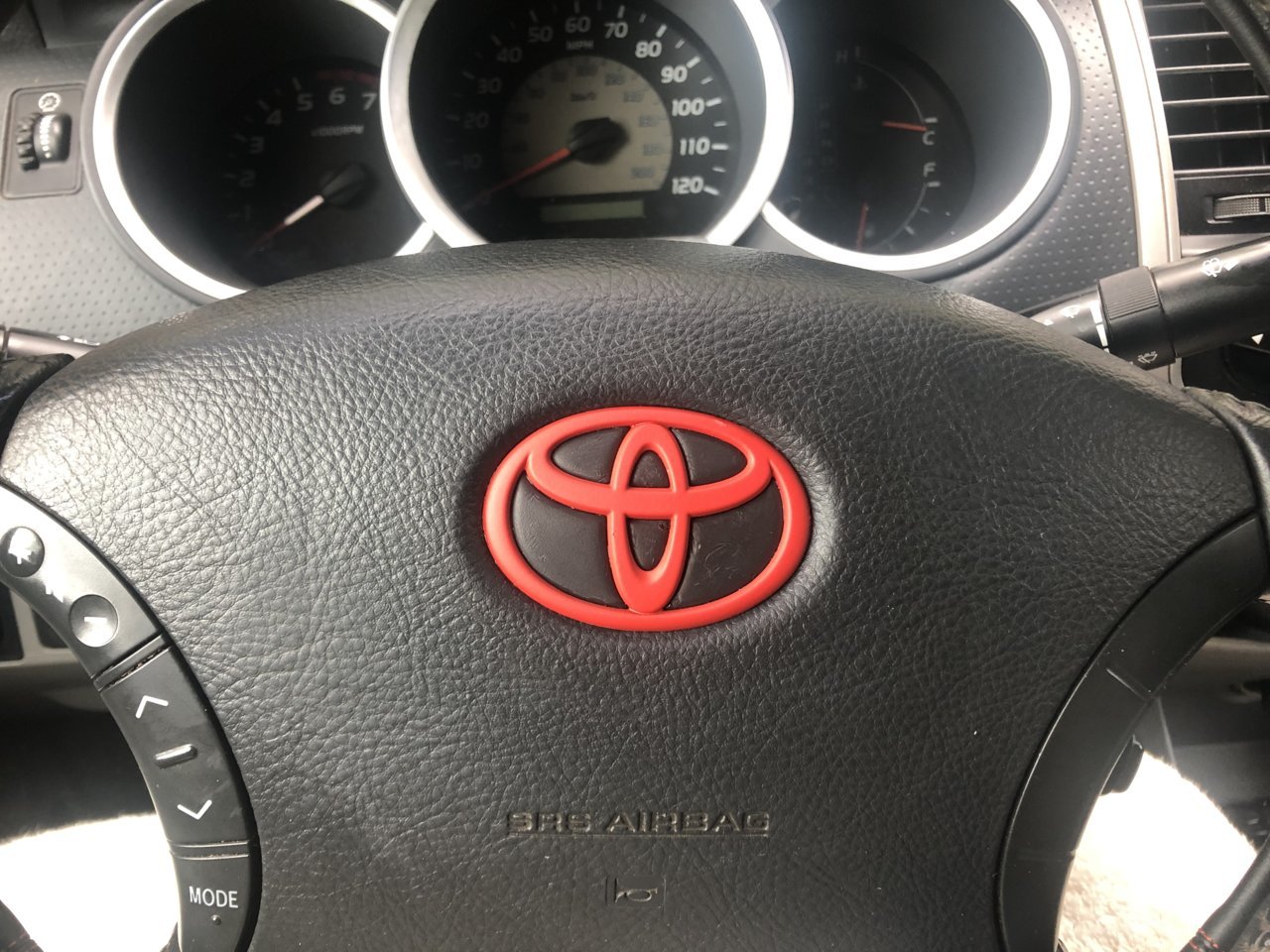

    Steering wheel repaint is complete and loving for a few months now.

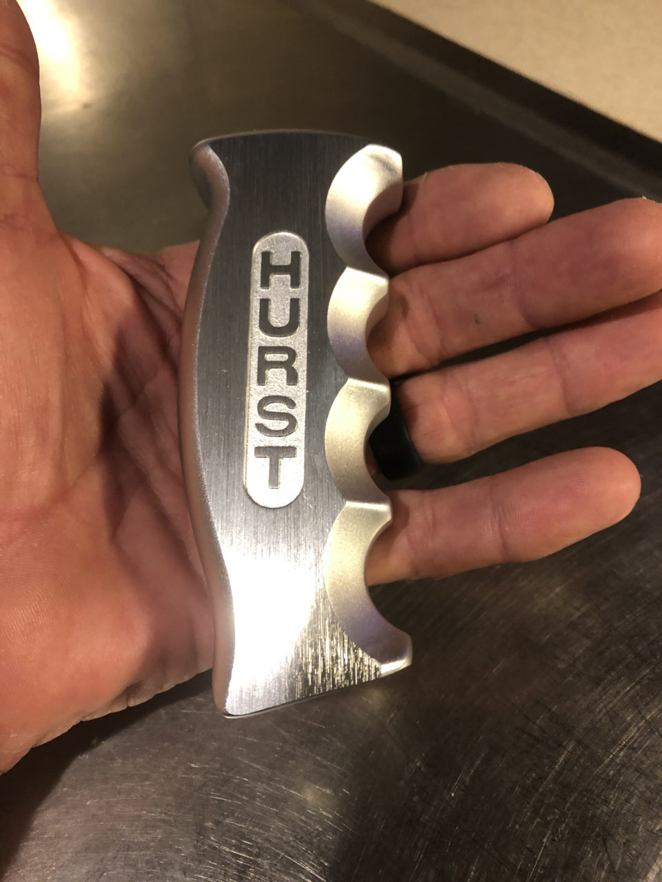

    Random- but this came in the mail,, she’s gonna be faster now

    Looks like you've created a projectile should the airbag deploy. There's a reason there are so many points of attachment for the logo.

    I think that's a shift knob....
