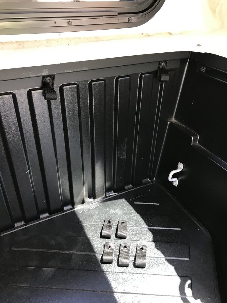

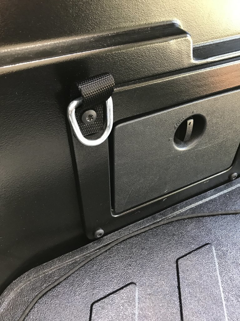

    So I have seen a lot of guys install d-rings on the bed of their trucks, and wanted to do the same. Unfortunately after a days worth or running around looking for those particular d ring style, I had the bright idea of doing what the pics show. Tools needed:
    Torch, razor blade, pliers and a big nail or bolt of appropriate size. Materials needed: strap and maybe plain d rings.
    Grab razor w pliers and heat it up, then cut the strap just by applying pressure, this will seal the ends then fold in half, heat your nail/bolt up and make a hole. Let cool and install underneath your preferred bolt. Washer use is up to you, I am testing them w/out.IMG_4515.jpgIMG_4513.jpgIMG_4512.jpg

    Not a bad idea, but i would have used thicker/heavier strapping for this.

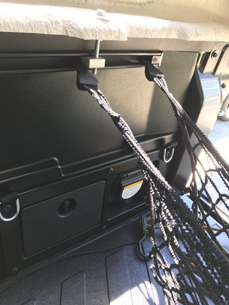

    I don't disagree with you guys but like I said I'll be testing them this week as I'll be driving cross country with a bed full boxes and I'll use those for my anchor points. Will see!

    Should be fine for cargo nets and items that dont need to be excessively ratcheted down. I will probably do something similar to your idea but using seatbelt or something of the like from the local pick n pull yard. Also a quick stitch on the ends would help for strength with a washer on the bolt.

    I used 1" nylon webbing for quick tie down points too. Folded both ends to make the ends four layers thick instead of two, punched a hole, and installed a brass grommet. Then used male threaded knobs to attach them to t-slot nuts in the rails. Should stand up to as much strain as the rails tolerate.
