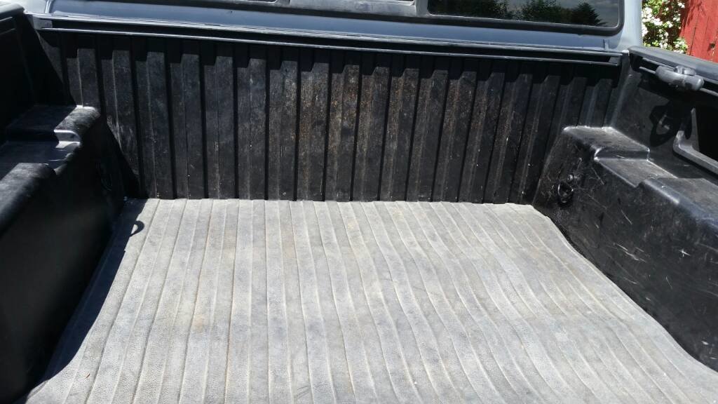

    I've been trying all night to get the bed bolts out with no luck. I've tried multiple impact guns and a breaker bar. I am using a T-55 torx bit. Ive tried spraying wd-40 on the bolt but i feel like it's not doing much since thats not where the threads are for the bolt. Any help would be awesome. It's an 07 DCSB if that helps.

    Look under the bed, the threads are exposed. Spray penetrating oil under there. I recommend the 25" breaker bar at harbor freight. Works great for me. Good luck!

    You just want to install tie downs right?
    I just drilled holes in my bed and then mounted them with backing plates. Simpler than removing bolts that don't want to come off.

    I'd use liquid wrench for penetrating oil. When I installed 2 more d-rings up front I drilled 2 new holes in the corners kind of beside the drainage hole. Punched a spot, rough drilled, drilled until I got a perfect sized hole for the bolt, and installed the ring. You might need a second set of hands to keep the metal plate in place underneath. Oh yea and I used silicone on the metal plate to seal it against the frame better since it's so close to the drainage hole.

    I'm using a craftsman ratchet and a piece of steel pipe. I just sprayed wd-40 on the exposed threads under the bed and ill let it soak. if that doesnt work ill try a different penetrating oil.

    Yeah I got a bit discouraged. Ordered some off Amazon and they'll be here today. I'm just going to drill holes. Seems way easier now that the torx head on the bolt is pretty much fucked. I just need something up there to tie down a motorcycle I'm picking up next week.

    Decided to just follow the instructions.

    I just loosened mine up yesterday to move my bed a little and had the same problem. I used an impact gun and they came right out.

    Looks good! :thumbsup:

    Did you put a backing plate on those?

    Yeah they can with a backing plate.
