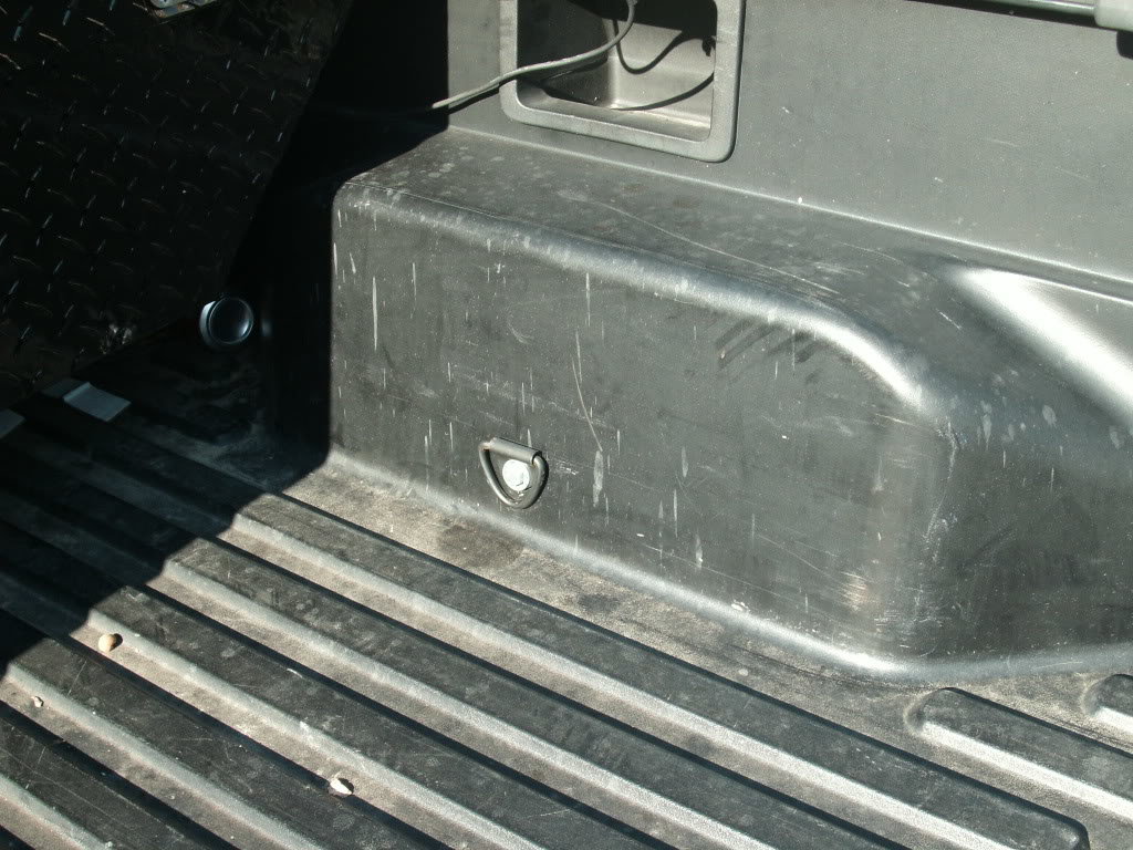

    This is a pretty simple mod. I bought the surplus D-rings, 5 for $10, and the are very strong. I made 3" square backing plates from 1/8" steel plates and drilled a whole through the center. Then sanded, primed, and painted them to prevent rust. I bought some grade 5 hardware from my local store, probably overkill, but that's what they sell. Make sure your backing plates will sit flat against the bed at the spot where you want your rings. Then drill a hole and assemble everything.
    This is the back side. It is above the rear tire, flat against the bedside.

    Well done! Nice pics too!
