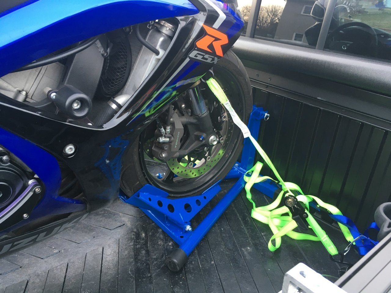

    installed these on my gen 2 10 years ago. Ideal for motorcycles or any other use. These were plated but stainless would be better.thumbnail_IMG_1177.jpg

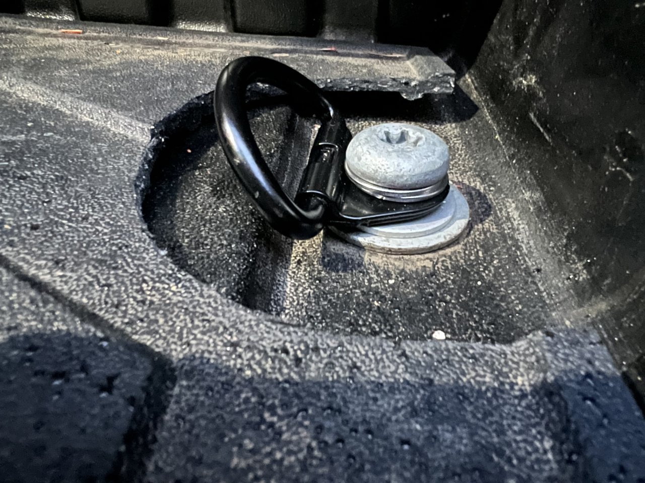

    I put them under the front bed bolts.
    The diameter of the head of the bed bolt is a little big and pinches the D-ring so it's hard to flip up and turn. Also, the D-ring sits a little low and hits the bed rib. Both are fixable with a few washers. Still need to clean the installation a little.
    Original bed bolt washers are don't come off the bed bolt. Hit the bolt crimps with a Dremel to get the washer off and some primer.

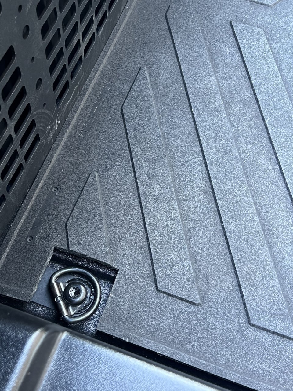

    @Spacecoast Just add the D-ring under the bed bolt I used sprinter D-rings they are a little bigger and widerBDA5F0DE-23AB-4EB3-9F67-761924BF1AFE.jpg
