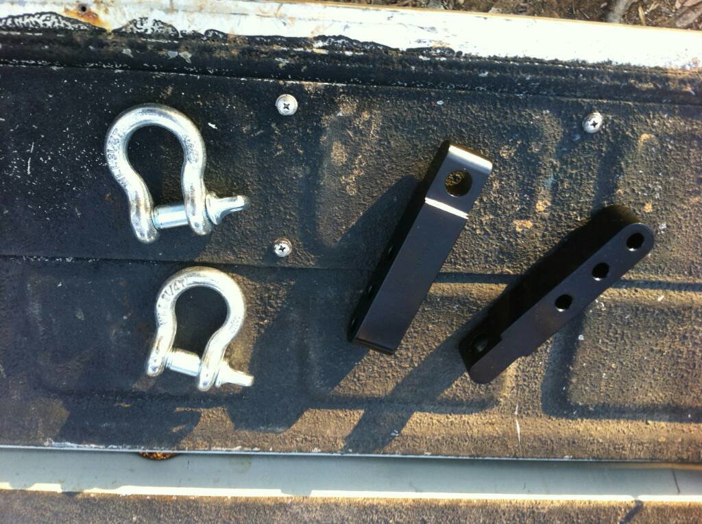

    That is not a safe recovery point. That is a tie down point shipping only. Rampage sells a set of 5/8 shackle mounts for a CJ/YJ/TJ that have the same bolt spacing as the factory tie down and tow hook mount. Just have to get metric bolts to go with it.

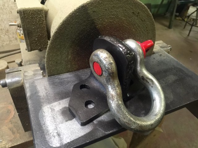

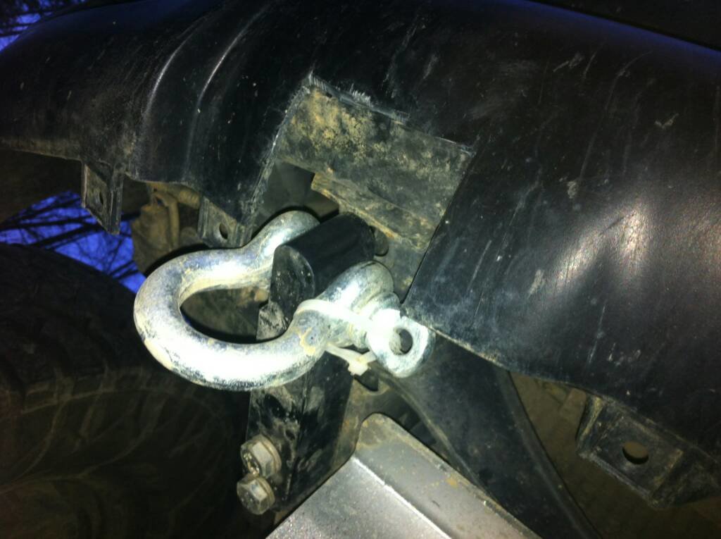

    This is on first gen but you should get the idea. Looks like you will not have to trim from the pics in this thread.

    Apparently this part from Rampage is discontinued. :/

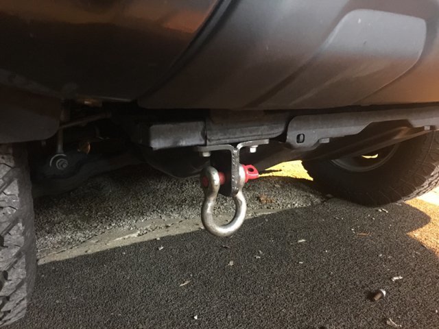

    I welded up a stouter version for the front of my '14

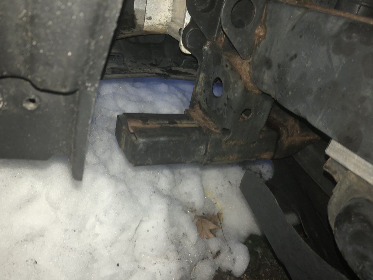

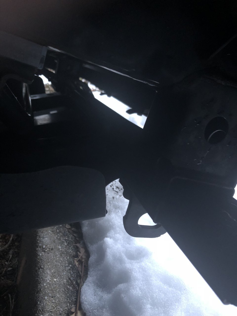

    Id Love to Put 2 Nice Large shackles on Driver and Passenger Side Similar to the above Photos. Whats the Easiest Way to do it. Does someone have a Link for brackets for both Sides?? Much Appreciated. Photos are of passenger side then Drivers side497BE557-2EDE-49A2-9F92-B7EA2FD990BB.jpg525BBFD3-A0C9-4ACE-BC8F-08F6419DD9AB.jpg
