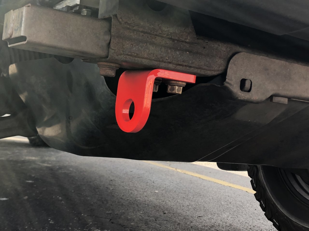

    Question. Is It easy to Remove those Screws w a Socket Wrench for that Tie down area?? Iam adding a bracket today. Also will loosening/ replacing the screws possibly weaken integrity of the Front End ? Thanks. This is the Bracket iam using EC430459-AB83-44A2-9113-1B59231BCB22.jpg

    I took them off with a ratchet (1/2" ratchet). They are snug, but no big deal. Put them back in very snug, torque them if you can find the spec, and you won't have any issues.

    Thanks much appreciated

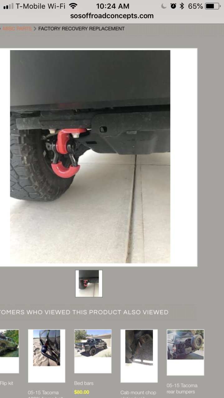

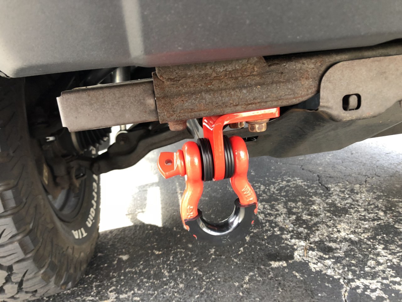

    31824B62-4613-49E7-8B24-BF403D710198.jpg B4040181-8AC6-4434-9265-A040F2B131D2.jpg Thanks for All The Tips . Well here it is.E01CB4D5-D219-41B7-B614-A3843D7DAD2E.jpg

    I like this!....I Like This A Lot. So this is the Bulletproof Fab Correct?
  7. May 14, 2019 at 8:06 AM
    #47
    Wippa411
    Wippa411 Member
    Feb 26, 2019
    #284595
    22
    2013 Blue Tacoma SR5
    3” Toytec Lift
    Sosconcepts website . Love it

    The only thing I wonder if those bolts are rated like that plate is. Plate will definitely hold, would like that plate to utilize the bolt on the other side too though.

    Can't remember what size those are, but shear strength of a grade 8 9/16" bolt is about 27000lbs if I remember right. Should outlast the plate or frame.
