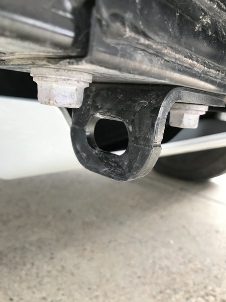

    IMG_1910.jpg Bracket on passenger side is meant for a recovery point, I just ordered a d-ring shackle to mount to it.

    No, that's not a recovery point. That's a tie down point for transport.
    The TRD hook is alright, although I don't know what it's rated for.

    I have the Bulletproof point and am curious what you think is deficient about it. They rate it for 8,250 lbf and I think that's realistic for a 1/2" A36 plate. It's better than the factory hook since it uses a shackle and adds a third bolt (3 x 12mm 10.9).
    I don't like that it uses the subframe, I wish Toyota would put plain old hooks at the ends of the frame rails like they used to. But it seems to me it's about as good as that spot can be.
    I would trust that point as much as any welded tab on a bumper, at least there's no workmanship or geometry to worry about. It's just a hunk of bent steel and some bolts. I'm not sure the 3rd bolt is really helping but at least it's insurance.

    So there is no factory recovery point on a 2016/17? Is your TRD hook not mounted to the same spot, just gen. 2? The loop on drivers side is a tie down, but I could be wrong?
