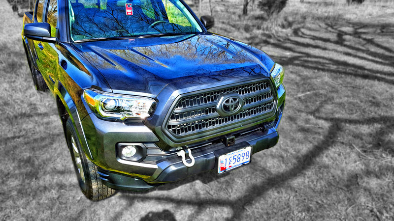

    The welded tie down point is on the drivers side. The loop shown above on sr5 and sport models, as well as the trd offroad hook on the passenger side are rated per the owners manual to tow for short distances on a flat surface.

    The welded hoop on the left/driver's side is a tie-down only.
    How thick is the right side bolted-on bracket? I've always understood this to be for transport but if the owner's manual says otherwise then I'm willing to admit I'm wrong. If Toyota is putting that on TRD Offroad models then it's presumably OK for light duty recovery.
    Old 79-95 trucks had a bracket just like that bolted to the driver's side and it was always said to be for tie-down and the cast hook (similar to the 2nd gen TRD OR hook) bolted to the right side was the recovery point. Everyone just replaced the stamped bracket with a stock hook and, boom, two recovery points.

    Just received this email from my local Toyota parts guy, also a 3rd gen Tacoma owner:
    The driver side is a recovery point, the passenger side is a transport hook (rail/car hauler)
    Both are used to transport, both can be used for recovery purpose, but driver side is stronger.
    hope that helps!

    I'm reading the manual and this is, to my surprise, correct. The sport model and sr5 loop on the pass side is indeed a tie down, whereas the welded loop is the tow point and the offroad hook is also a tow point . Pg 468 picture shows towing with welded loop, and towing with bridle welded loop and offroad hook
