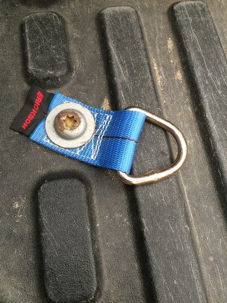

    I got a strap with two drings on it for 3 bucks. Melted a hole in it and used bed bolts to secure. image.jpg

    I'm not sure I'd trust that for holding down something like a motorcycle.

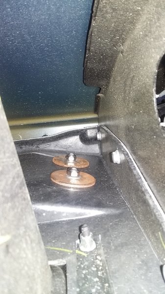

    Did you add a support plate or is there a direct mounting position for these?

    I centered them by measuring where I wanted to place the hooks then drilled the two holes. There is no set location. Then I just used a couple of washers that the 2 bolts would fit through, about 3/8" center hole, and were about 2" in diameter to spread the area where the stress would be. These work great as I've used them 100 more times than the other stock hooks.20160830_182352.jpg
