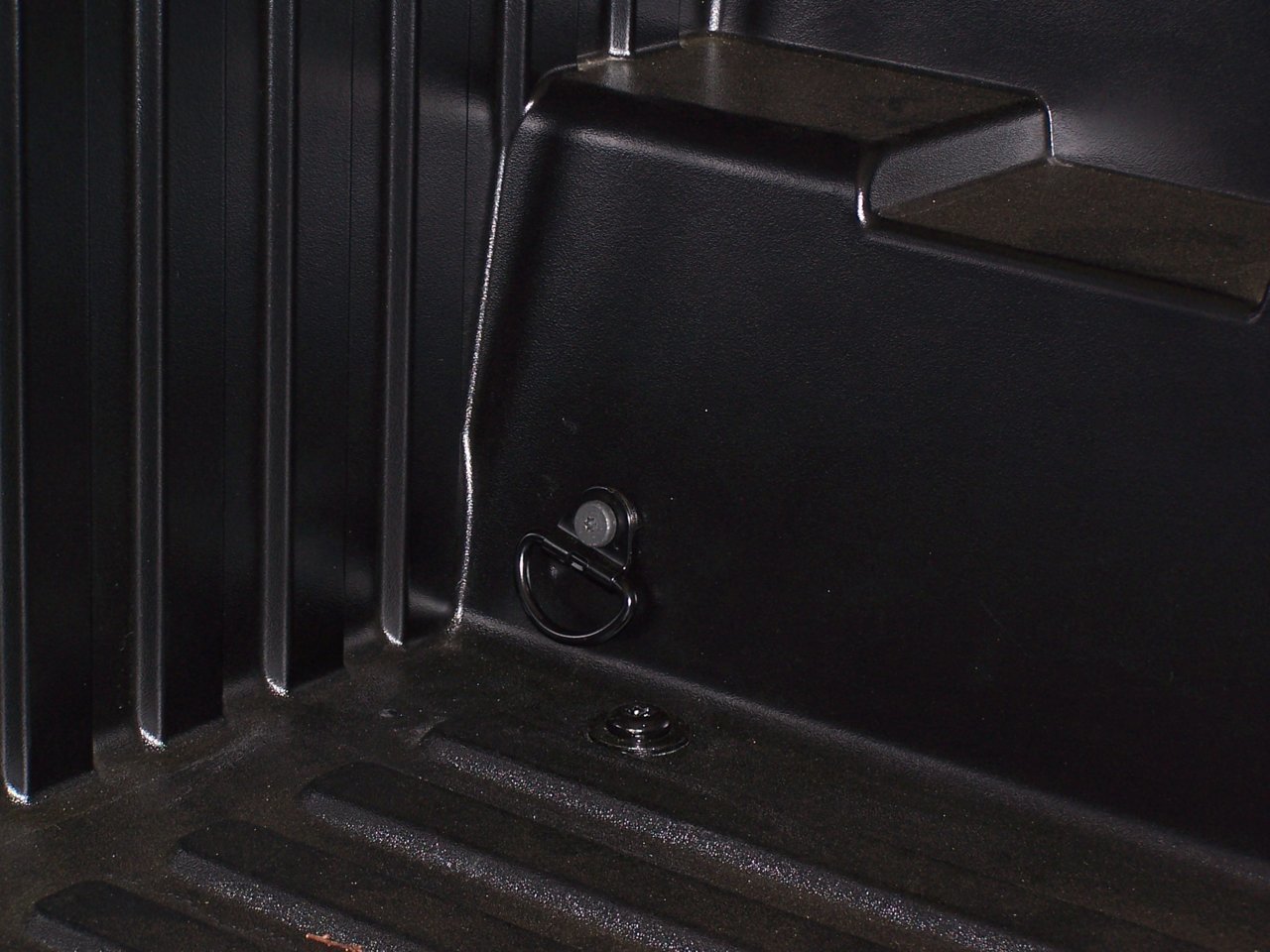

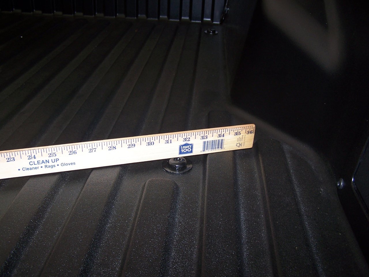

    Here is a photo of how the correct placement of the D-Rings are to be installed. Also be aware that the bed bolts are designed to be slightly recessed, so that sliding cargo into the bed doesn't get damaged or dinged by the bed bolt heads.
