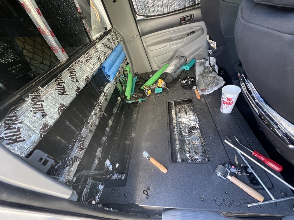

    So I drove the truck this week and decided the roof was maybe better (quieter) than I had given it credit, but the truck was still loud. Friday afternoon whilst doing something else in the truck and dropping a razor blade behind the seat delete, I realised I had not put good coverage on the floor under the 'seats'
    So last night and this morning I lashed out at those areas and put double layers all over the place - I think in some spots I had originally used a thin sound deadening - my advice would be to only use the MAX....and just put the stuff everywhere ~ oh well (yes I use pool noodles to fill some voids)IMG_6869.jpg

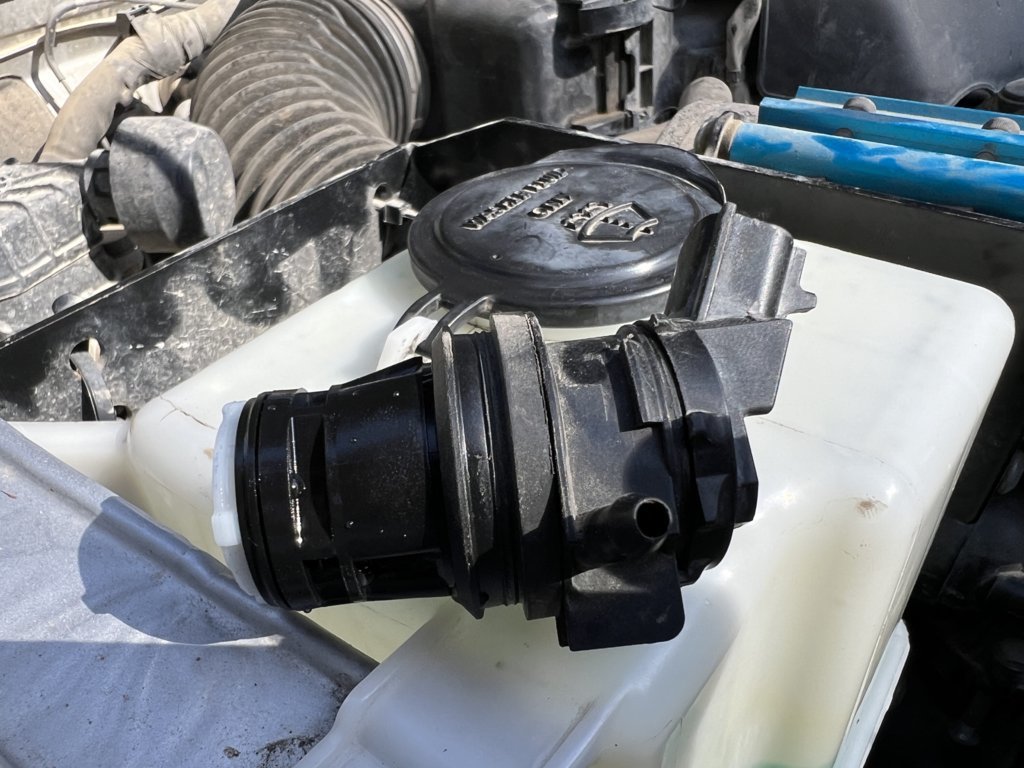

    Returned from a trip (to New Zealand) and found my washer fluid motor had given up, so removed the reservoir - which is rather hindered by my Slee air compressor mount - to find a bracket was broken on a electronic connector, strange but true, and the connector was just laying there - so had to go and pick up and a new 'motor' (as its such a pain to get into this area I may as well do it 'right' the first time, rather than glueing it and hoping for the best) - hot tip (picked up from a YouTube) remove the grommet from the motor and put it into the reservoir first, then slide the motor in.....

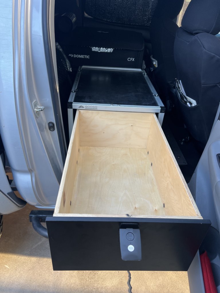

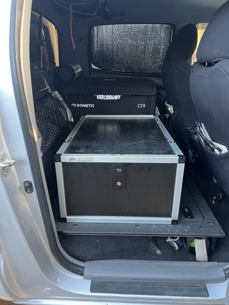

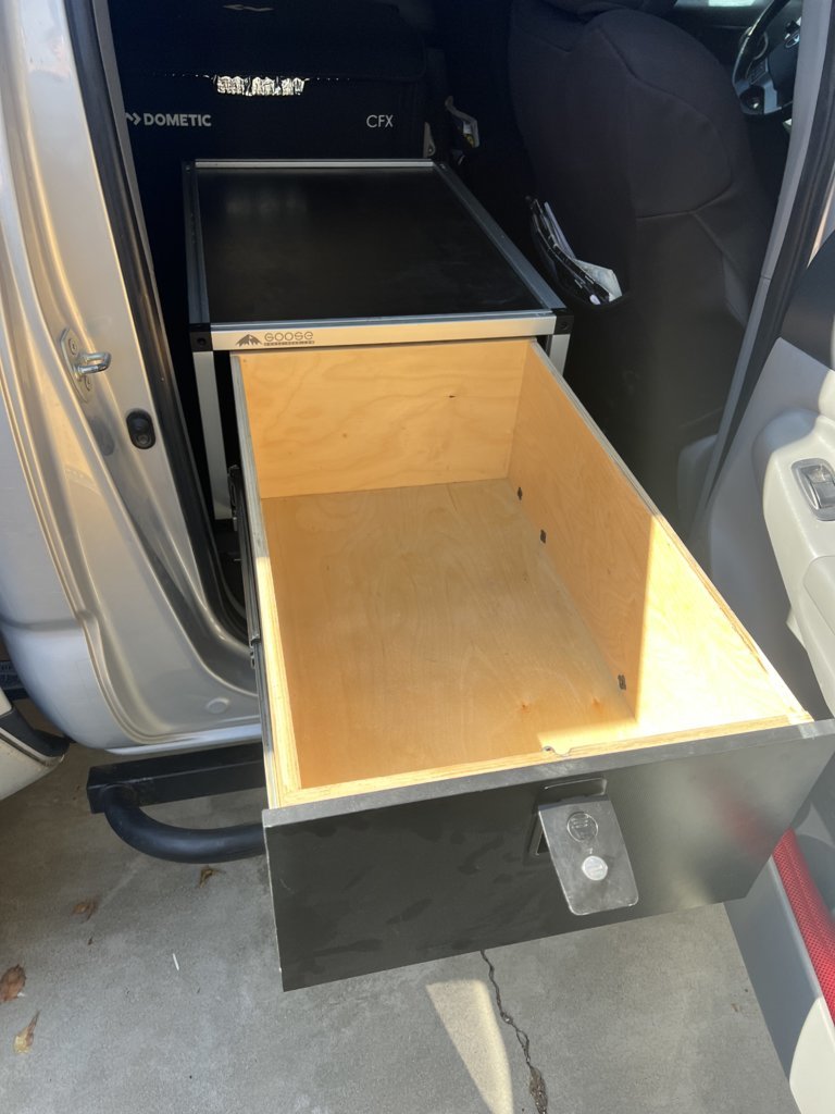

    Also found this Goose Gear drawer on FB Marketplace, been on there a while and it is 3 inches shorter than the 'Tacoma 60% delete drawer' - so decided to low ball the dude and - $300 and 20 mins later I had a drawer. Put some elbow grease into cleaning it up (drawer slides were sandy, and inside the drawer was a mess) but super stoked on this....
