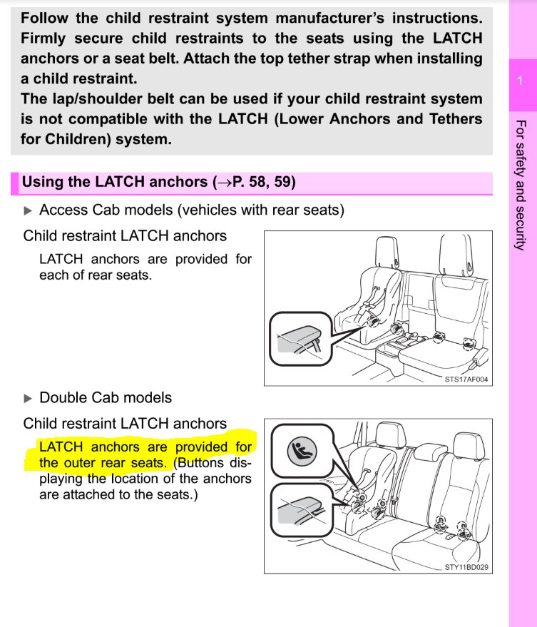

    ok so you guys had me worried and I spent my lunch hour go over the manual. So to your point, the manual states that latches are provided for the two outer seats. there is no mention for latches for the middle seat. that said, the manual does not state that you shouldn't use them for a middle seat. there are plenty of warnings, none involve this matter. soo....
    I am adamant about leaving the seat the middle for optimal safety. so I guess I should either a) just use seatbelts or b) continue using latches for outer seat...

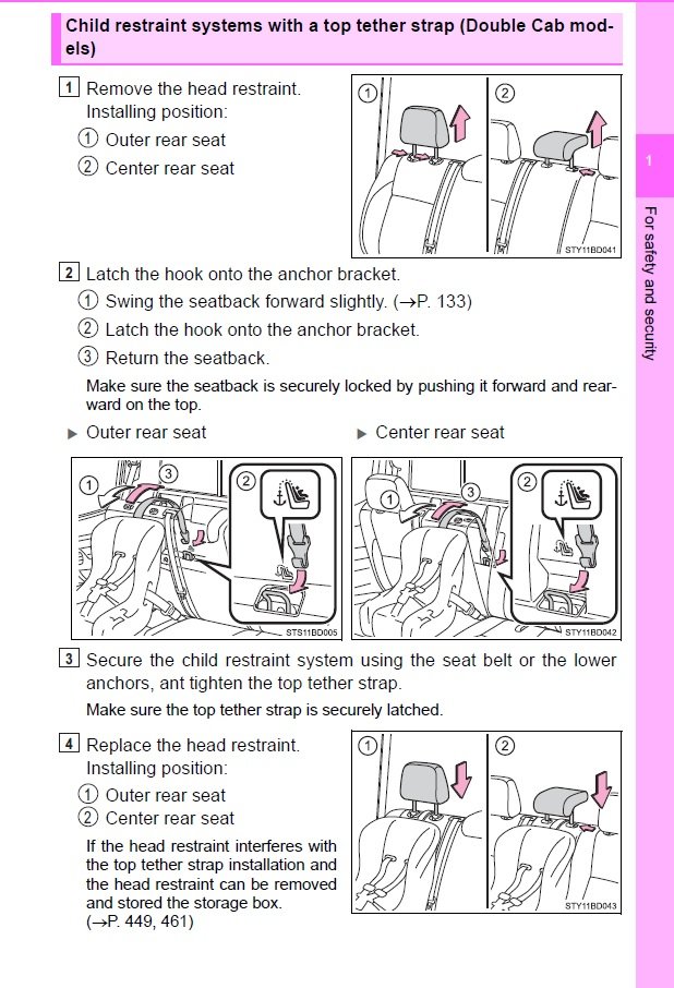

    Page 65 of the owner's manual shows a child restraint mounted to the center rear seat. BOOM!

    Can you post the page?

    CRACK! Further investigation shows the center seatbelt being used, not the latch system.

    It does say install with lower anchors or seat belt and doesn't specify that you can't use the lower anchor when install in the center.

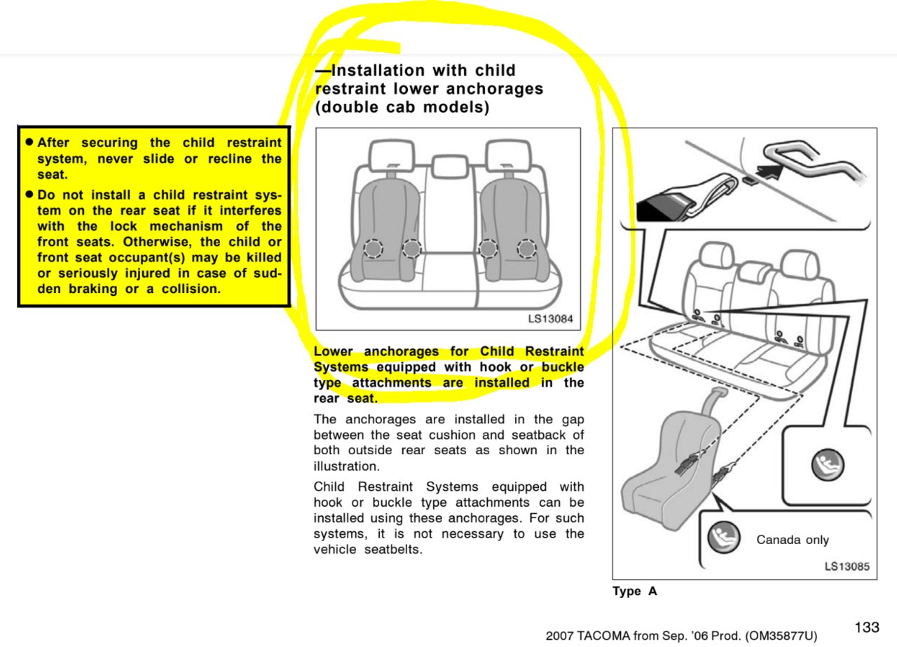

    Standard LATCH spacing is 11" (280mm)
    There is also such thing as non-standard LATCH spacing, but in order to use non-standard spacing in the center:
    -Car seat user manual needs to allow non-standard spacing to be used to install it. Some seats allow it, some don't.
    And
    -Car/truck user manual needs to allow center LATCH installation
    vuTron likes this.

    2007 OM
    Shows only outboard seat locations
    2016 OM says the same
