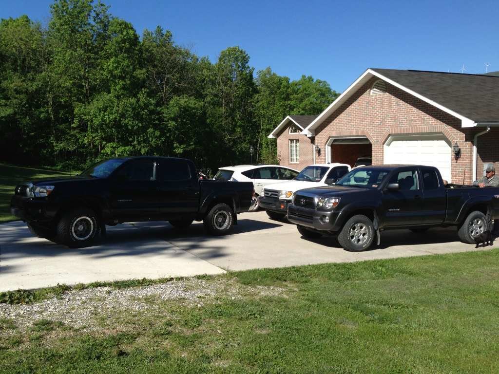

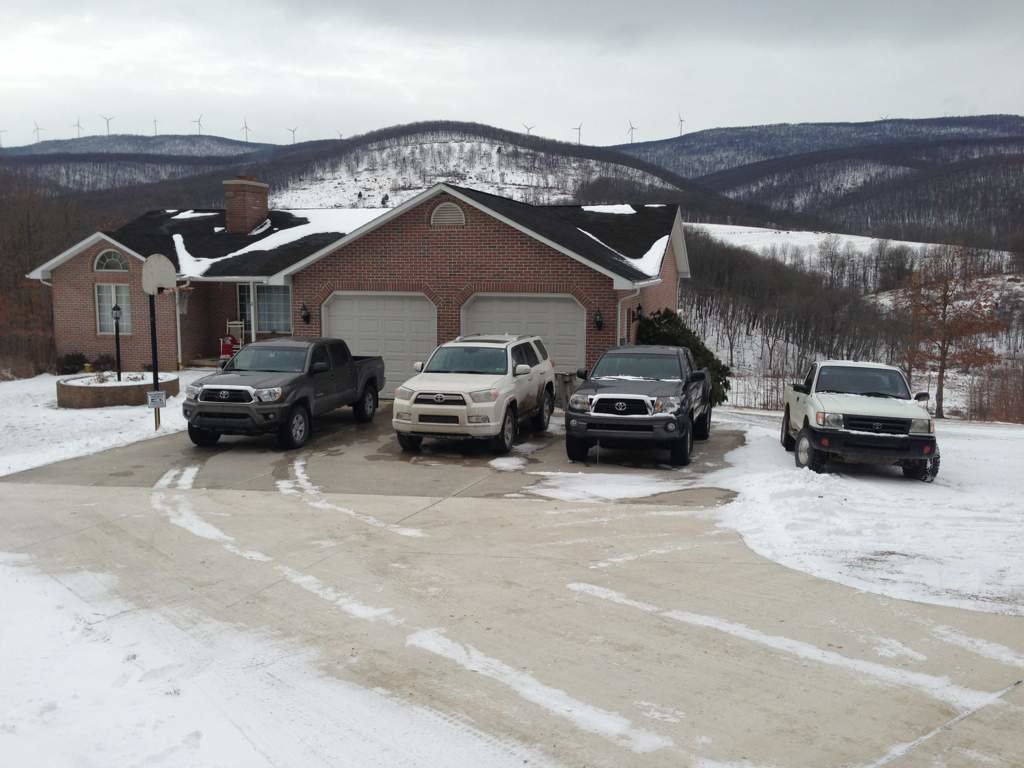

    Dad ended up buying a '11 V6, 4WD, AC, OR, 6MT Taco. He loves it. Oddly enough, a few weeks later, my father-in-law's 98 Tacoma SC, 4cyl, AT, 4WD was stolen out of his driveway, on a high speed chase, and eventually stranded and abandoned after blowing out 2 tires. My FIL wanted it gone after it was recovered, so my dad bought it for $750, spent $1500 in repairs and refreshing, and now has a great little beater truck.
    Then, in November, my younger brother bought a DC V6 5AT OR Tacoma.
    Then, last month, my uncle bought a DC 5AT Taco Baja.
    So, since spring of '11, we've added 4 Tacomas to my immediate family. The 4Runner and Prius v are mine. That Baja Tacoma is my pick of the bunch. I love the factory setup on that truck.
