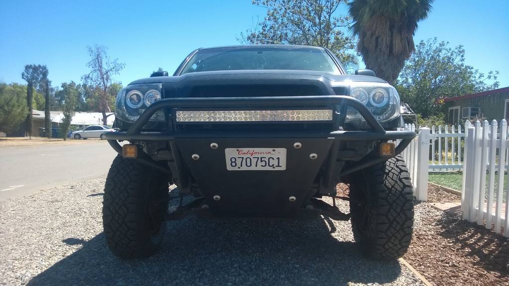

    Blacked out 05
    5100's front and back, OME 885x's, LR UCA's, OMD rear springs, Pioneer AVH-P2300DVD, HVAC Green led's MOD, Blacked out bumper, Plastidip emblems, custom front tube bumper, 32" combo led bar, rigid duallys, otrattw switches, my own Satoshi grille, shorty antenna, Spyder LED halo headlights. csjumper2003 map/dome, 3rd brake, DTRL white/amber and parking LED's. Pelfreybilt IFS skid, Cab mount chop, sliders and rear light bar w/blitzpro 5LR dust light. Uniden CB, Magnaflow 18" exhaust, Rear tire carrier, sway bar removed, spidertrax 1.25" spacers, Wheelers 16" Alloys w/265/75r16 Goodyear DuraTracs
    My blacked out project. Bought her March 12th 2011. Once I found tacoma world, it was all over.
    2005 AC sr5 Prerunner V6 4.0
    Current Mods:
    Suspension:
    Bilstein 5100's front and rear. Front set at 0"
    OME 885x's
    LR UCA's
    OMD rear springs
    Wheels and tires:
    Spidertrax 1.25" wheel spacers
    Wheelers wheels 16X8's
    Goodyear DuraTrac 265/75r16
    Exterior:
    Shorty antenna
    Pelfreybilt rear light bar
    Pelfreybilt IFS skid plate
    Pelfreybilt cab mount chop
    Pelfreybilt sliders
    My own Satoshi Grille
    Plastidipped emblems
    Painted rear bumper
    Bed tire carrier
    Custom made front 1 3/4" DOM .120 tube bumper (courtesy jeffz0rz)
    1/4" Aluminum front skid
    hi-lift mounted on rear light bar
    Bed mat
    Interior:
    Uniden pro520xl cb connected to 4' antenna
    Pioneer AVH p-2300DVD
    Leather arm rest mod
    On whenever reverse cam
    Lighting:
    csjumper2003 Cab led's, 3rd break led, DTRL Amber/White led's, parking led's and A/C led's
    Hella 500FF converted to 6000K HID's from csjumper2003 behind grille SOLD!
    HVAC green MOD
    On rear light bar: 1 AVEC cree Pod and 1 blitzpro 5LR LED dust light
    32" flood/spot led bar
    2 rigid duallys
    Spyder LED halo projector lights
    Performance:

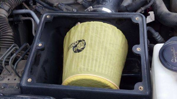

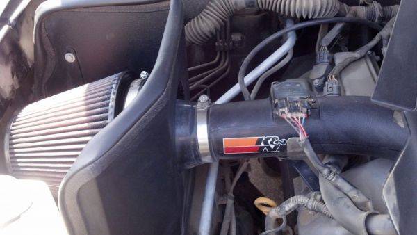

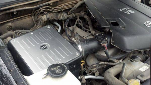

    aFe stage 2 si CAI w/pro dry filter- GONE, back to stock oem
    18" Magnaflow Exhaust
    Future Mods:
    Coilovers with resi's up front
    resi's in the back
    new spring pack
    rear bumper
    whatever else comes my way or I stumble on to

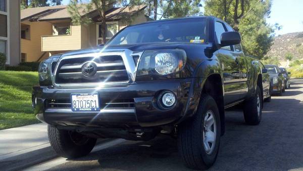

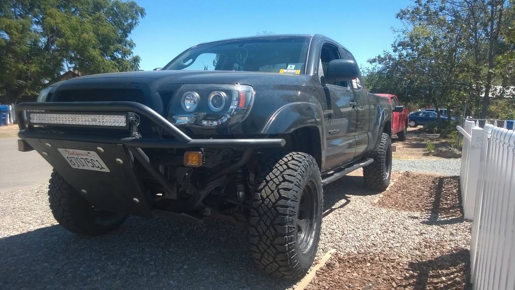

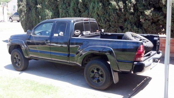

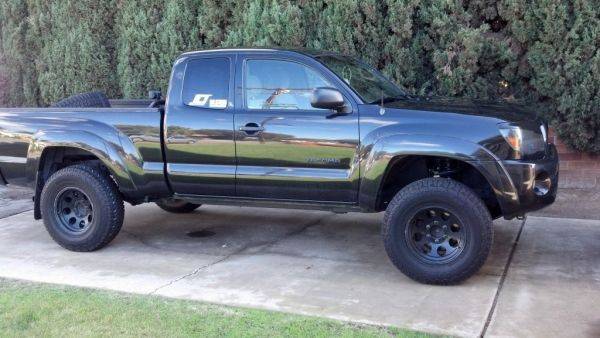

    How she sits as of 8/27/14:

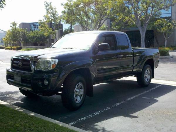

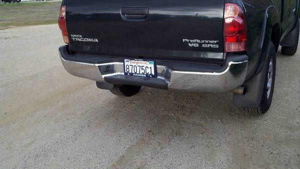

    The first day I picked her up......

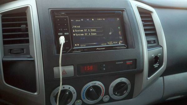

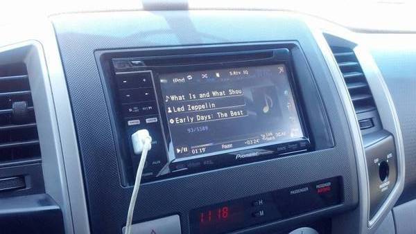

    First thing I did was put in a new stereo. Pioneer avh p2300 dvd player. Bypassed the parking break with a switch I hid in the change cup.

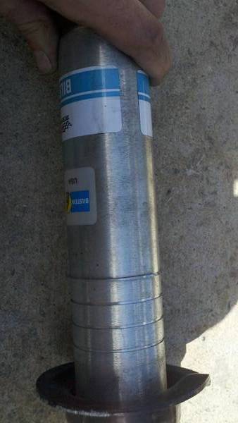

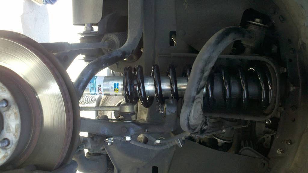

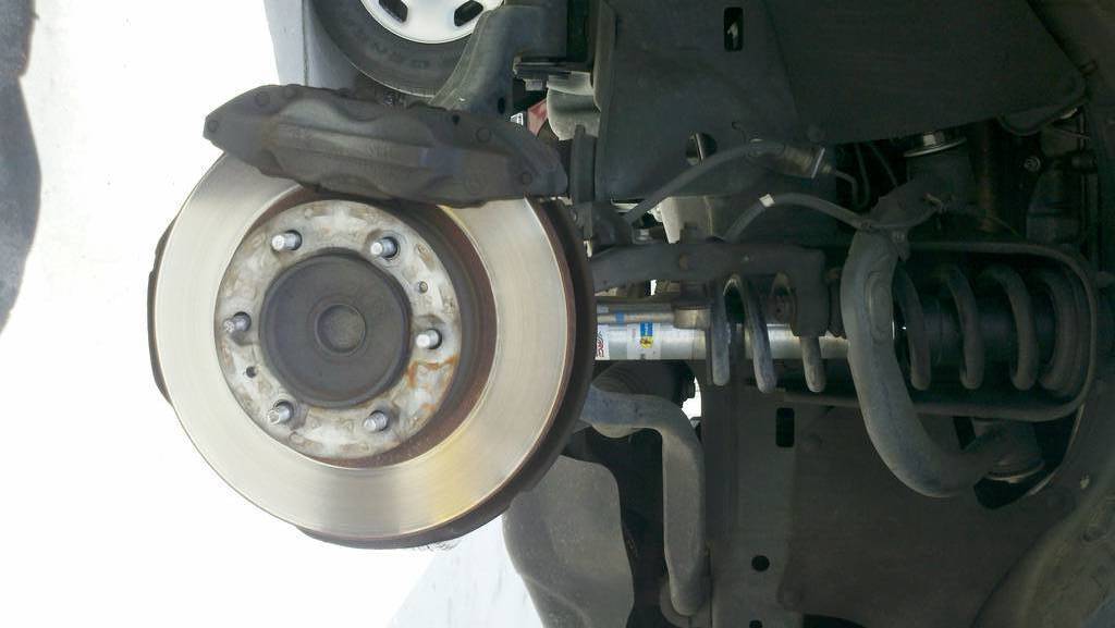

    Then I decided it was time to put some 5100's up front at 2.5". Figured what the hell lets go all the way.

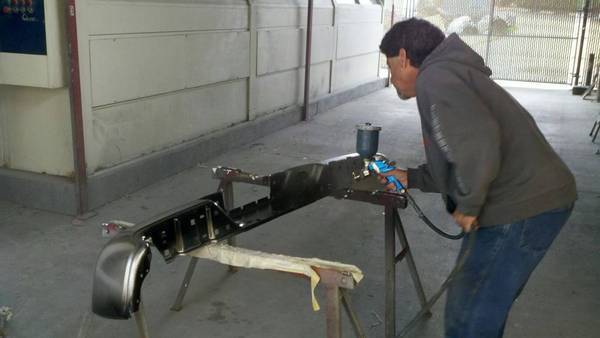

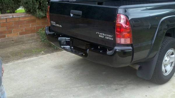

    After that its been alot of plastidip and paint. First the rear bumper. I took off the bumper, sanded it down, and
    painted it in a booth

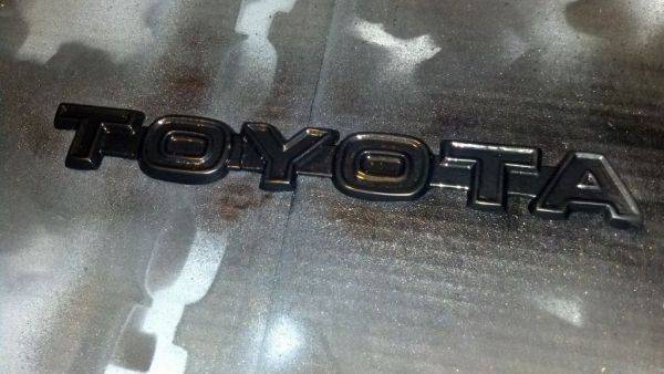

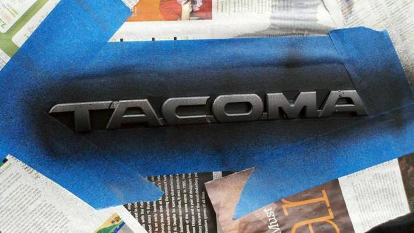

    Then the emblems got plastidipped...

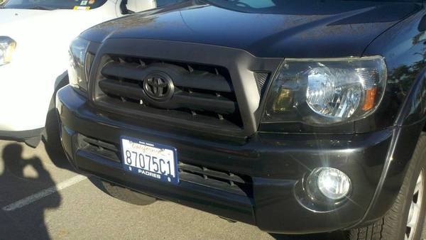

    Then the grill...

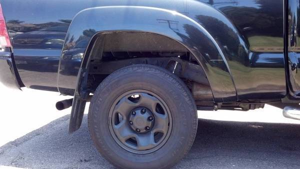

    Then the wheels...

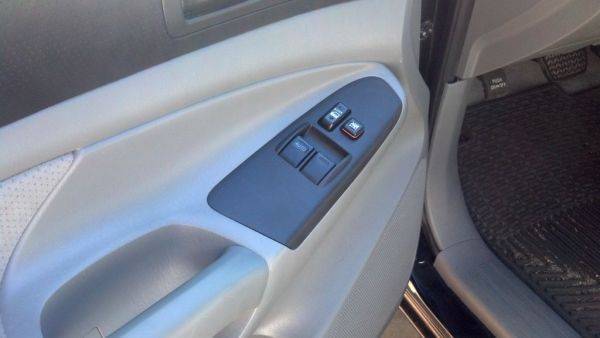

    Then the dash kit and ac cluster got balcked out....

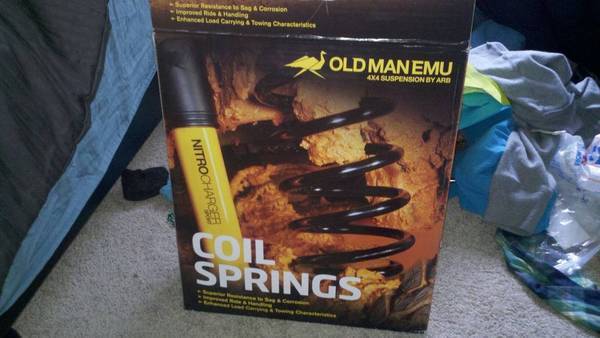

    Got an early birthday/late christmas present today! Throwing them on soon and then getting alignment

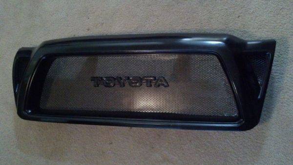

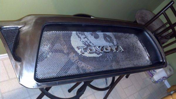

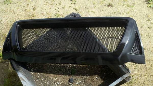

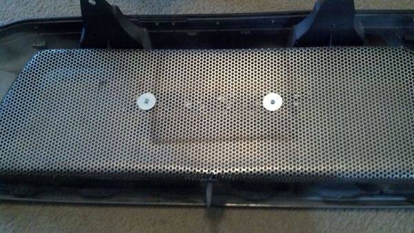

    So it took me a couple weeks....but finally got my satoshi done!
    Stock, and Satoshi

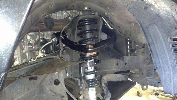

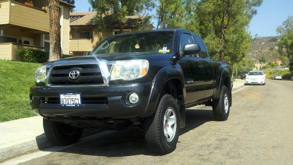

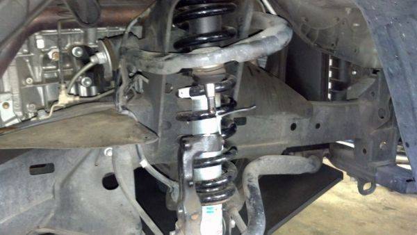

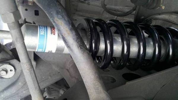

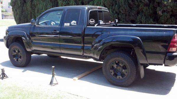

    Sunday 4/1/12: Threw on the OME 885x's. Lifted her up and took off the wheels
    Then took off the struts and took off the stock coils and moved it to sit at 0"
    Threw the coils on and compressed them down. Then threw the hole assembly back on
    Got 2.5" out of the 885x's with the bils set at 0". No problems with alignment with the stock UCA's.

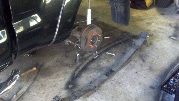

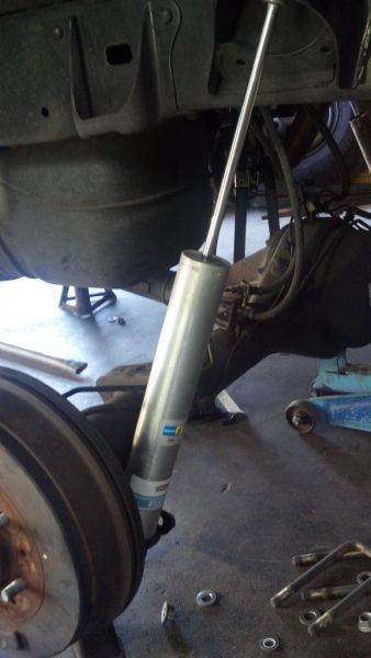

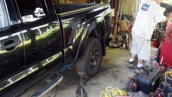

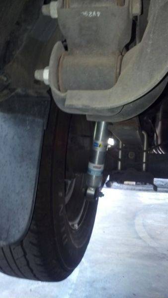

    Got some rear 5100's for cheap and threw them on, then a couple days later got crazy on the rear with some OMD special chevy 1 ton springs.

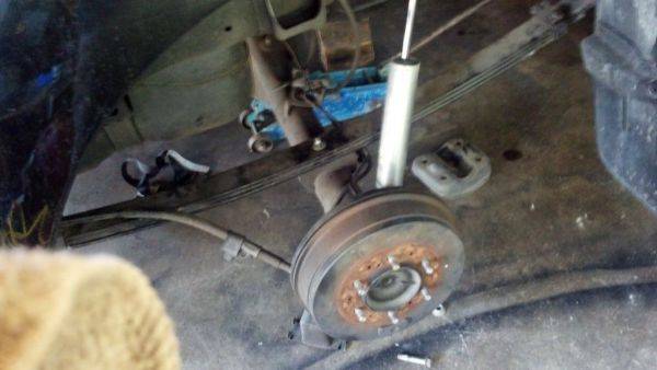

    Starting the day by tearing of the rear
    Old springs out
    New spring in
    Got rid of the bro lean and now sits about level. Ride is so much better. This is how the rear sits now.

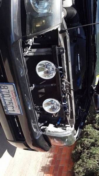

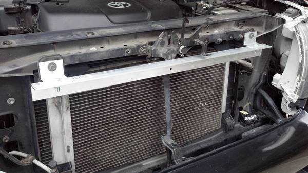

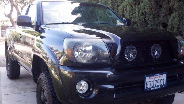

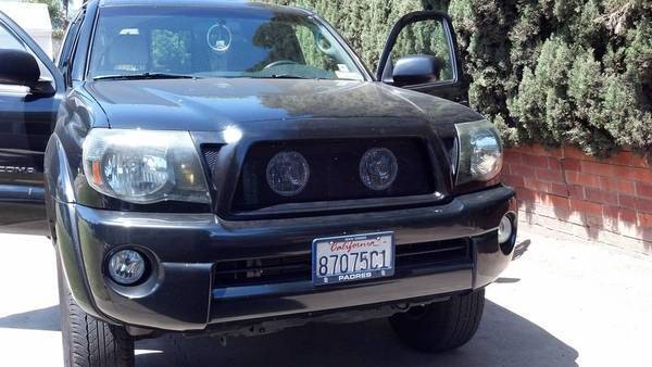

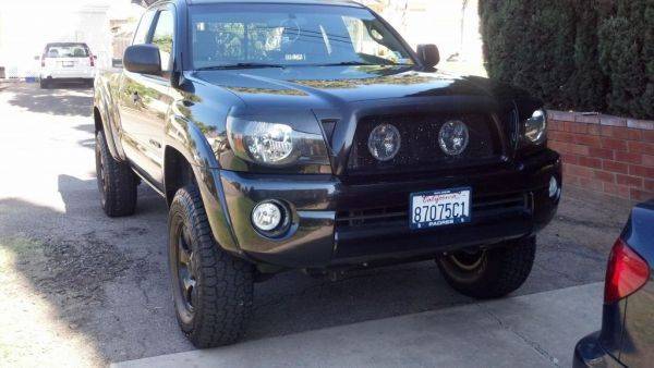

    Started on my light bar for behind my satoshi. Easy as hell. The bar was 20 bucks, and I cut it using a hack saw. Came out better than I thought it would

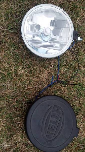

    Got some lights from Micah, a local tw guy. Hella 500ff.
    And mounted them up.
    Got the bar painted and fit up

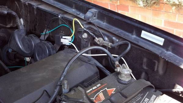

    Then wired it all up

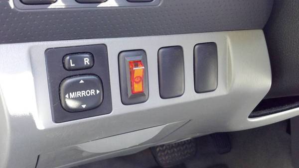

    Custom fit light switch....fuck yeah
    Put the grille back on and turned that shit on.....

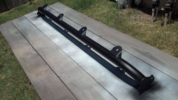

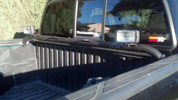

    Picked up my pelfreybilt rear light bar and got started on priming and painting.

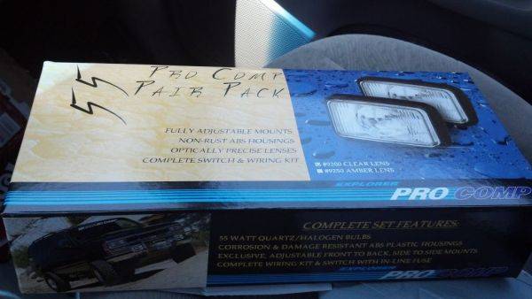

    Got some pro comp 55w lights for cheap as hell so I couldn't pass it up. Came with the wiring kit. Maybe led's in the rear one day. This will work for now.

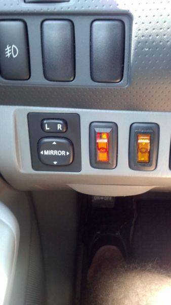

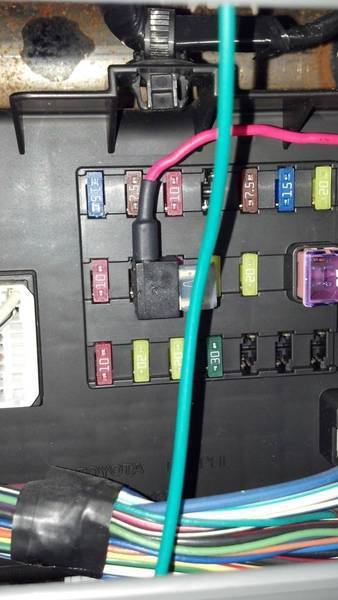

    Threw on the light bar and got it all wired up. Ran another relay and tapped into the existing add a fuse to run the rear lights
    Got the switch done. Rear and front light switches

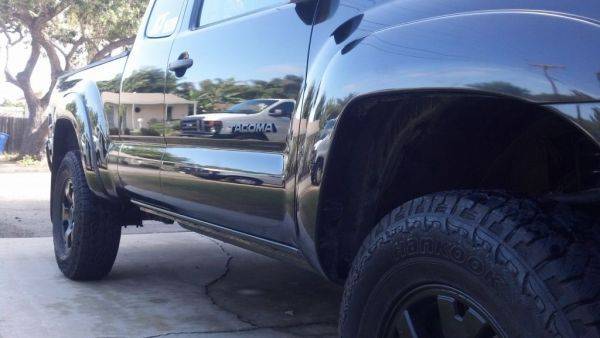

    Picked up my wheels and tires from another member in LA on Sunday, Hankook Dynapro ATM's 265/75r16 on TRD Offroad wheels, then off course had to black out the wheels with black wheel paint.
    Washed and Waxed

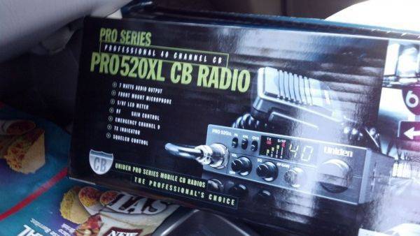

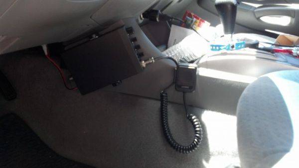

    Started my cb install today. Picked up a uniden 520xl at frys along with an antenna and other goodies.

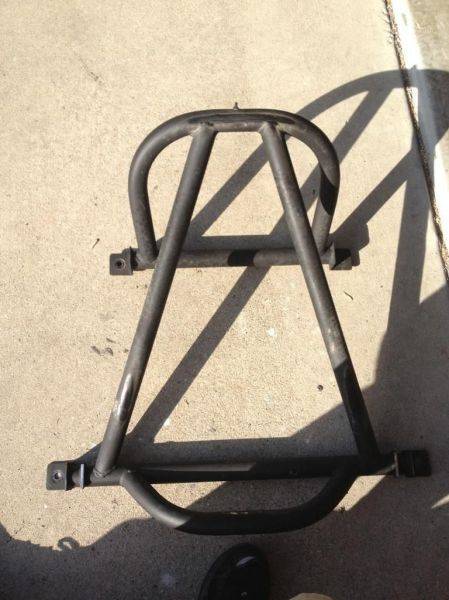

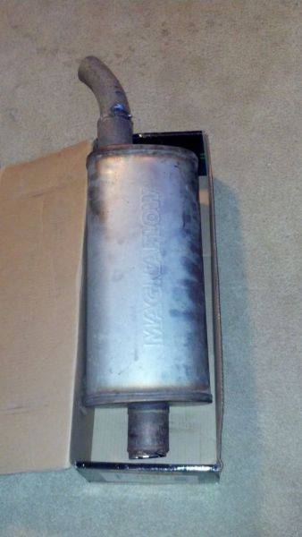

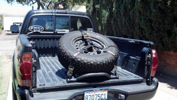

    Picked up an exhaust and tire carrier from Micah!
    Magnaflow Exhaust.
    Tire carrier. Got some new tabs welded on

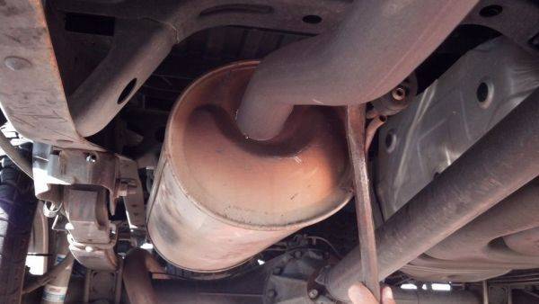

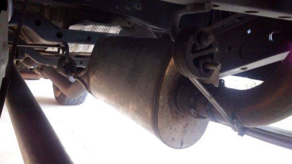

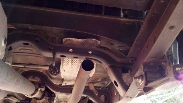

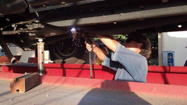

    Got the Magnaflow installed on Friday 8/16. Sounds amazing!
    Big, ugly stock exaust
    Cut it out
    And had the Magnaflow welded in
    Sounds amazing! No highway drone, and its got a low nice tone outside the cabin.

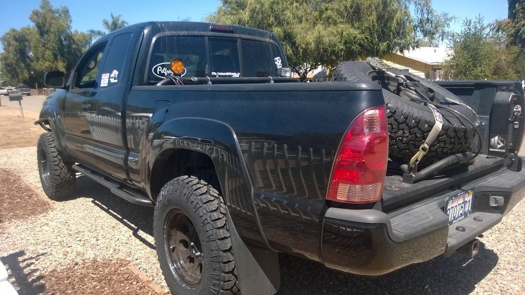

    Installed my tire carrier today 8/20/12

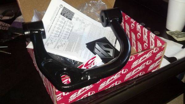

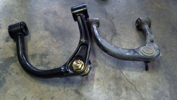

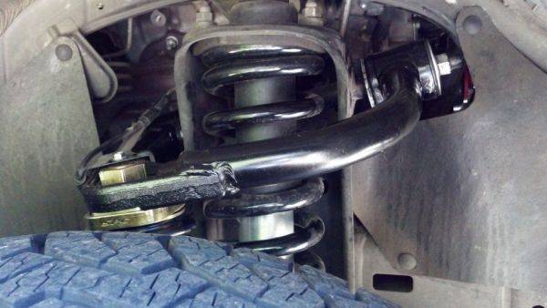

    Picked up a set of LR UCA's for a great price
    Then the next day, Leo and I went to OMD's house for some early morning install
    Pulling the stock arms out
    and installing the Light Racing arms
    Everything in and ready to go.....but in desperate need of alignment
    After the alignment it drove like a new truck. The difference is amazing!

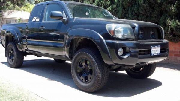

    Added some 1" spacers I got from John, but those will come off soon when I get my wheels
    And added some T-Rex eyelids I got from a TW member. New stance and eyelids
    And blacked out some of the trim. Make it stand out a little.

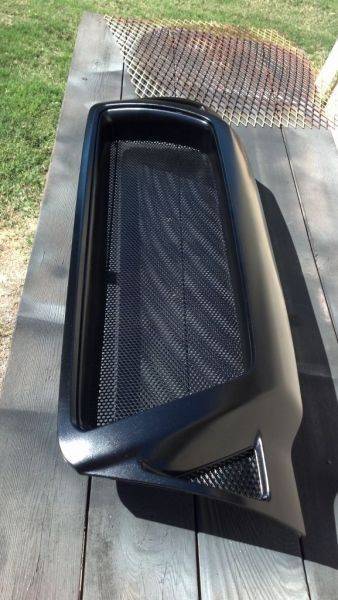

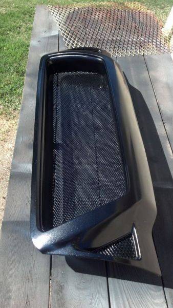

    So after the shit paint I used on the grille horribly failed, I thought it was about time to paint it right and put the emblem on.
    Sanded
    Primed - 3 coats
    Paint - duplicolor BSP 3 coats
    Clear coat - 3 coats
    Jb welded the emblem, primed painted and clearcoated
    3M'd and screwed on, shit isnt going anywhere!
    Got some Wheelers 16x8's. Kinda scratched up, but I plan on painting them. The front rubs on the caliper, so the 1" spacers stayed on for now.
    Went from this:
    To this:
    Happy happy

    Updated. Early birthday present! Cant wait to get them on

    Satoshi on and love the look! cant wait to get some lights now.

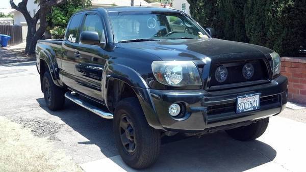

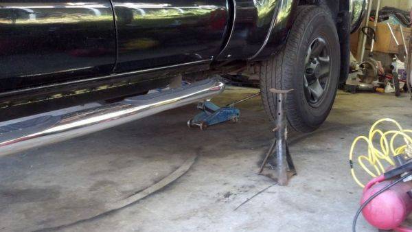

    Threw on some steps! Thanks to Chris. Even the girlfriend likes em!

    No didnt plastidip the bumper. My Dad painted his truck and had left over paint, so we took the bumper off, sanded all the chrome down, and painted it in a shop. If you go with plastidip it'll look flat black. I dont think they make a gloss plastidip. Another option is to get a trd sport color matched bumper if you wanna go that route

    Good lookin truck man. What kind of tires ya planning on puttin on?

    Thanks man. Think Im going to go with some treadwrights. Couple of the San Diego guys run em and they got nothing but good things to say. Going to go with some 285's all terrains.

    285's are a good size. Not a bad price on those, just checked em out.
