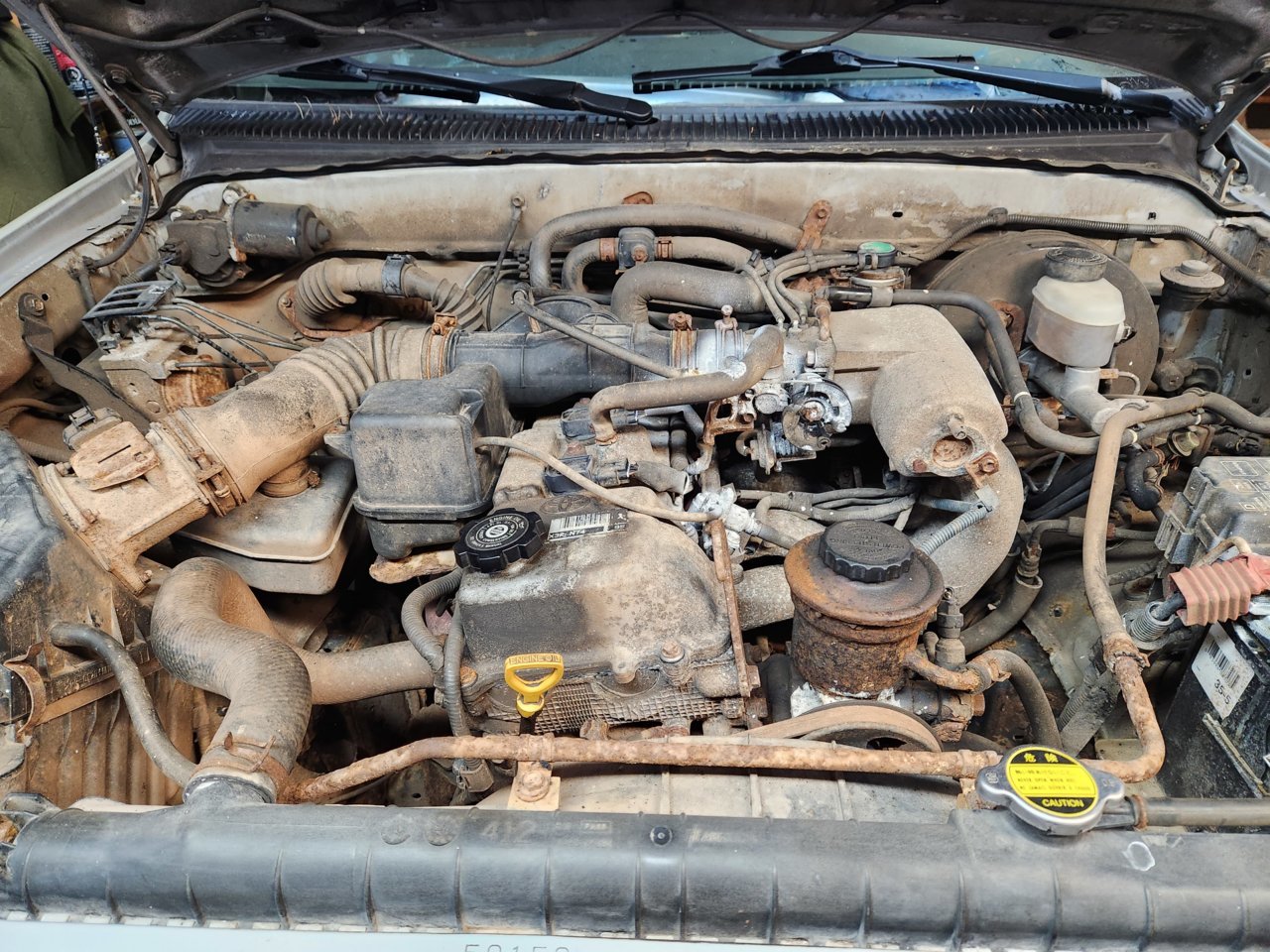

    Good day all.

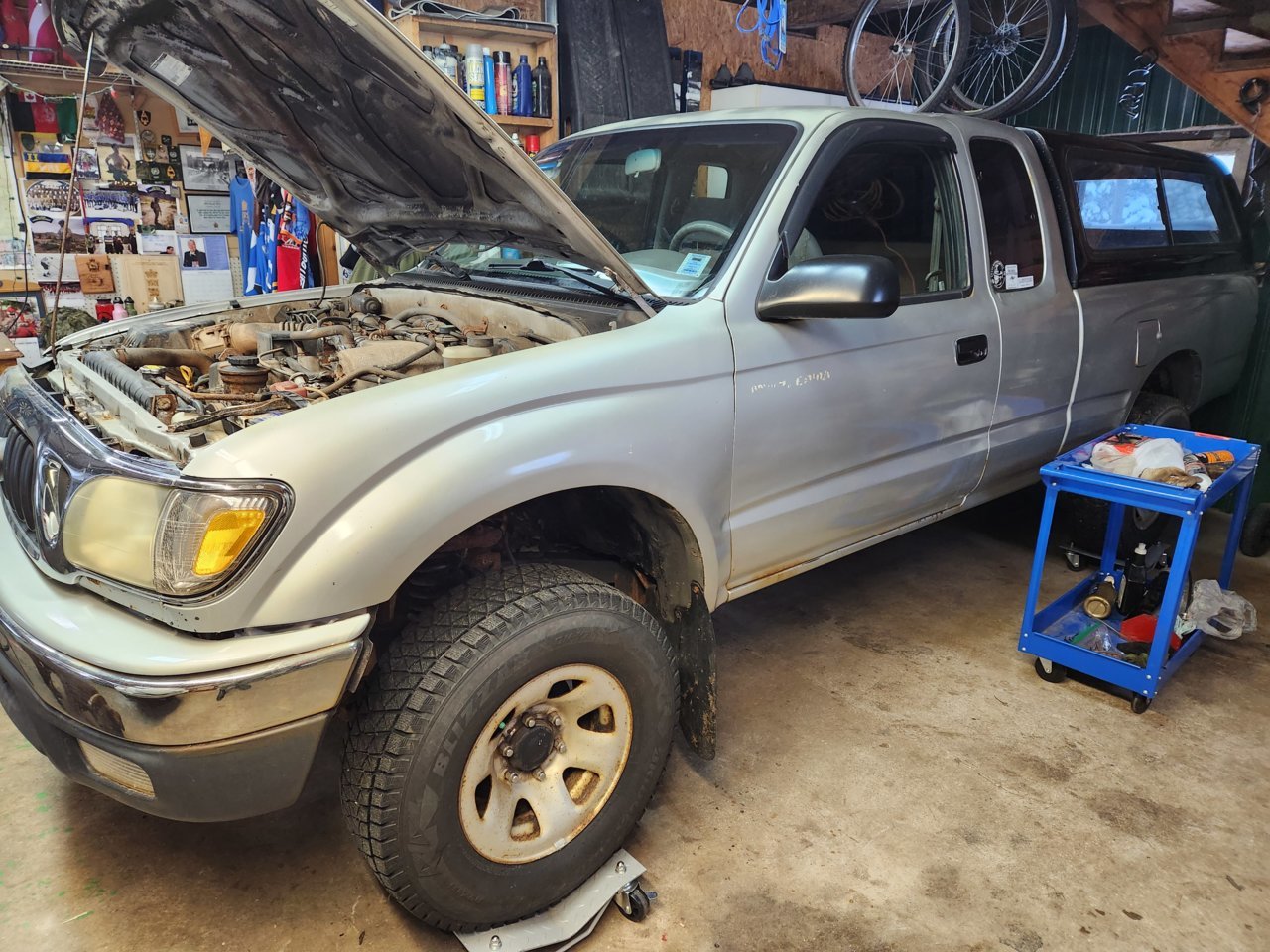

    I wanted to start a new post on my upcoming project. I recently flew out to Nova Scotia and picked up my father's old 2003 Tacoma.
    The truck is: 2003 Tacoma
    2 door access cab, 2.7 liter 3RZ-FE 4x4. 455000 km on the clock. I'm told that 2 cylinder have low compression. My best friend and I were able to fly off to Nova Scotia for a few days and drive the old truck back. We had some bets to see if it would make it or how far! I didn't doubt the old truck at all ( the first few hills in New Brunswick gave me doubts). The old truck worked hard to get up to 80km/h but once there would cruze nicely in 4th or 5th. Luckily for us, the truck is a 5 speed manual transmission so we could work the gears to keep the revs up. Truck is now parked in my garage in Ontario. My plan: I'm am currently starting my retirement after 29 years in the Canadian Armed Forces as an Infantry Sergeant Major. I have lots of time on my hands and want to tear into my father's old Tacoma and keep it as my daily driver once rebuilt.
    I currently have a 2008 Tacoma that I have had since new and love it, but don't really need the 4 doors anymore (recently empty nesters) or the 4 liter fuel consumption. I sold my old travel trailer when the kids moved away and don't need the big 2008 Tacoma. I hope to fix my father's old 2003 Tacoma with the 2.7 liter 3RZ-FE and keep it as my daily driver. Give my son(also an Infantry soldier in the CAF)my 2008 Tacoma as he may need the 4 doors in the future.
    My father loves his old truck and I must say I've also liked the 1st Gen Tacoma's best. My father after 2 hip surgeries and a failing older 2003 Tacoma got a newer 2014 one that is automatic for his hips and age! After his 2003 Tacoma sitting in his yard for a year my mom told me to come get it and fix it up or it would rust away to nothingness. My father would never sell it and is a bit of a junk collector. So if you have read this post to the bottom, you are now up-to-date of where things sit.
    I want to slowly take apart the engine and rebuild as cheaply as possible doing all the work myself. Any ideas out there in Tacoma world are welcome. Truck will be a daily driver as I already have a HDJ 81 for my fun offroad rig if needed. 20221227_104211.jpg 20221213_154628.jpg

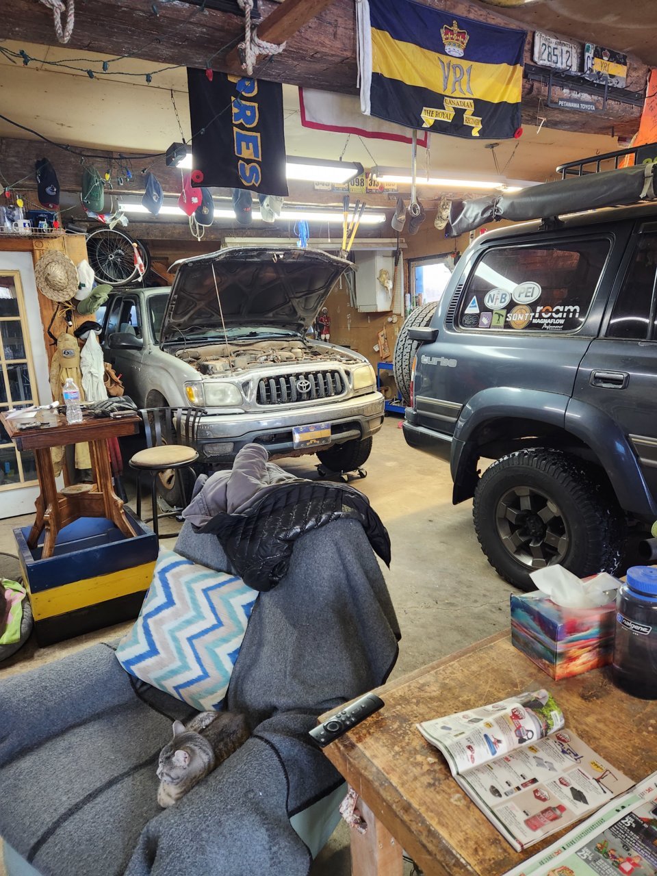

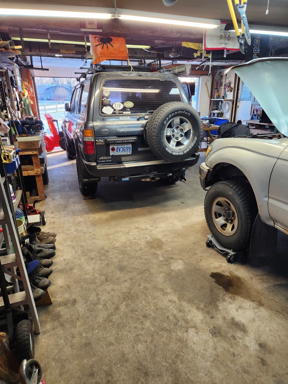

    Working on the truck a little this holiday season. World juniors Hockey on the TV in the garage and fire burning hot. Life is good.

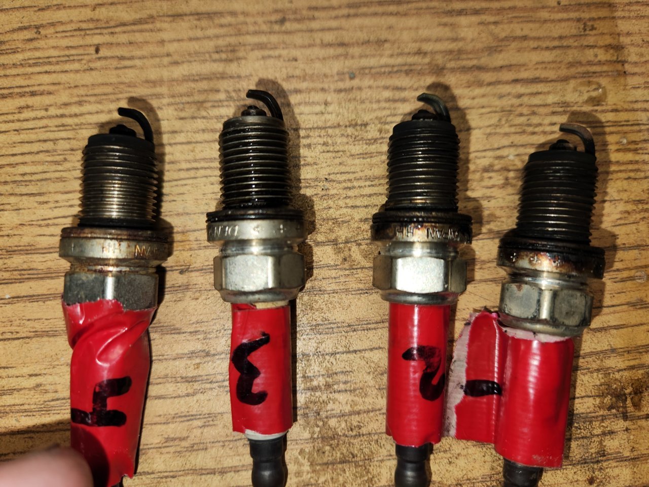

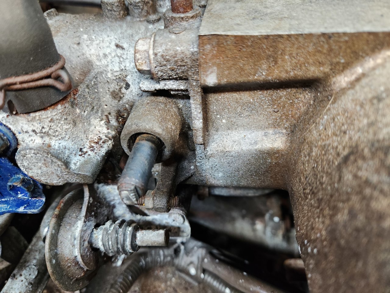

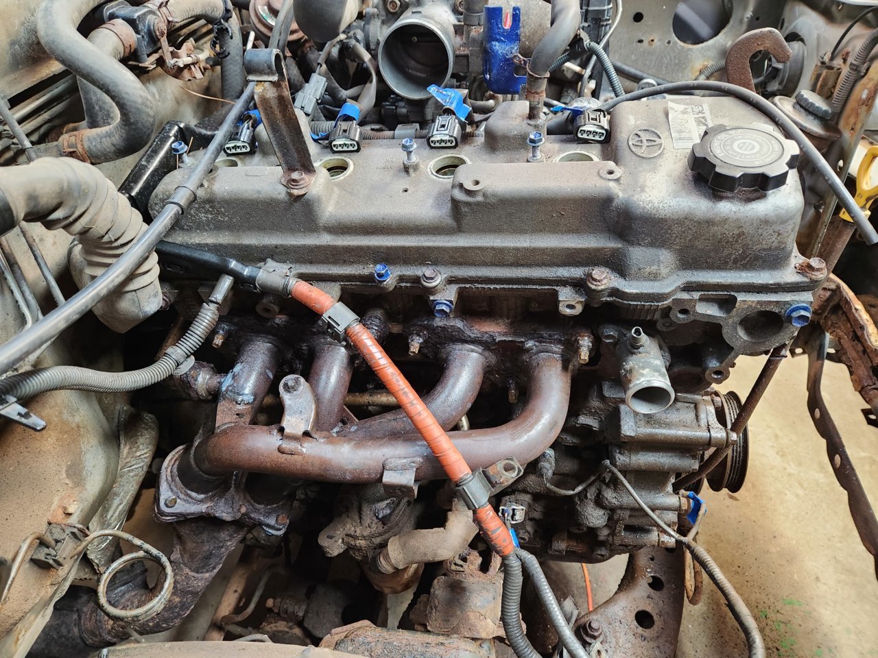

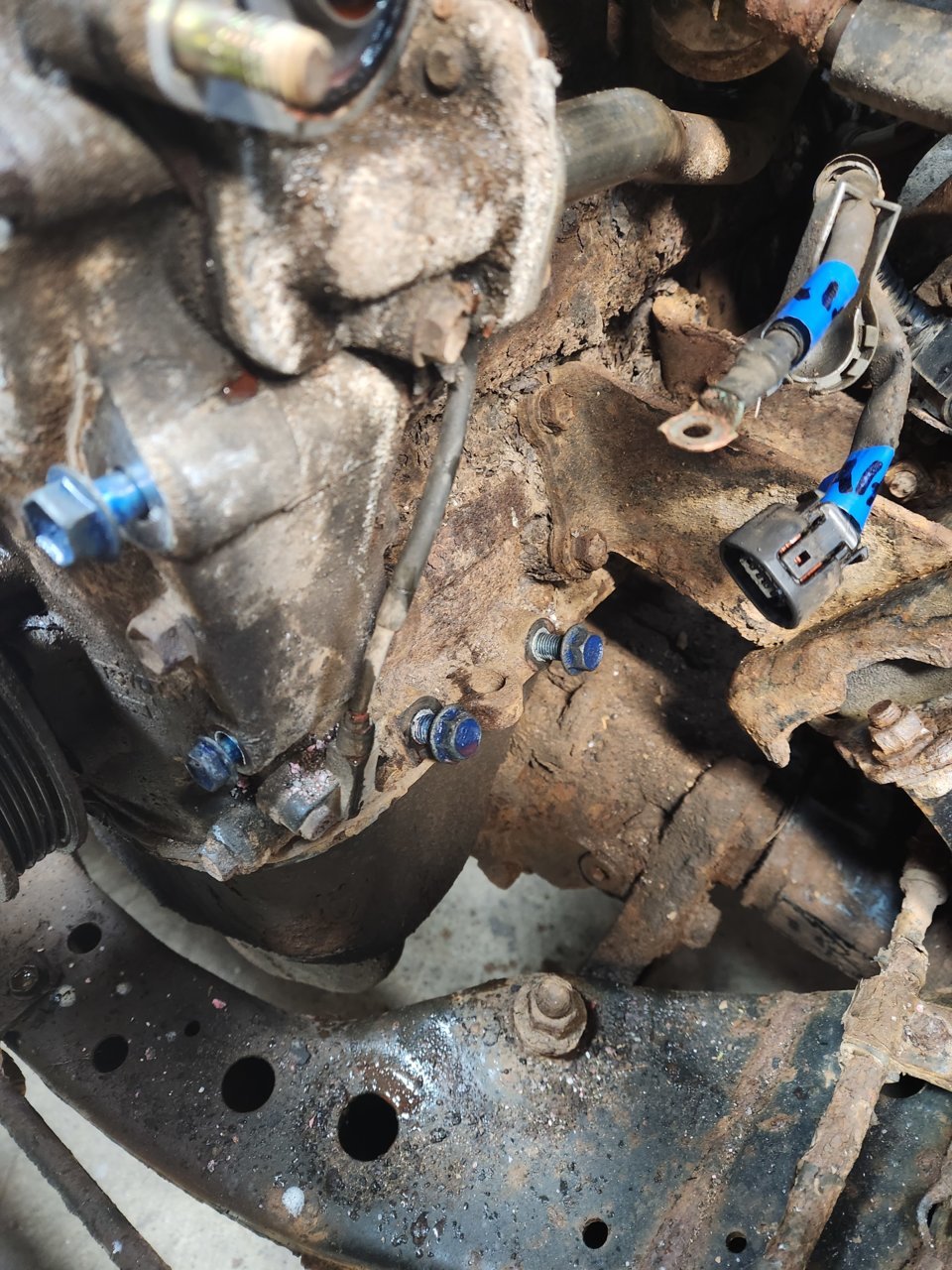

    A few more photos .
    All 4 spark plugs burnt. Number 3 had coolant on it when pulled and 4 was extremely burnt.

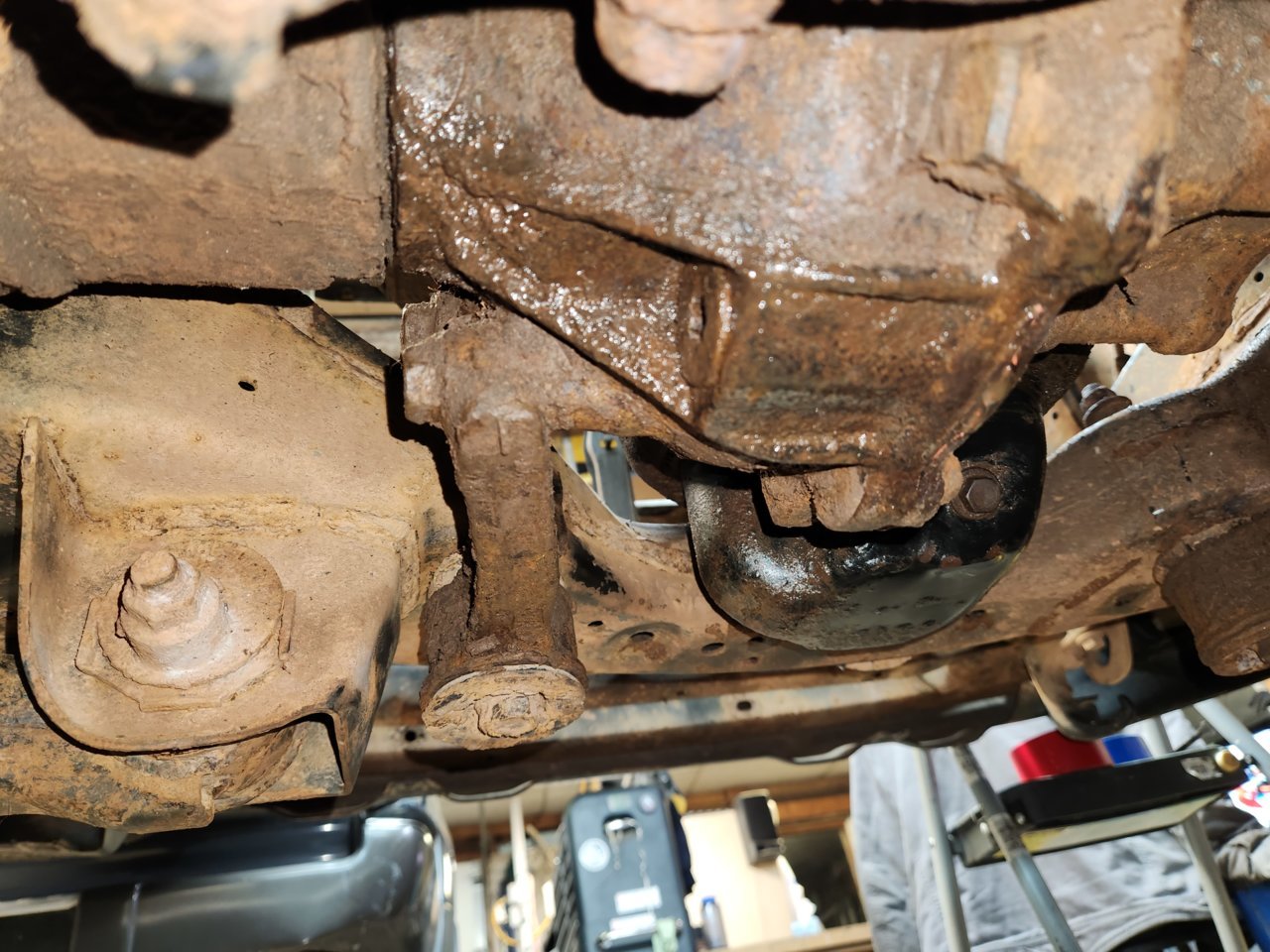

    Leaking front diff. Was low before I filled it. More jobs upcoming
    Leaking transfercase. Was low before i filled.

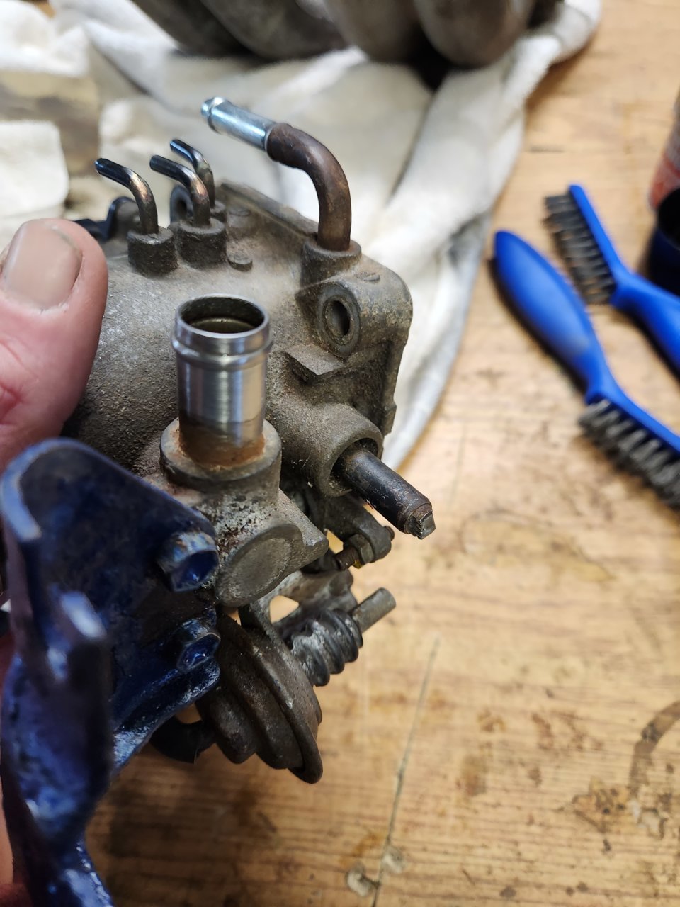

    Broke a few parts. Including the bolt for the accelerator cable spring thingy.

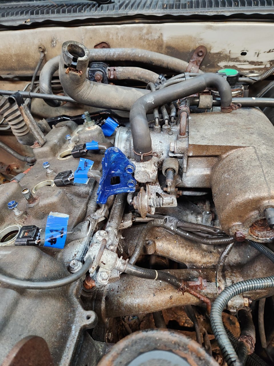

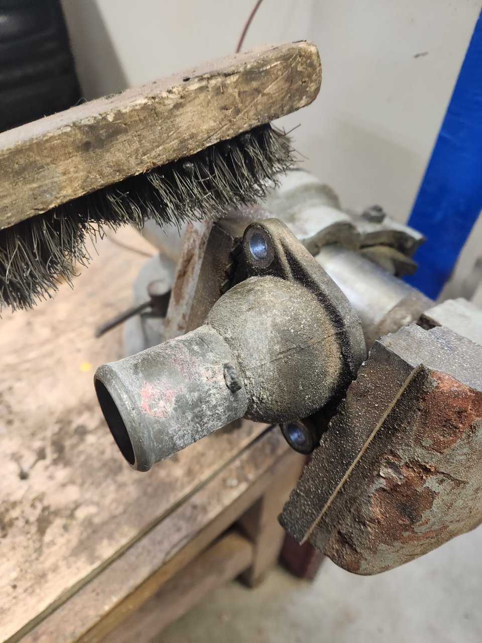

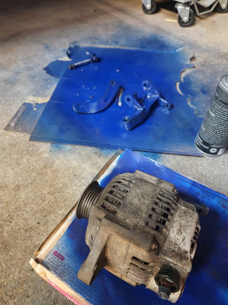

    As a pull each part, I have been trying to clean, oil and then put a little rust paint on each and bag or reinstall.

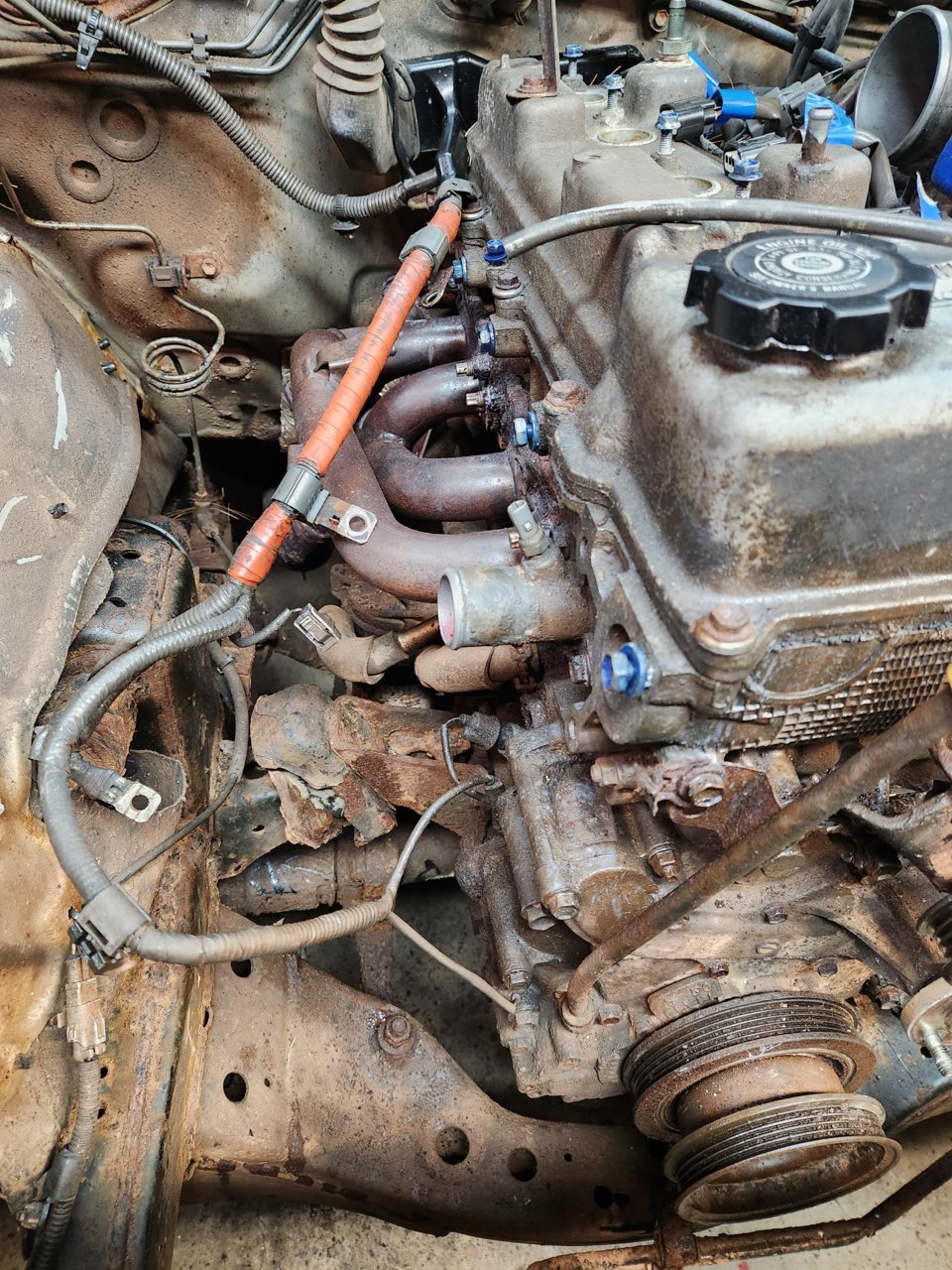

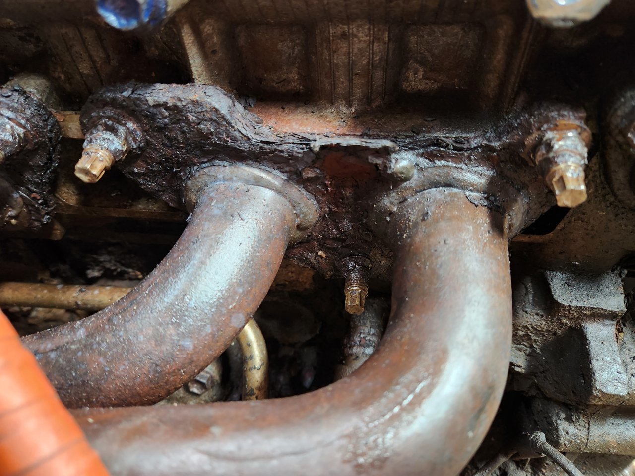

    Nova Scotia and New Brunswick red mud, salt and lots of rust. Header bolts are a treat!

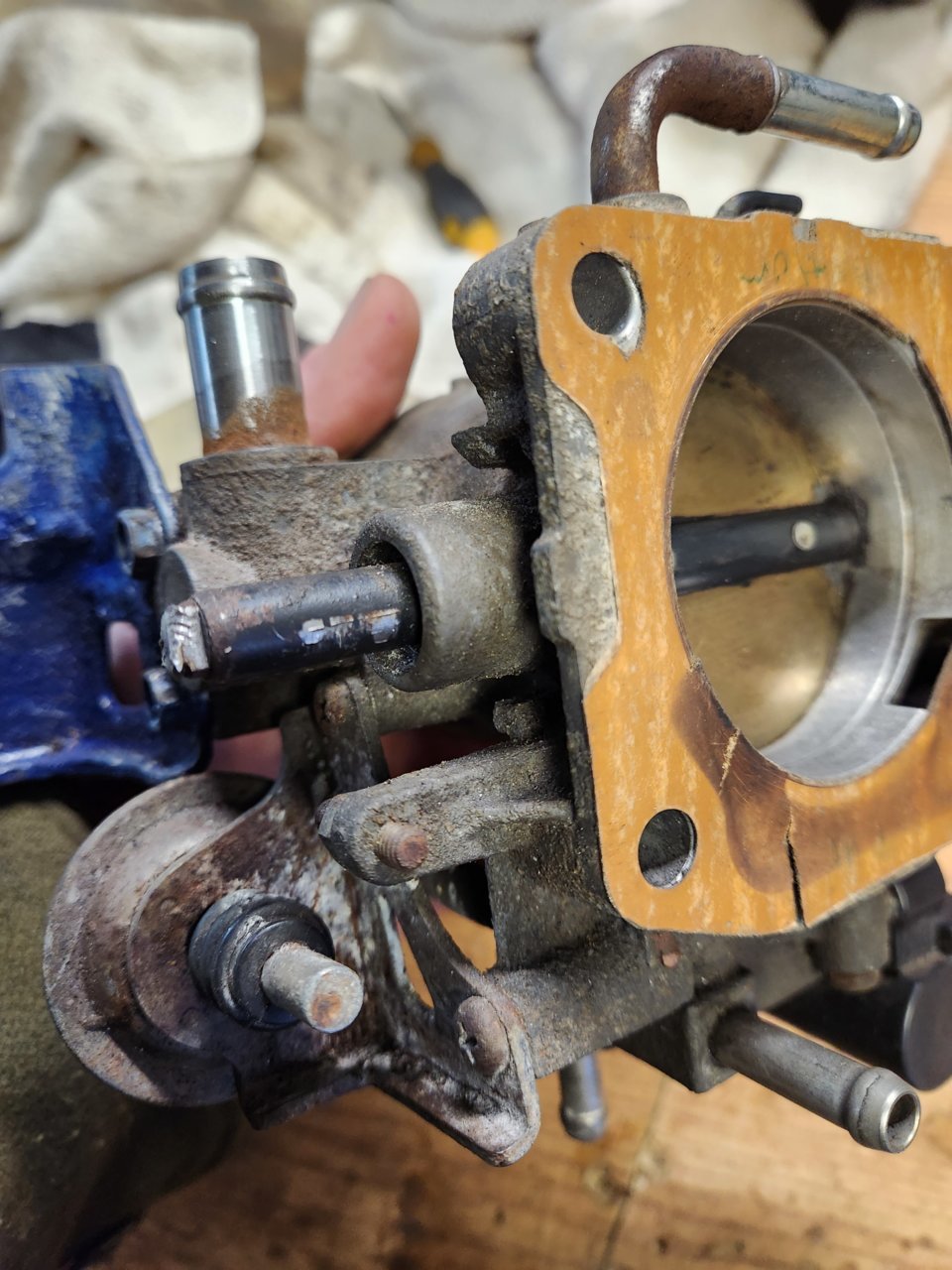

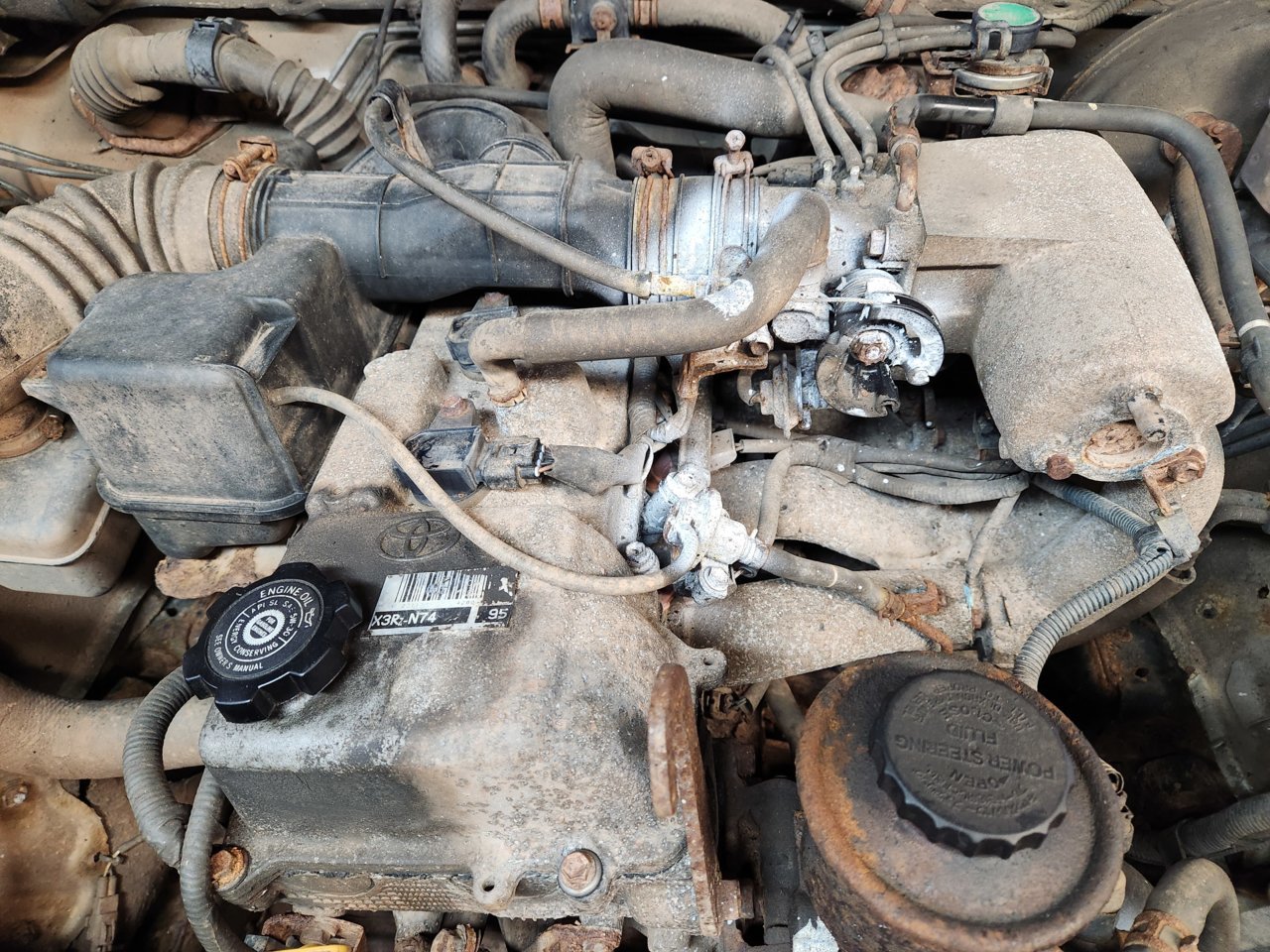

    More progress on the tear down. But I broke the throttle assembly. The nut and bolt that holds the spring on that attaches to the throttle cable. I've looked on a few sites and haven't been able to see the part I broke. Is this broken bolt and nut holding the throttle cable onto the throttle body? Do I have to purchase a new throttle body complete?
    Thanks for looking.
