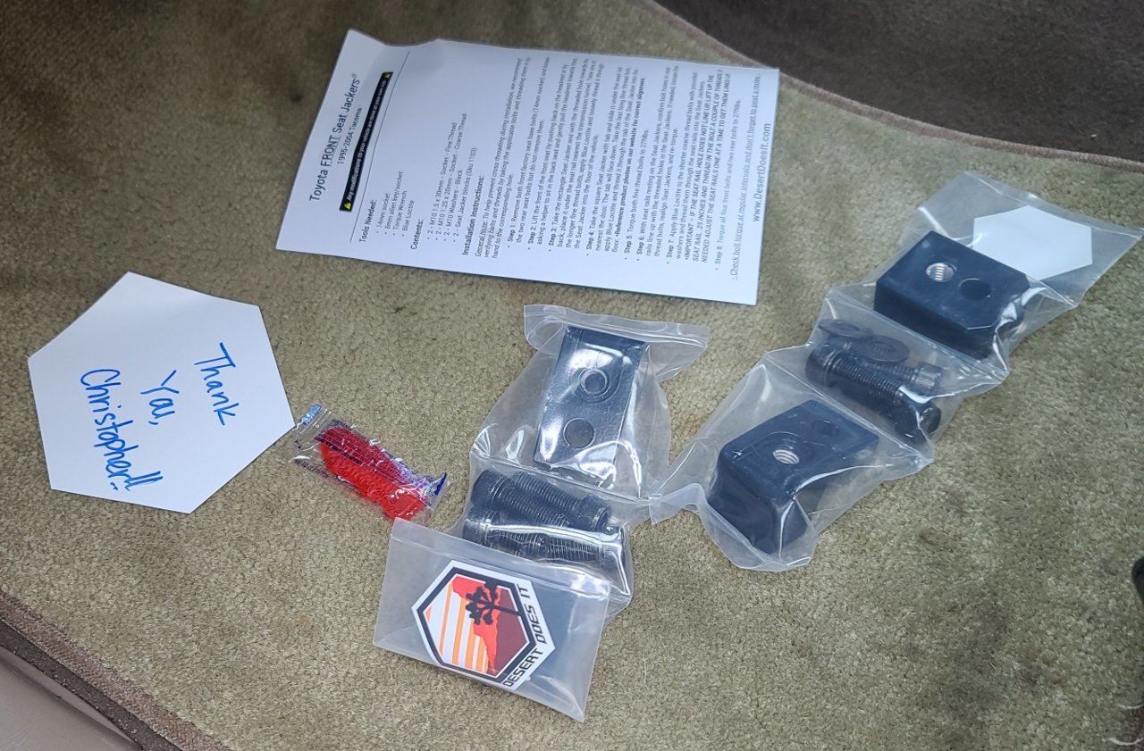

    Here's the contents of the DesertDoesIt Seat Jackers for the 1st Gen. I got the "two front buckets" set, lifting the front of both front seats. So, two nice strips of parts. Plus instructions, a large sticker, and a snack!
    Here are the parts laid out (sorry about the greasy floor mat. Dad took really good care of his truck; can't believe the mat looks like this! :rofl:)

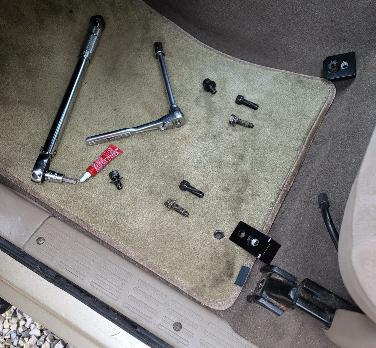

    In the pic below, I'm showing the blocks are in the correct location and orientation just prior to install. "Block to Floor" bolts are next to the OEM bolts (not reused); slightly shorter bolts (they're all allen) with washers go "Seat to Block".
    It's really an easy install. All bolts came out / returned without drama. I even removed the decorative plastic caps over the rear bolts without cracking them.
    The only hints I could give: When loosening the rear seat bolts, you really don't have to back them out far at all. Also, the seat tracks are pretty forgiving, so there's no need to worry about things not lining up perfectly.
    I did try to take a comparison pic before doing the second seat. It doesn't look like much of a difference... it's hard to get a true perspective with camera angles. Eyeballing it, the change doesn't look like much. But when I jumped back and forth from one seat to another... It's amazing. I could easily, immediately tell the difference and really confident that this is going to be a game changer. Also, no change in headroom (I'm 6' 4") because the front of the seat is lifted but the rear is not.
