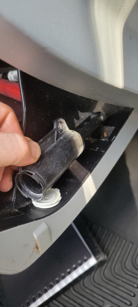

    Inside my glove compartment is this...."device"? Has a mounting bracket so I'm assuming it is factory the lid comes off and has a spring loaded slide. Also there is a white powder substance inside the tube? 17270975104484778813159984724837.jpg 17270976125056903528908187127019.jpg

    Looks like the piston/dampener for the glove box.

    As Sig45 said, damper piston for glove box door. It has to come off to change cabin air filter. PIA to put back in

    I have zero issues taking my damper on or off with a simple pinch with my fingers of the mounting post to compress the two halves. The damper comes right off (or on). What makes it a PITA for everyone?

    I release only the glovebox side of the damper to change my cabin air filter. The instrument panel side can stay connected.
