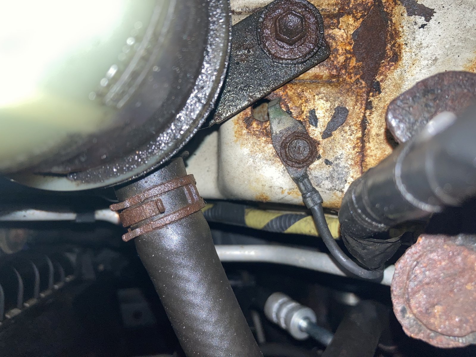

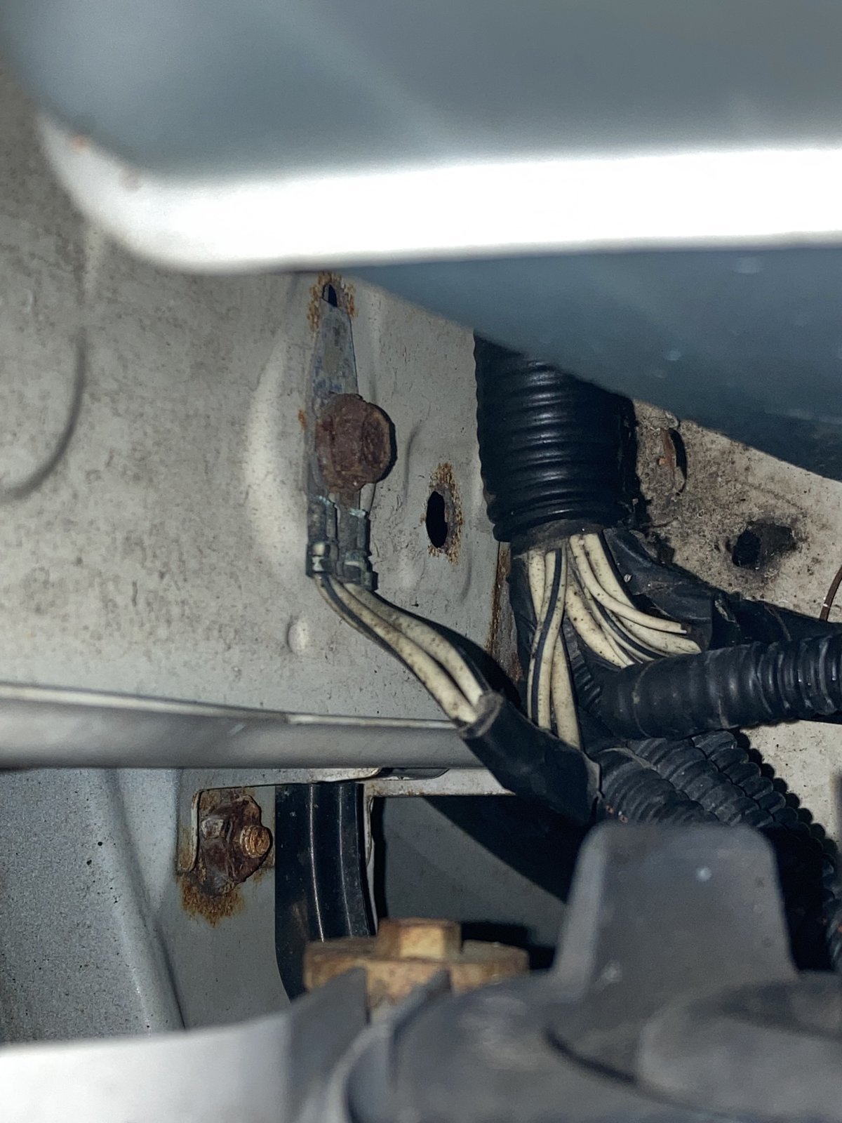

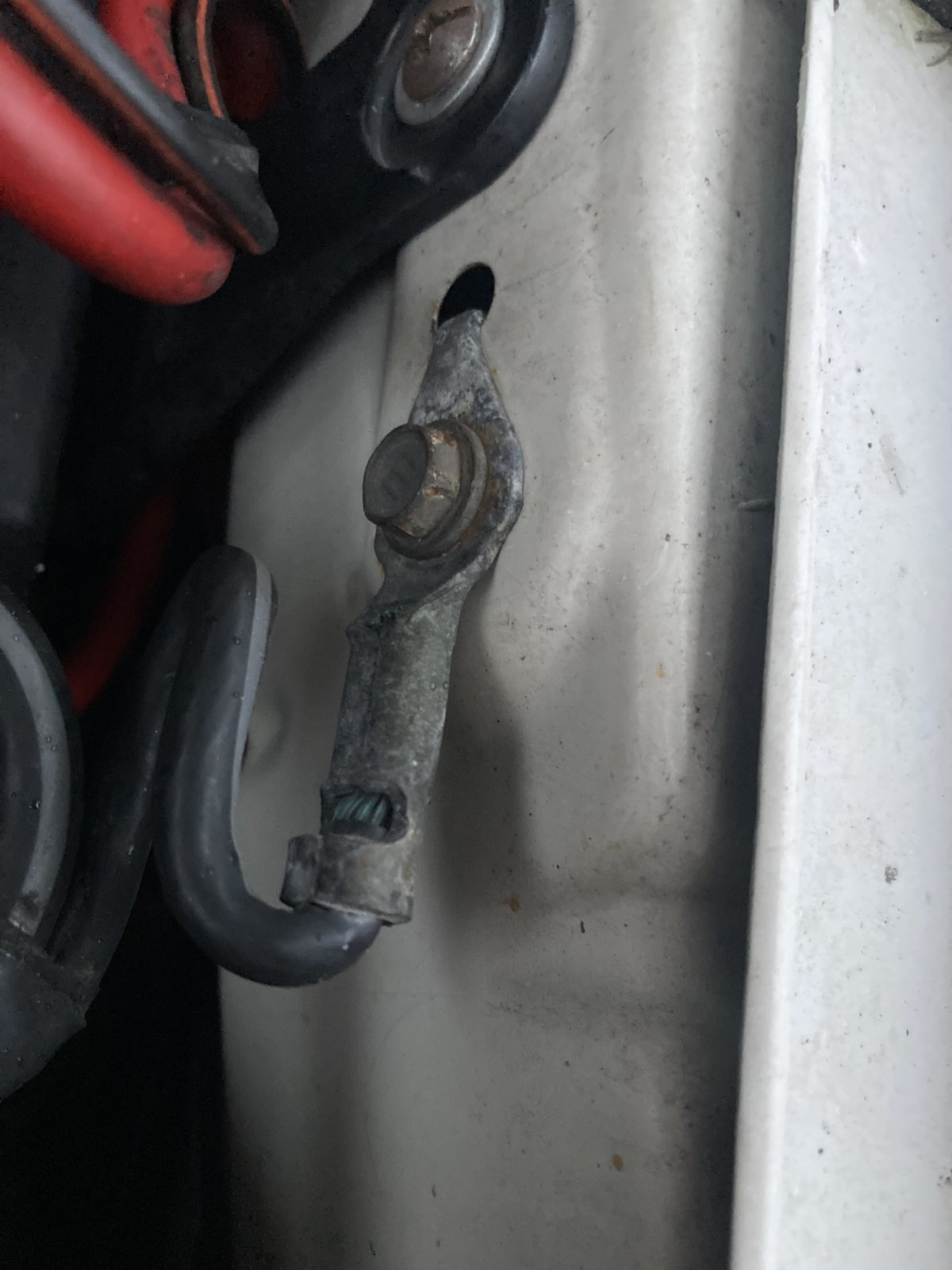

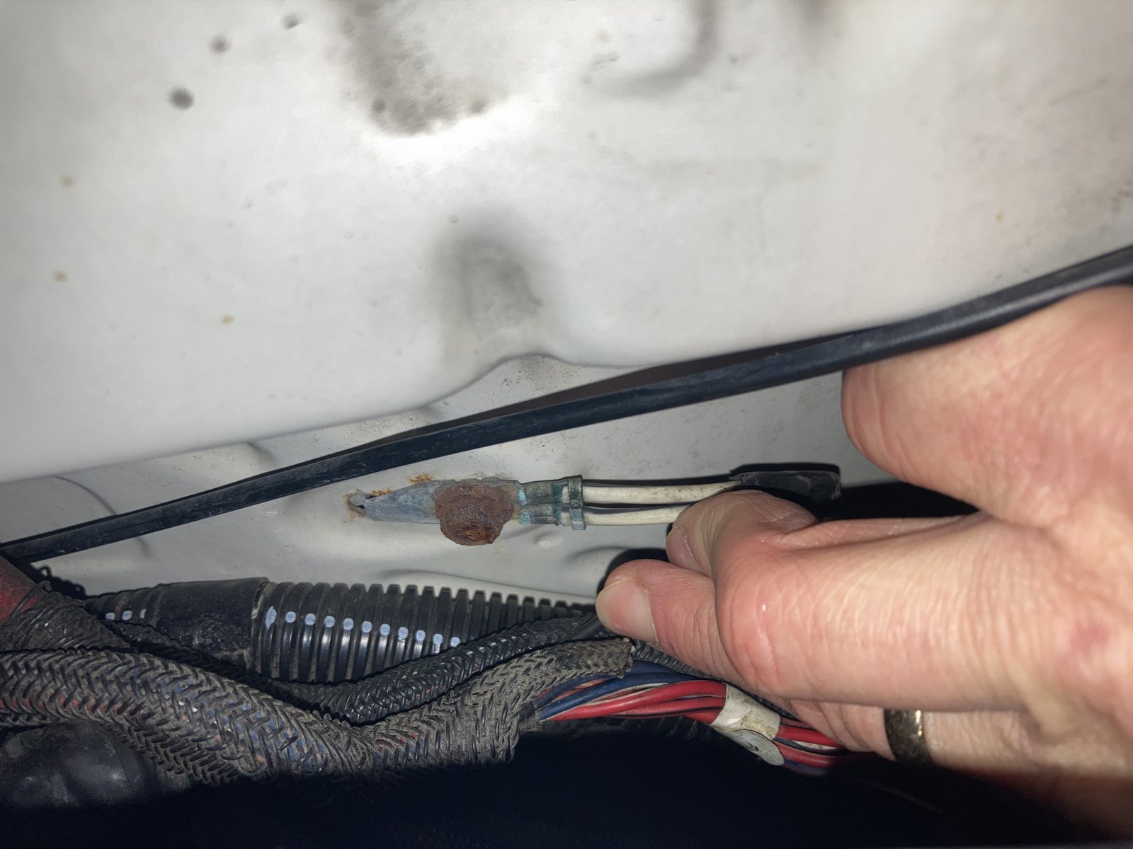

    Those grounds look pretty corroded to me.

    I will have some time later this week to clean them up. Would the body ground on the rear bed/frame be potential causes? If so does anyone have the diagram? Might as well check those too.

    I wouldn't think so but it certainly wouldn't hurt to clean them.
