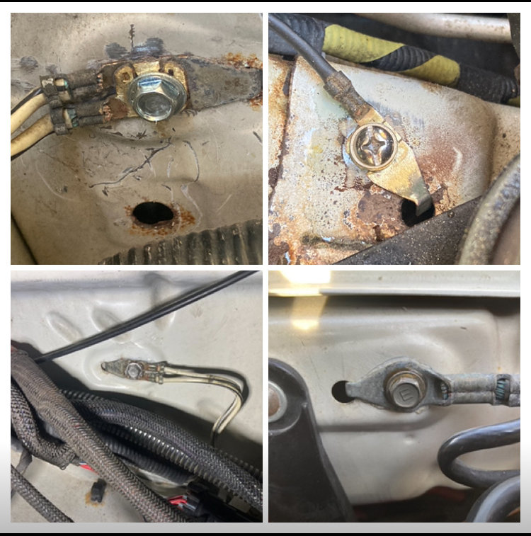

    I cleaned and reassembled the four body grounds under the hood. I tested these four grounds as well as two grounds that sit on the back of the engine.
    I also checked the frame ground at the drivers side front wheel
    I still have the flashing dash lights when I start it as well as the addition of a Knock Sensor error now.
