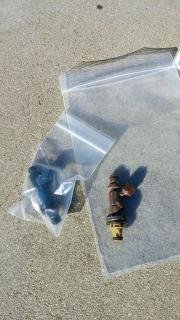

    Still have not twin-charged.

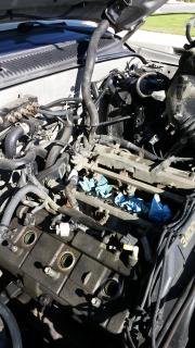

    Developed a horrible miss (cyl 6, and if I get on it, OBDII then gives the multiple cylinder missfire). I started to nuke what could be the issue, swapped injectors and spark plugs and about to look at fuel filter and fuel pump. I then changed the spark plug wires and back in business.

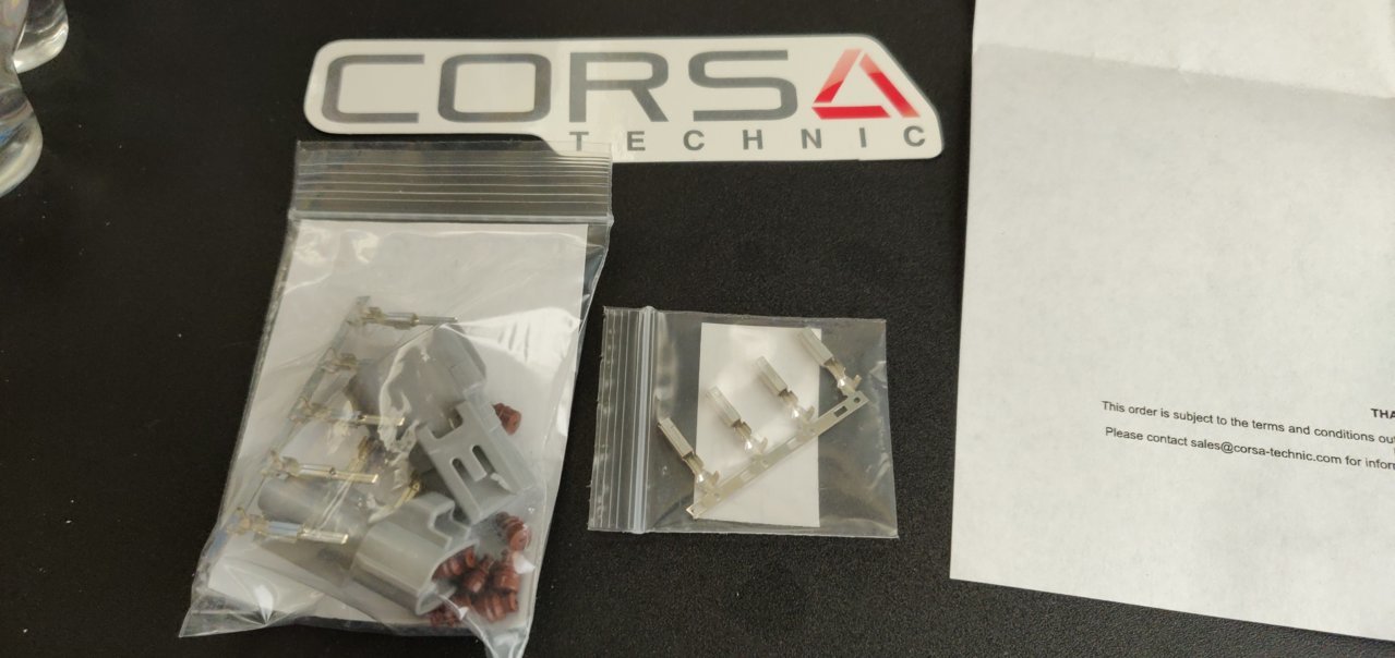

    Took the opportunity to put in even larger injectors, some 625cc injectors to have head room for E85 plus more boost in the future.

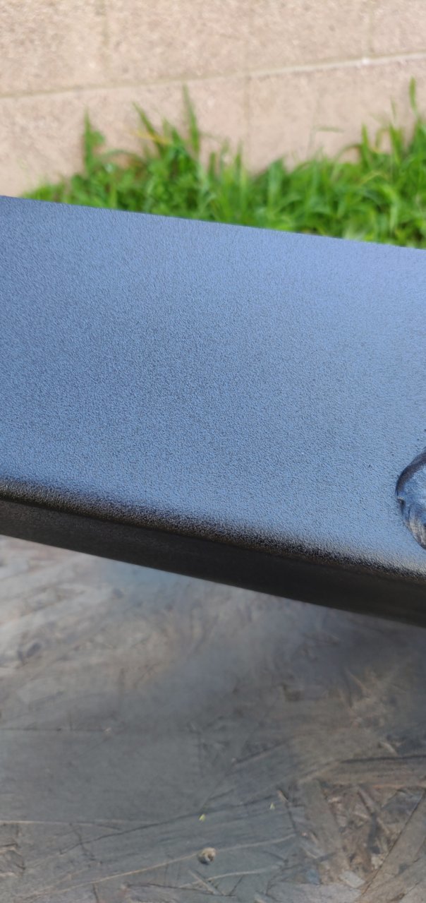

    I'm digging the texture out of this can

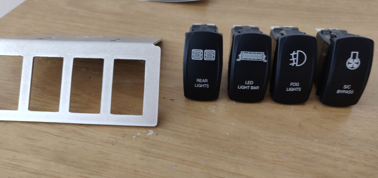

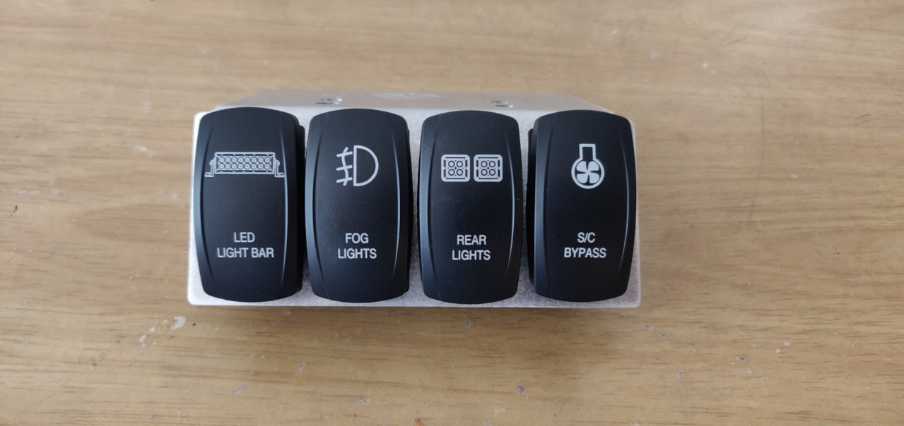

    Paranoidfab and OTRATTW switches for the win. Love using an otherwise useless area (cig box) and these switches have Amber lighting, additional lighting when actuated, and custom options (my sc bypass has a labeled switch now).
    16watt lolz, more like 6 haha. But I bought the cheapest yellow pod lights on eBay for exactly that reason, I have a plan for these so they do not need to have the lumens of the sun. In fact tested 6ohm, them 180ohm resistors to dim them even more and will likely use 250ohm. These fog lights will double as my front blinkers. In blinker mode they will be dimmed down.

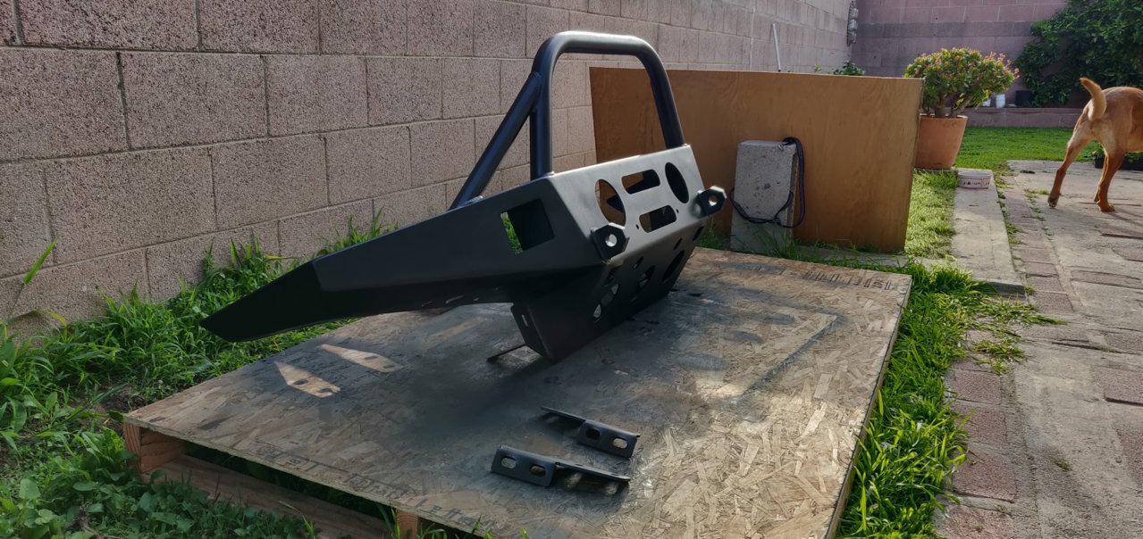

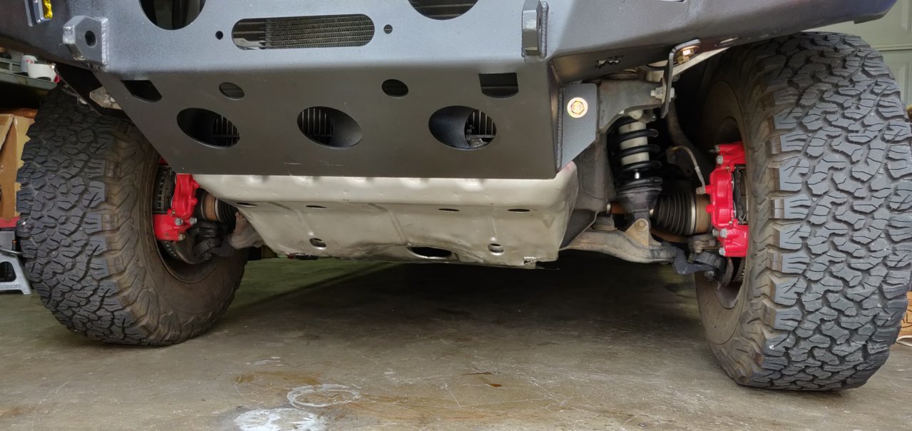

    Finally got the Relentless front on
    And some dirty nasty quick Jerry riggin to make the front yellow fogs work as turn signals until my parts arrive to do this better.
    LEDs are so effecient, even significantly brighter than the OEM blinker lights, the Ambers still trigger the infamous 'fast' blinker feature of the body ecu to tell u that u have a bulb out (sees LEDs as an open because they draw less current/higher resistance)

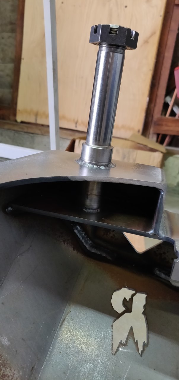

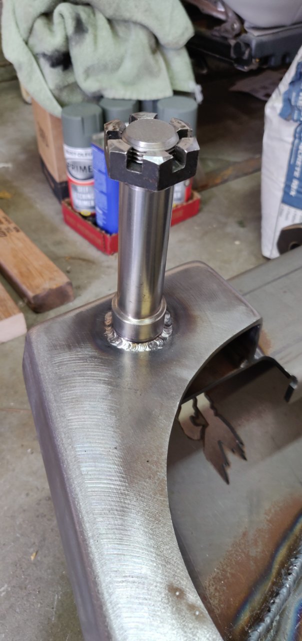

    IMG_20190512_124928.jpg IMG_20190512_120620.jpg IMG_20190512_120616.jpg IMG_20190506_175345.jpg
    Primed, welded DIY swing out spindle and connectors to make my led blinkers pnp.
    quetzal likes this.

  14. Jul 1, 2019 at 10:31 PM

    It was straight forward, no real trick to it. I youtubed how to remove the OEM and that helped, and Relentless has some advice on their vendor section.
    Do you already have it on hand? IMO they look better in person- they are not photogenic bumpers but in person are better looking. I like the little details too, seem to be well engineered and thought out. Wondering what u think of yours.

    I can grab some more. I bought a diy kit on Amazon and had a local guy cut and Tig it, I don't trust me and my mig with that vital weld.

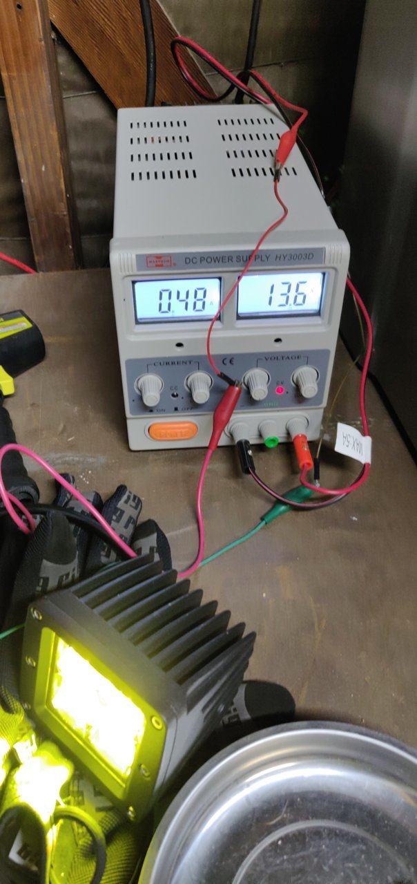

    Funny you's two's bumped this thread, I just finished up some wiring in regards to the bumpers.
    Yellow pod lights for fogs. Thought hmmm, I want them to function as blinkers too. Bought an eBay fuse and relay box, worked up a xor gate (fancy way of saying like a house light two way switch) relay setup and used some OEM pins and connectors to make a kind-of-sort-of pnp setup where the fogs come on via switch, blink like blinkers when on, blink at a dimmer level when off. Wired the bar light. Still need to wire rear lights and S/C bypass to new switch.
    Shout out to paranoid fab for the sick switch mount. Need to get vid loaded of the fogs doing what I described, so stoked it worked.

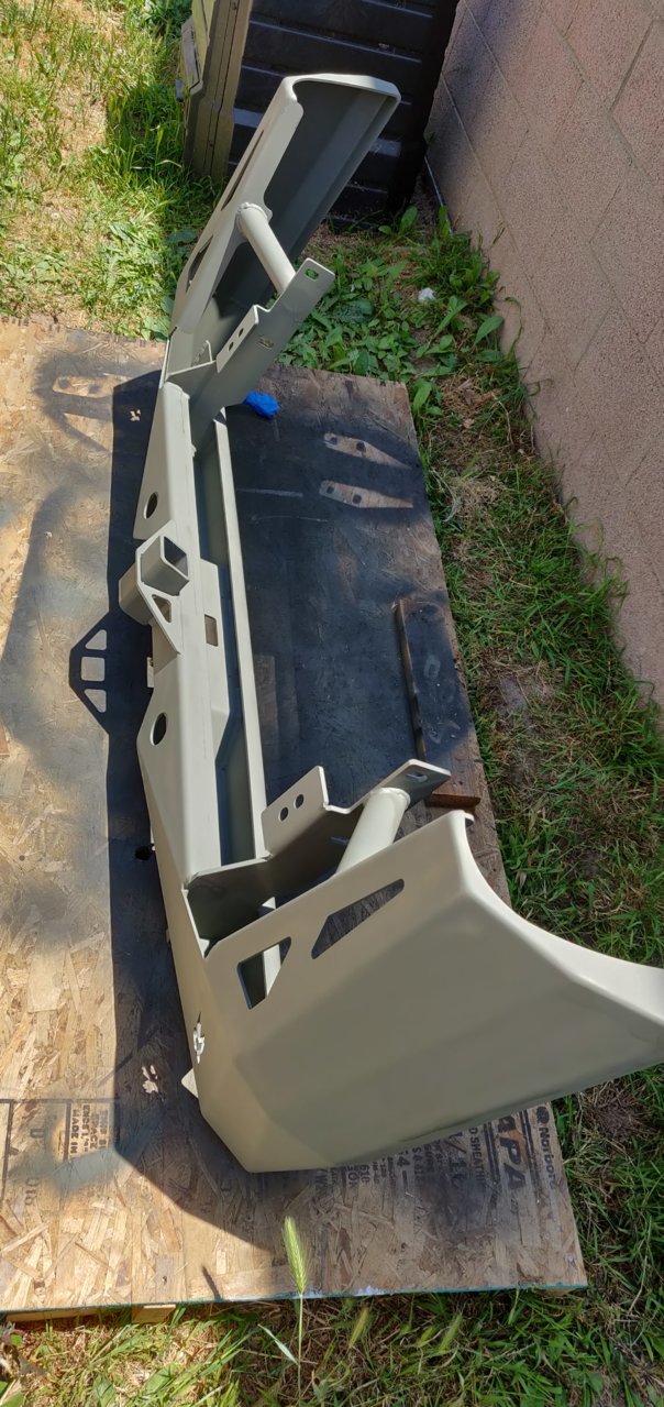

    I got the bumper 2nd hand gave it a rustoleum bed liner coat it looks awesome! so much for the big old boxy bumpers
