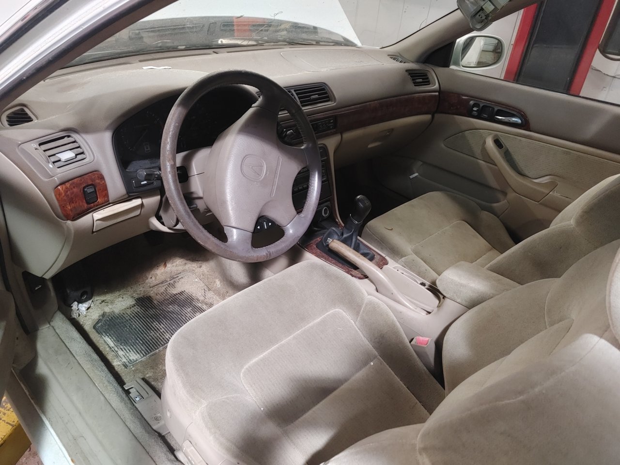

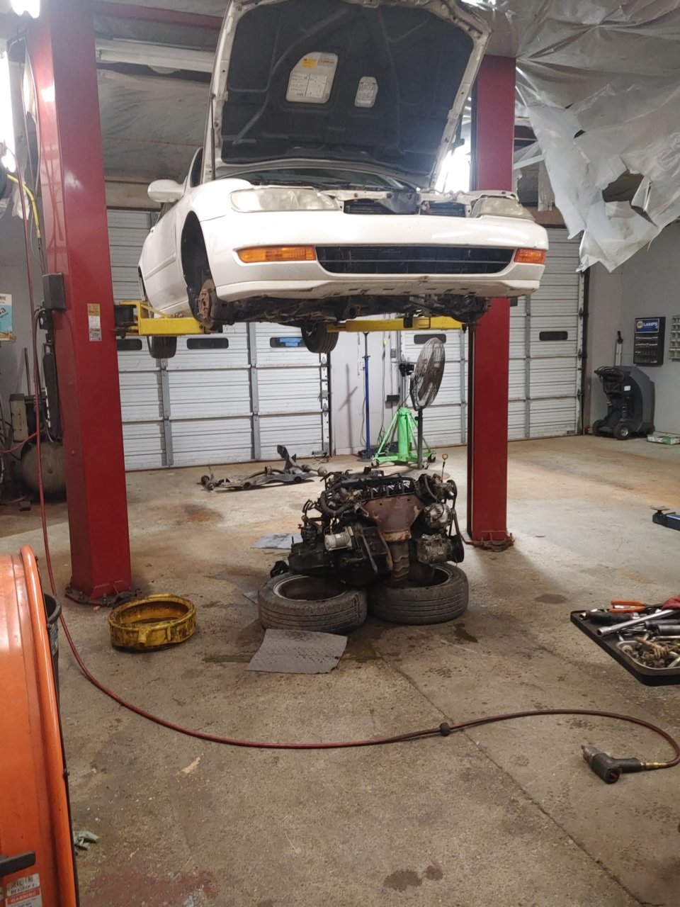

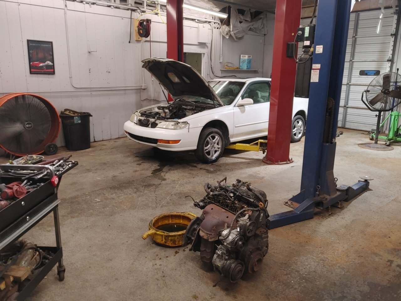

    Bought a junk 98 acura cl with a 2.3 and manual transmission to do my 5 speed swap. Unfortunately even though the cl has same engine and trans for my 99 accord, the body is based off the 94-97 accord so things like the clutch pedal, shifter, and clutch hydro line will not work.
    Went to picknpull today and found the only 98-02 accord manual I have ever seen there. Was able to get shifter, shifter cables, 5 speed ecu, and trans mount bracket. Someone had already robbed the clutch and brake pedal but easy to find on ebay.
    Took the head off the 250k engine and its not great. Going to check bottom end bearing and see what a hone will do for it. Wanting to boost after manual swap is all finished up.
    Hoping to be manual trans in a month or so.
