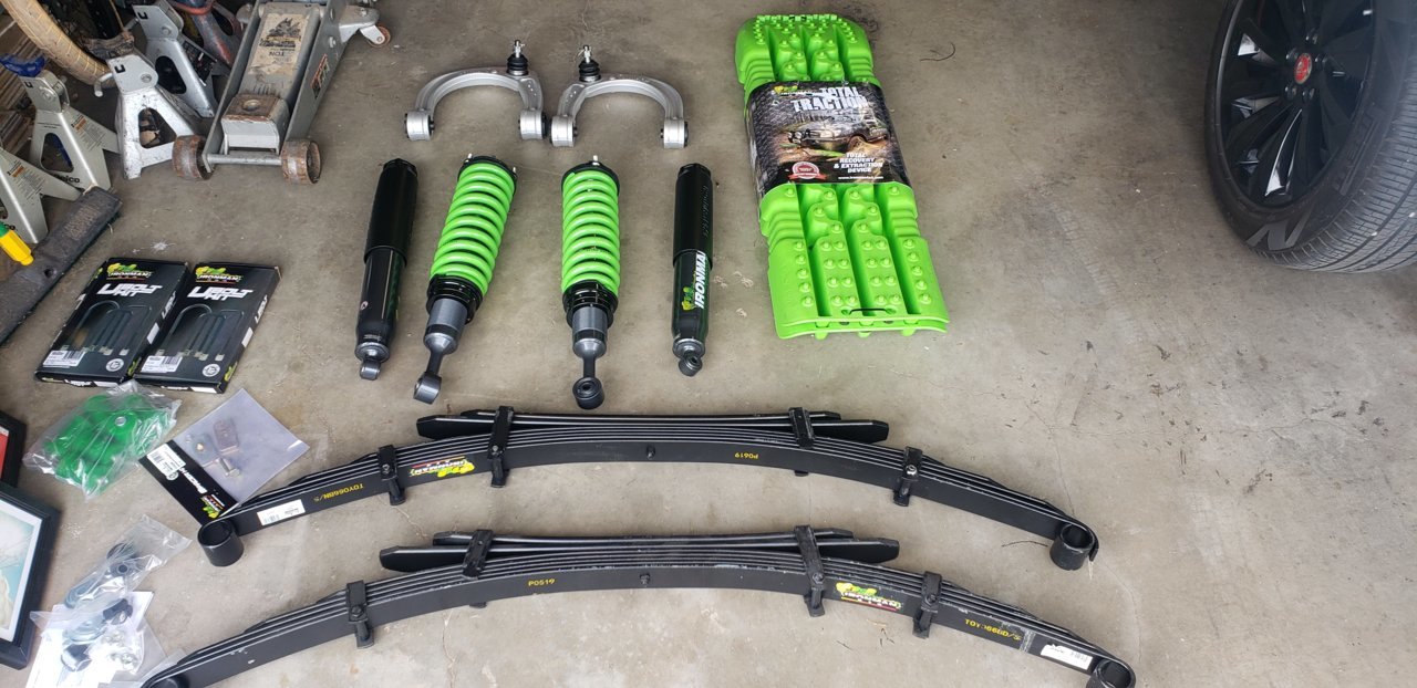

    Yes, here's my kit. I am running 265/75/16. I had them on before lift and all I did was used a heat gun to push all the plastic fender well out of the way. Now i'm pretty sure I can go 285/75/16 without rubbing, but not sure, maybe a CMC.

    There is no way I could wait that long! I picked mine up and said "screw it" and I installed it the same day. Took Me, Myself, and I 10 hours. I love it. I don't know how long it takes normally but I think I kicked its ass!!
