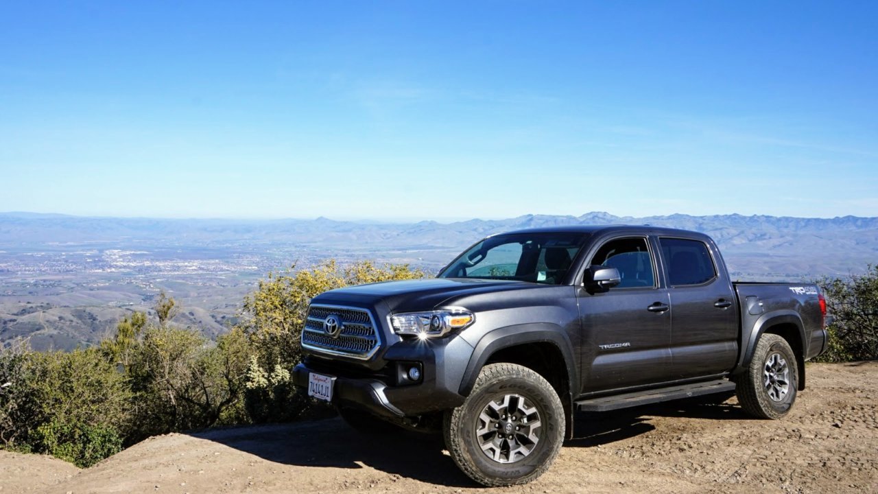

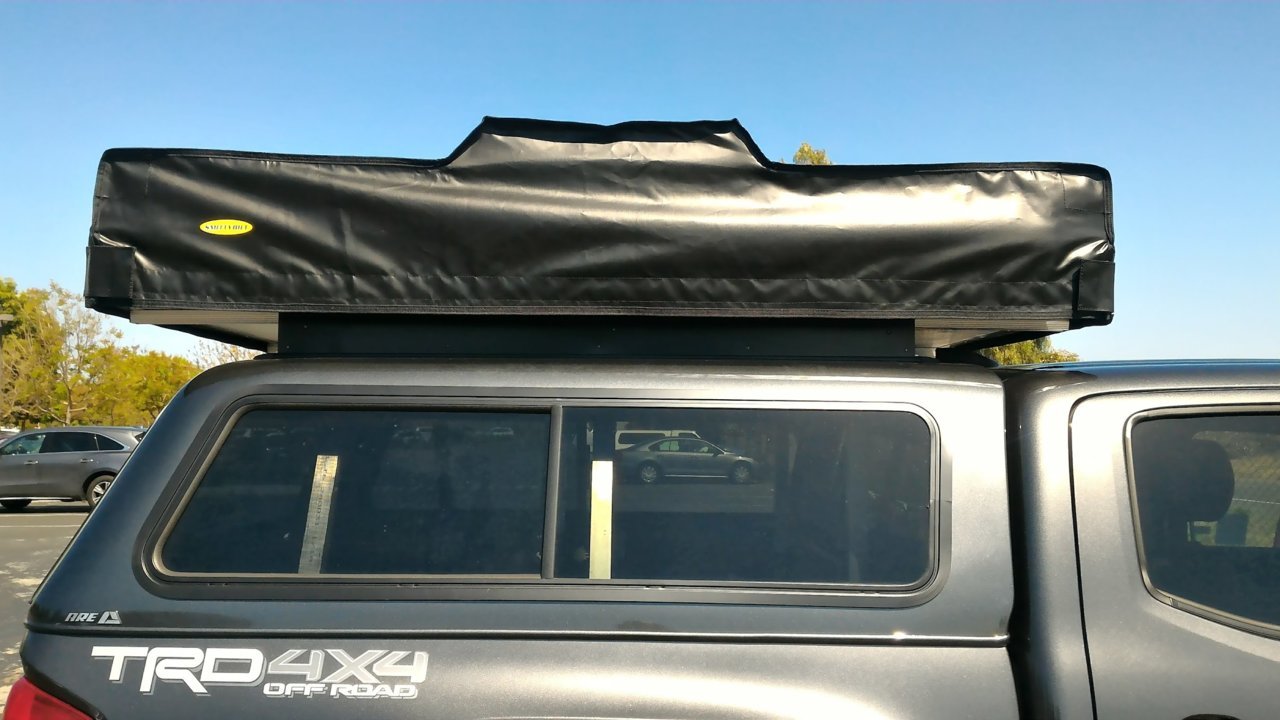

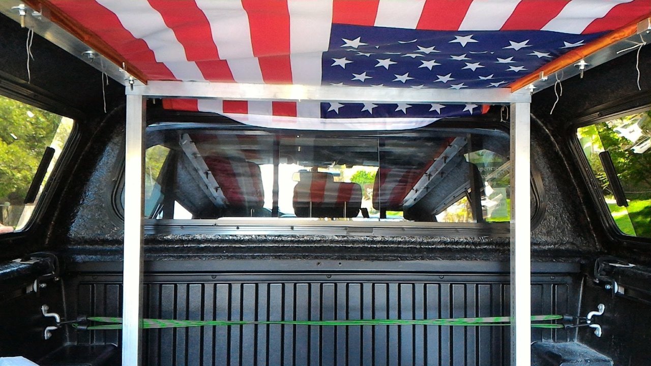

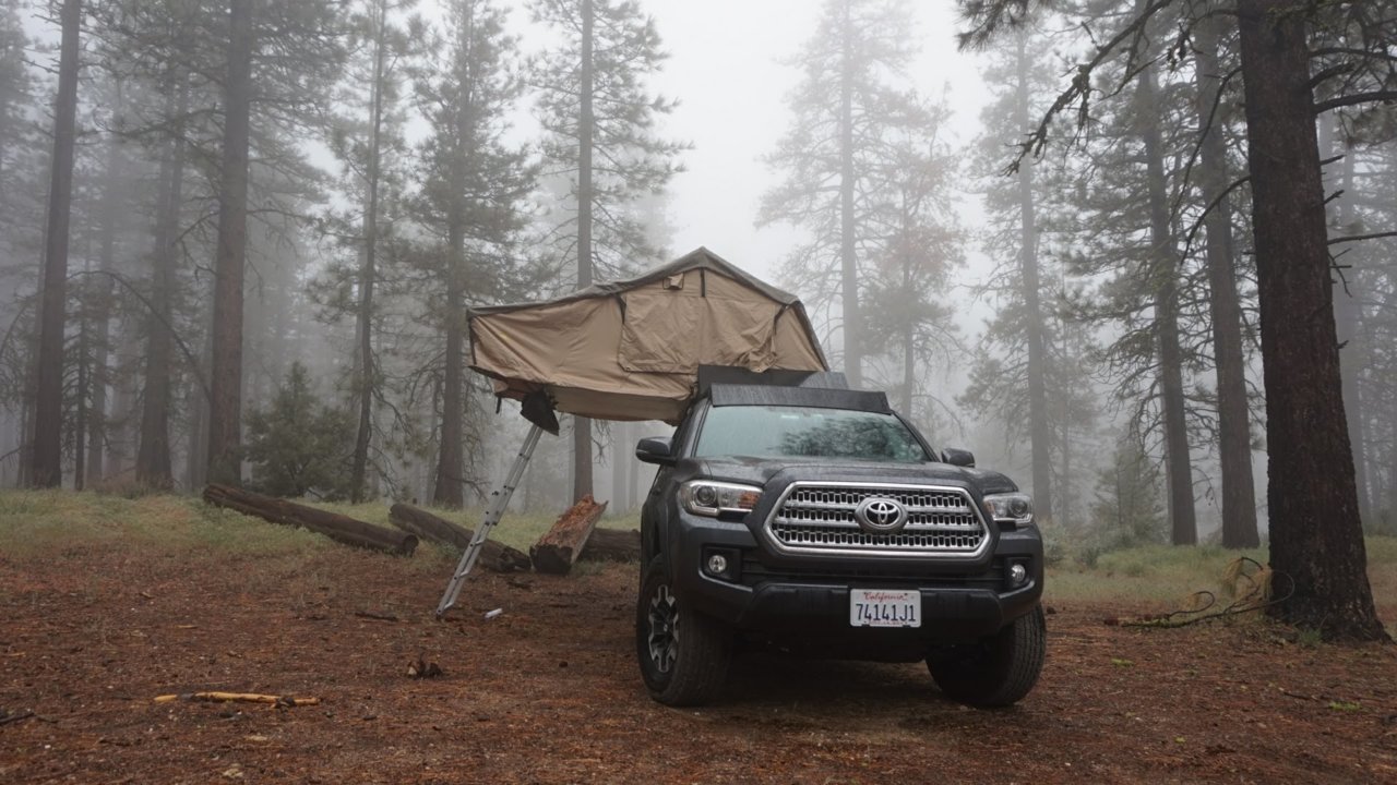

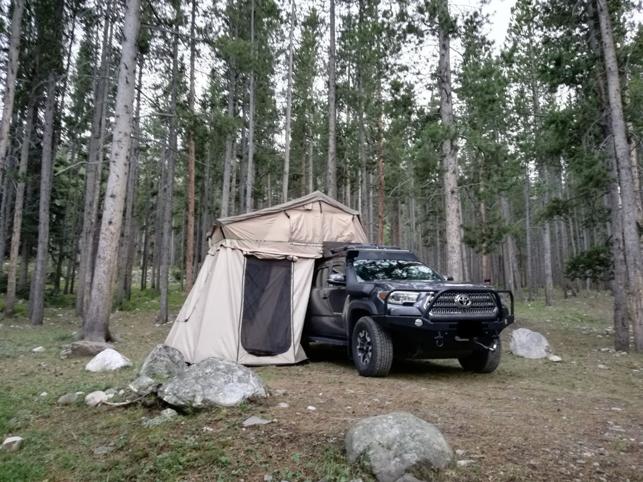

    First one was RTT and reinforcement for camper shell

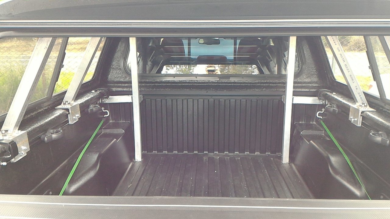

    P8trit, Blackbeard83 and irayfz6 like this.

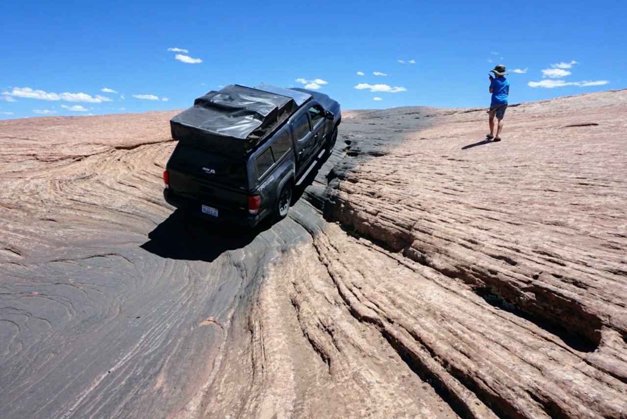

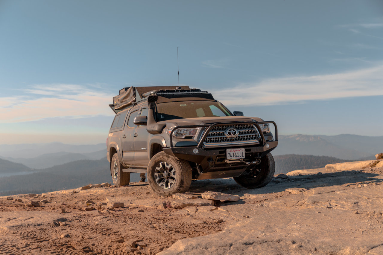

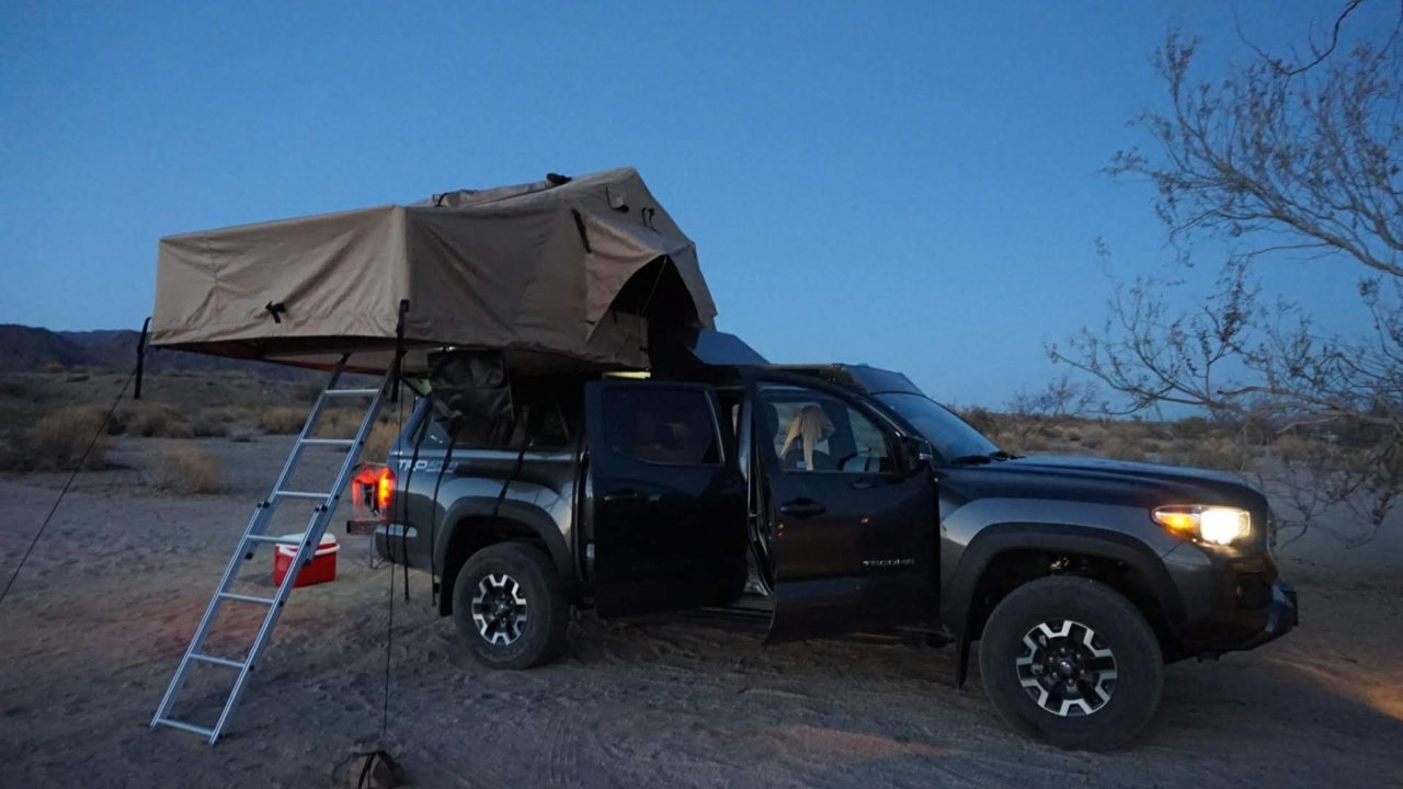

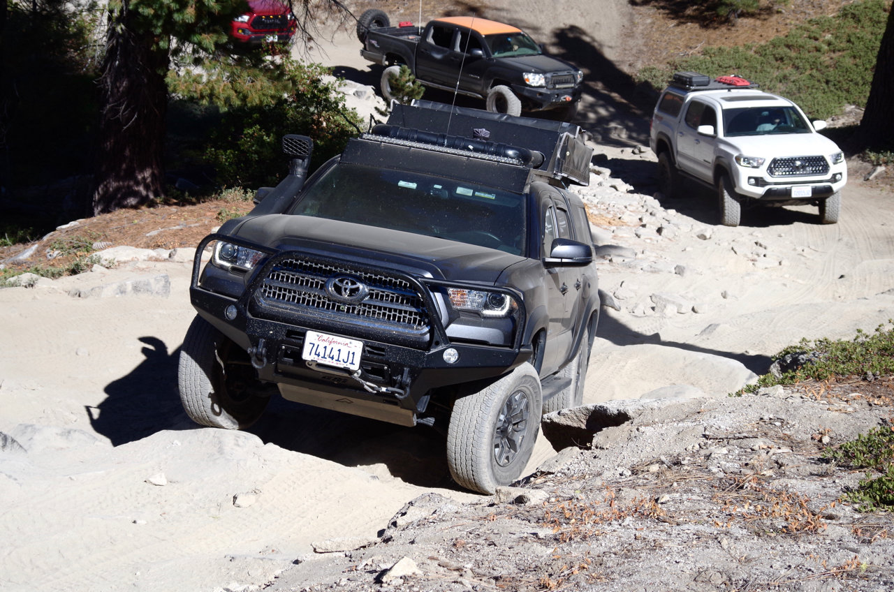

    After installing RTT, AAL and full set of aluminum skid plates it's time to travel. I did Death Valley Mengel pass, Hell's revenge and White rim trail in Moab and a lot of small trips to Shasta, Joshua tree, Mammoth lake and something like this.

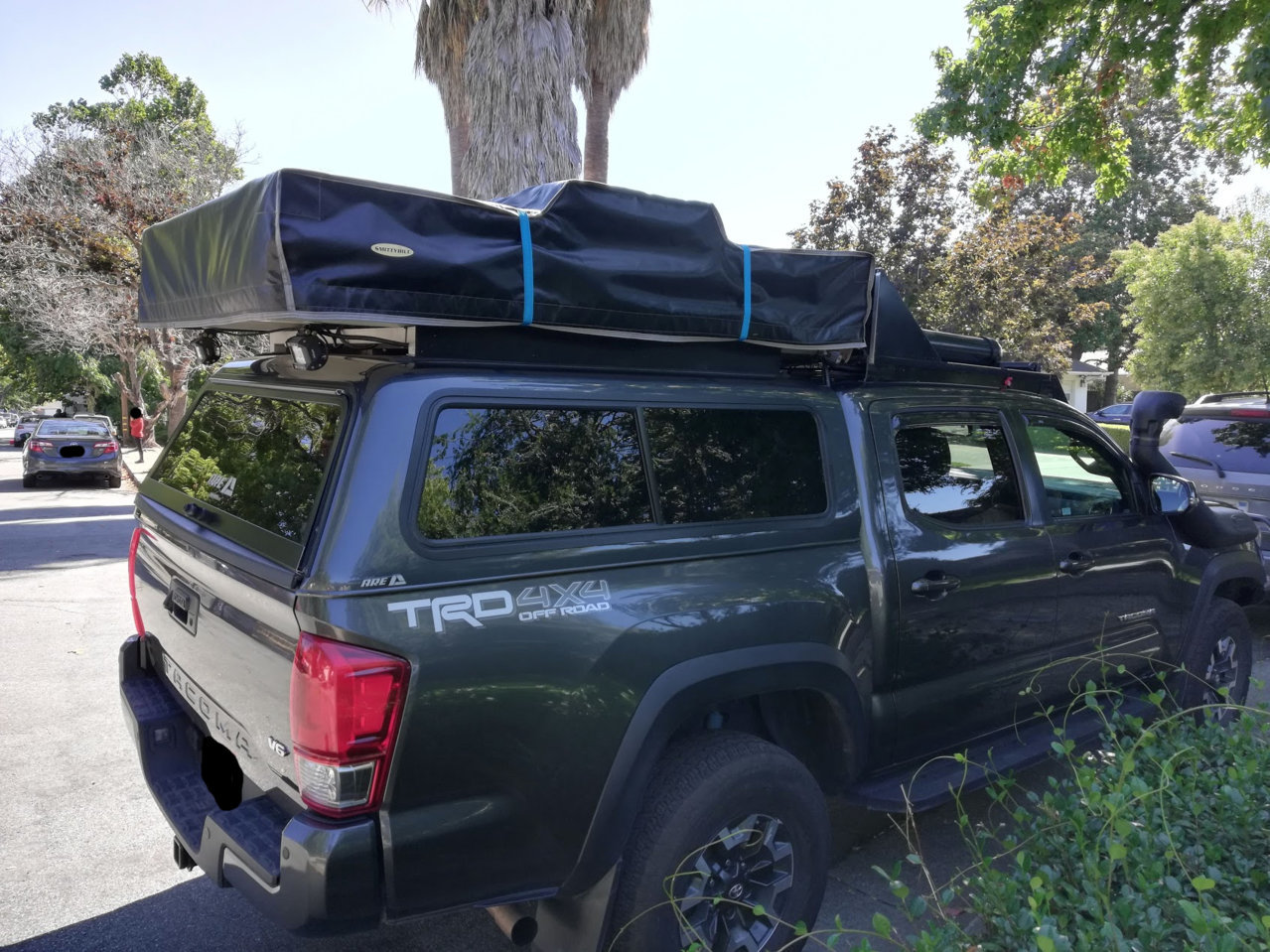

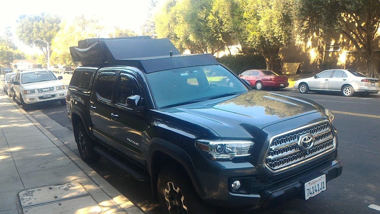

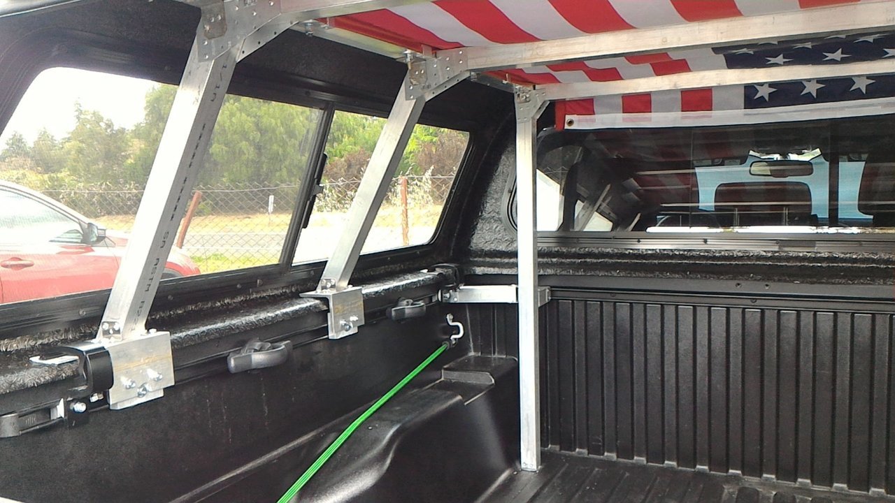

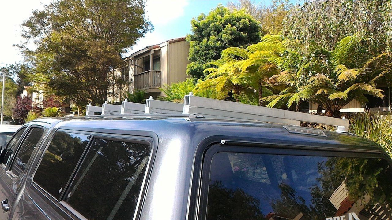

    On the cabin I have custom made roof rack with aluminum panels and awaiting a lot of stuff here.

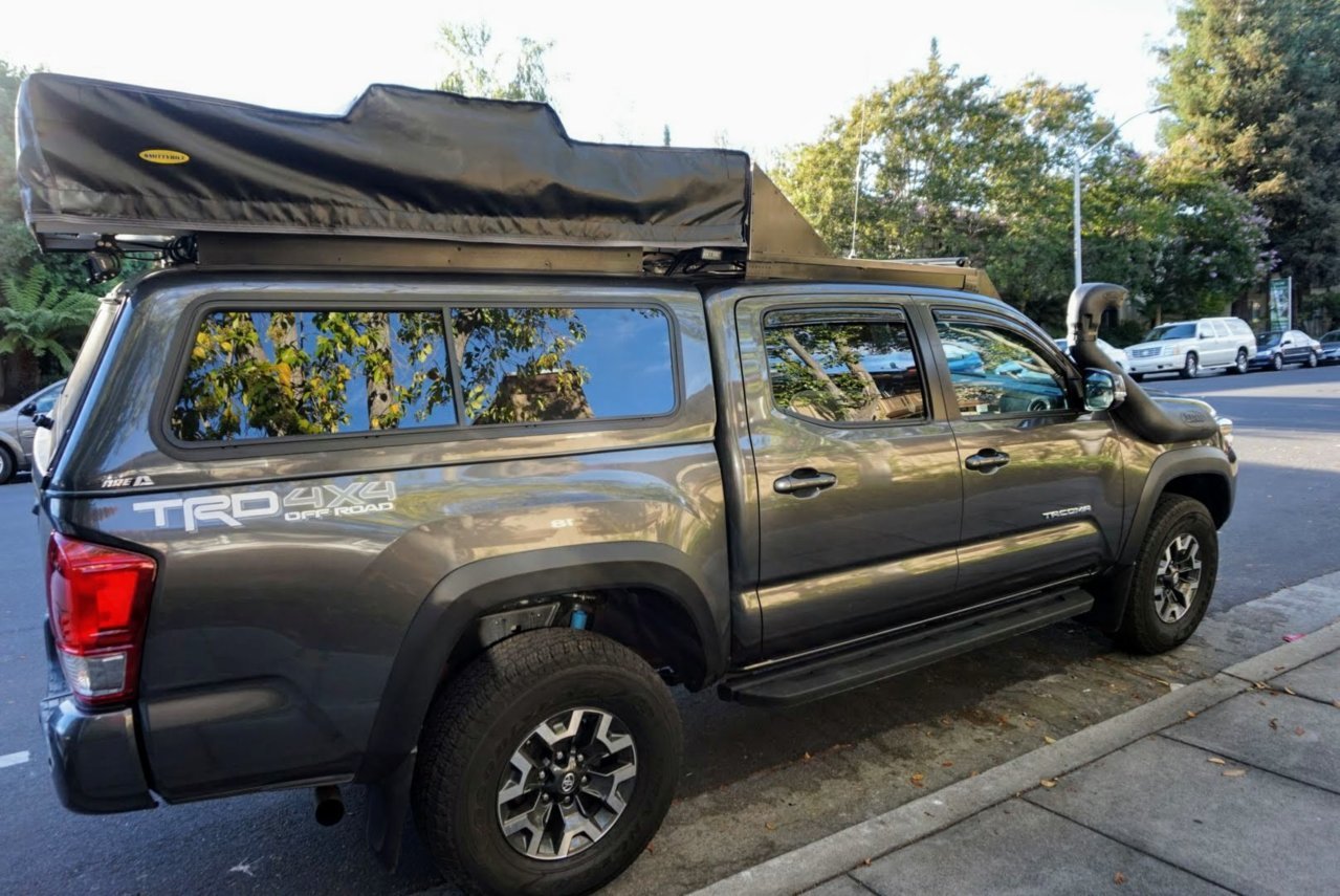

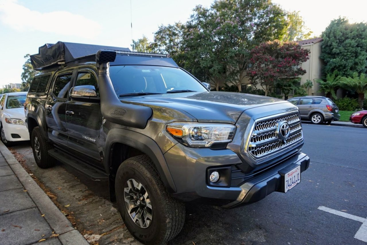

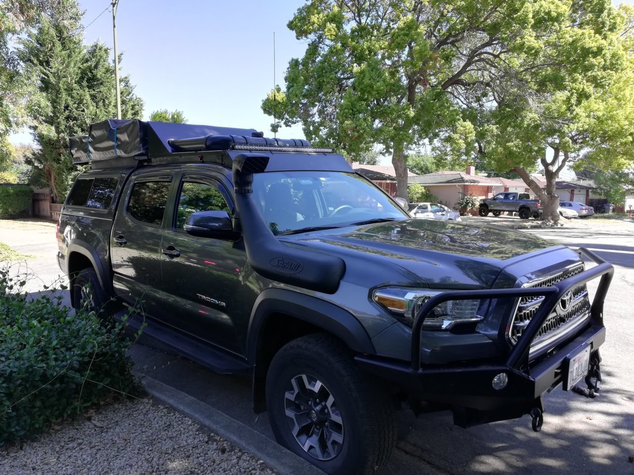

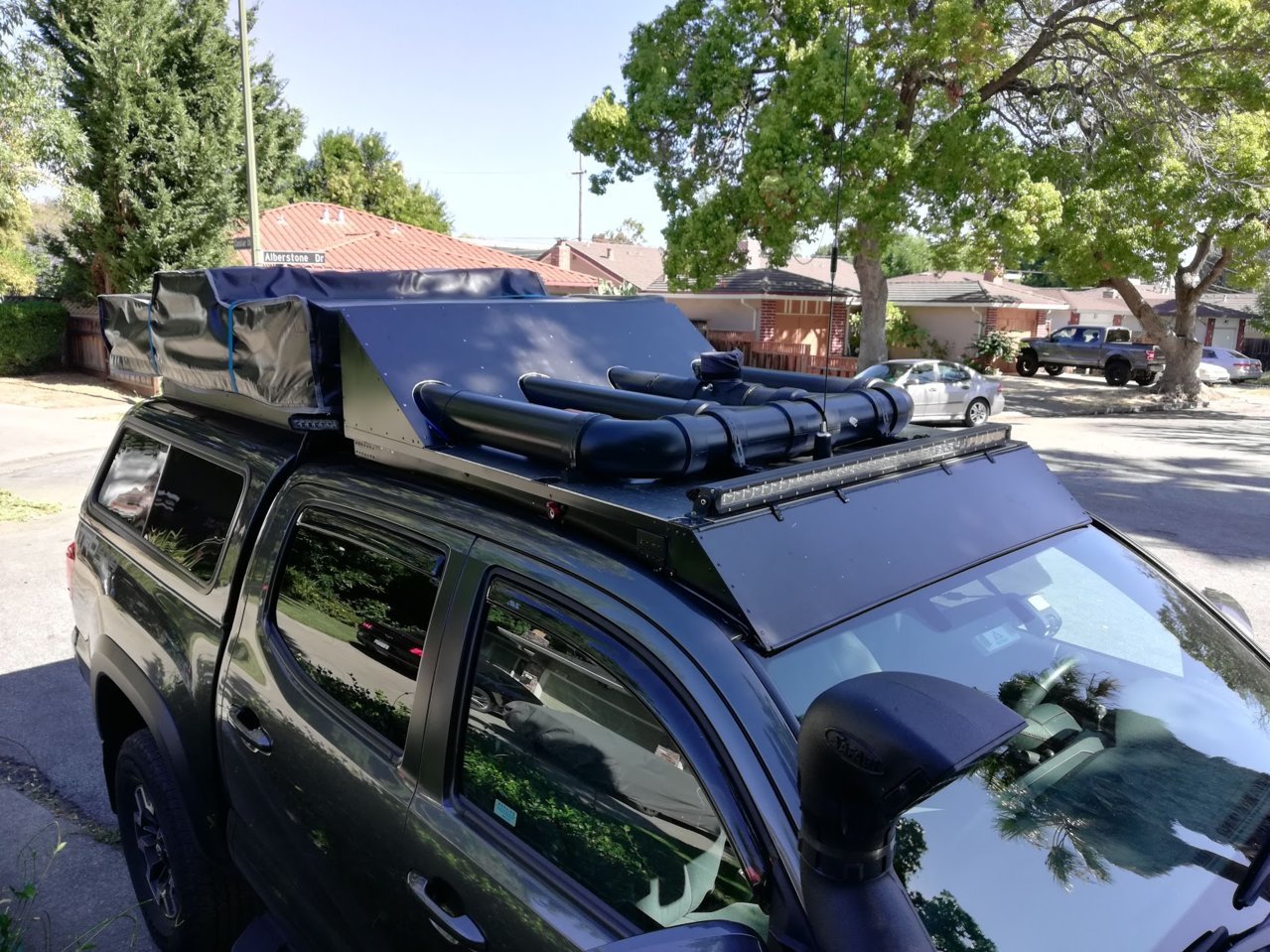

    Last updates are lights and snorkel

    To make light bars possible I built electric board inside camper shell and run welding cables 4AWG from under the hood to the camper shell. All other cables to light bars are 10/12AWG from fuse box by Blue Sea. I'm using Nilight two small bars for rear, two for sides and 41in ledbar for the front.

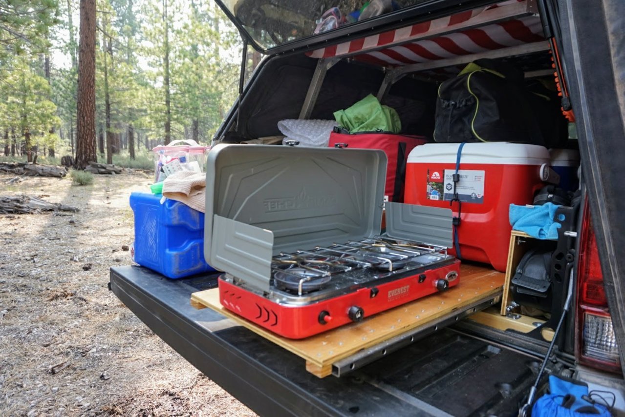

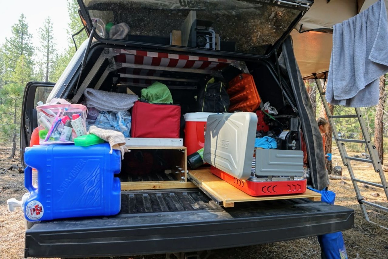

    As for camping I have kind of a kitchen made from plywood.
    Malvolio, banditcamp and Blackbeard83 like this.

    Latest update: solar shower on the cabin roof made from ABS 4" pipes glued together to shape Cyrillic letter Ш. It's pressurized by small air compressor on the roof(in the container). Just connect regular garden hose and shower is ready.

    Few camping shots
    48976871898_8343591398_o.jpg IMG_20190801_202008.jpg 48978518041_e1ddec6968_o.jpg

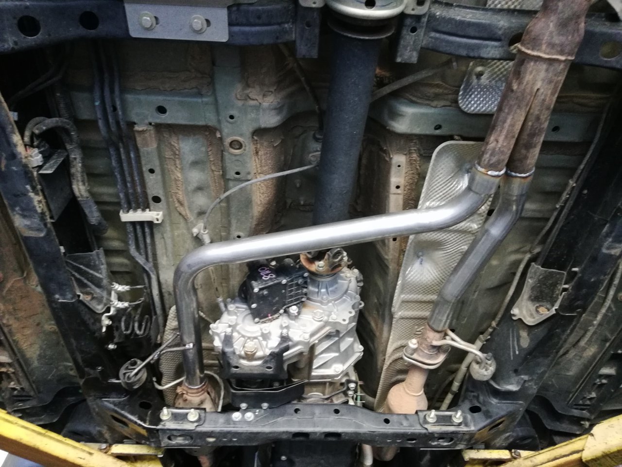

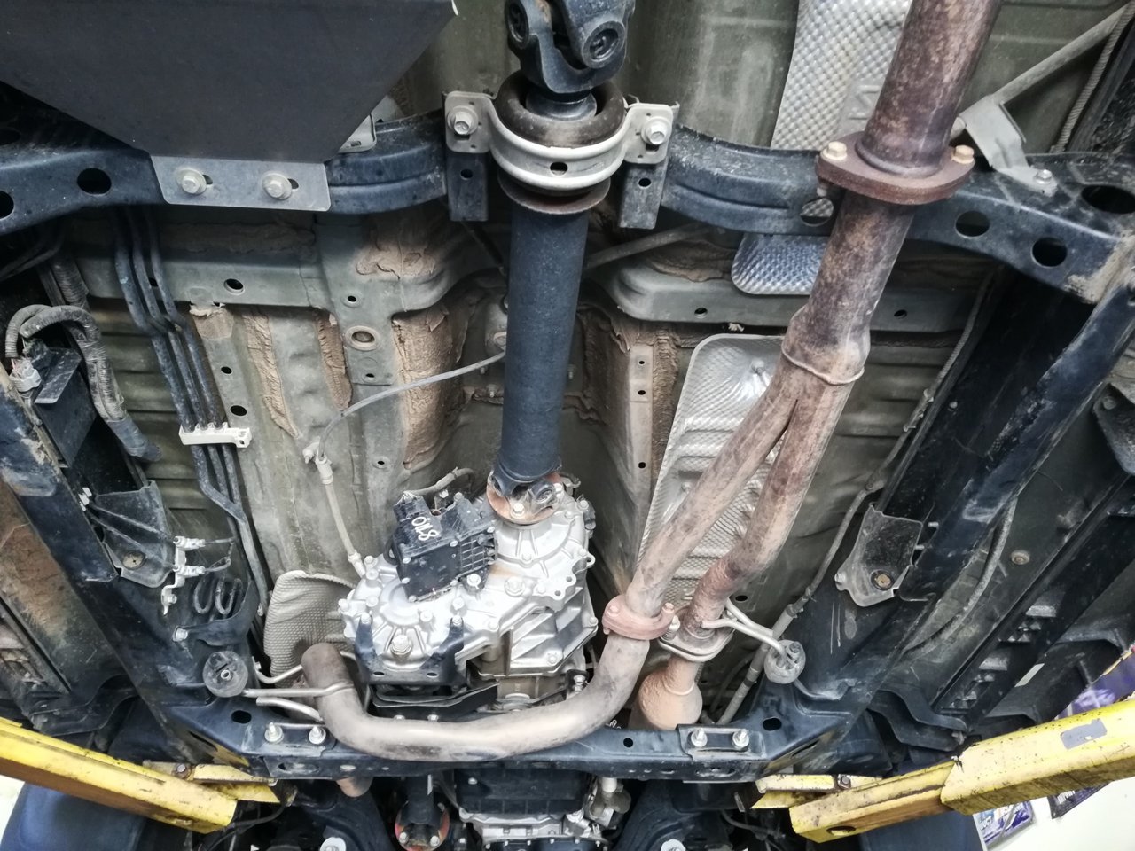

    Rerouted exhaust

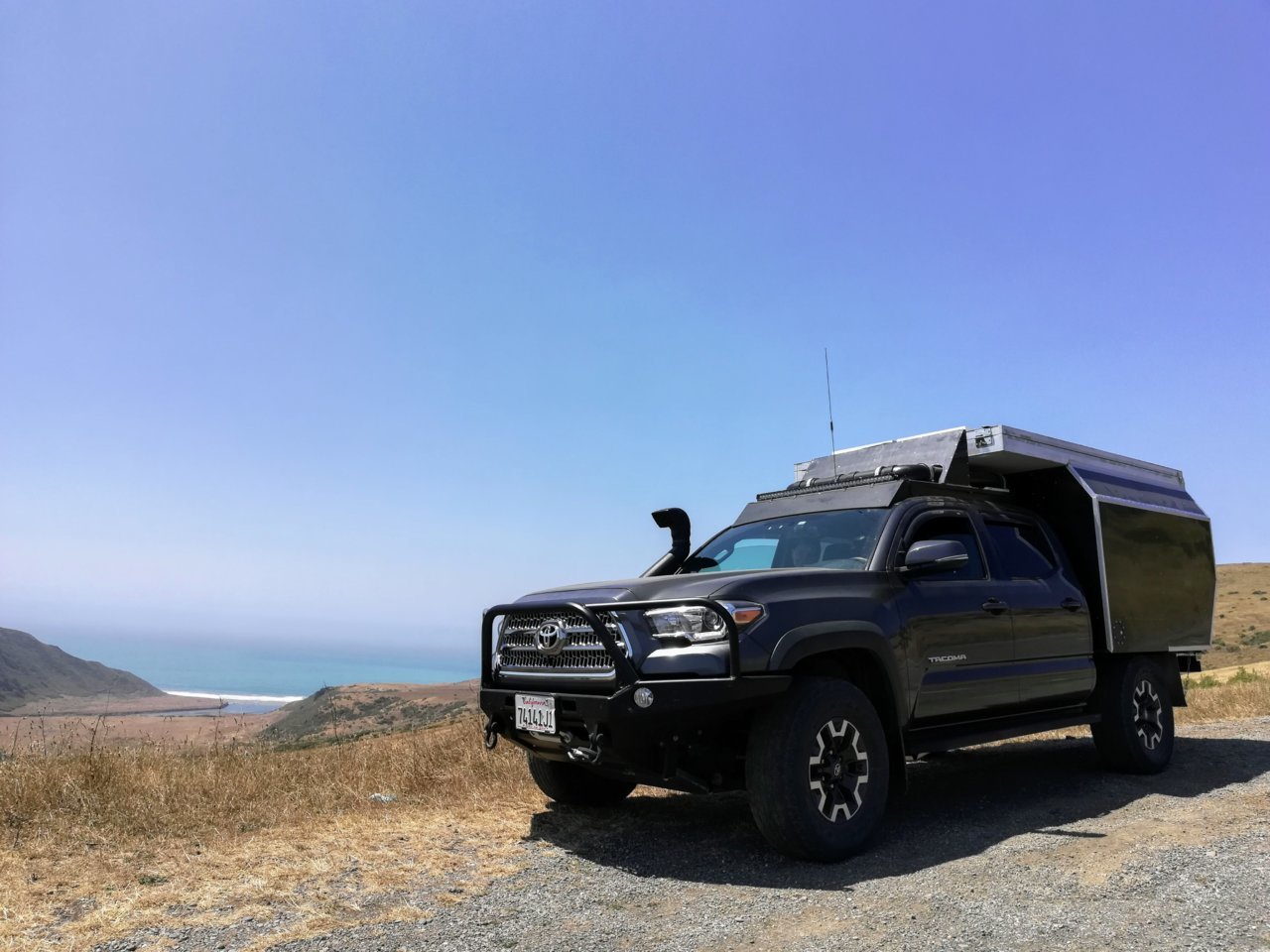

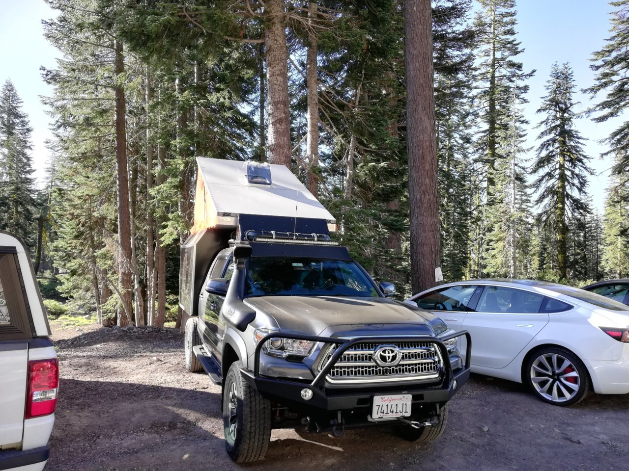

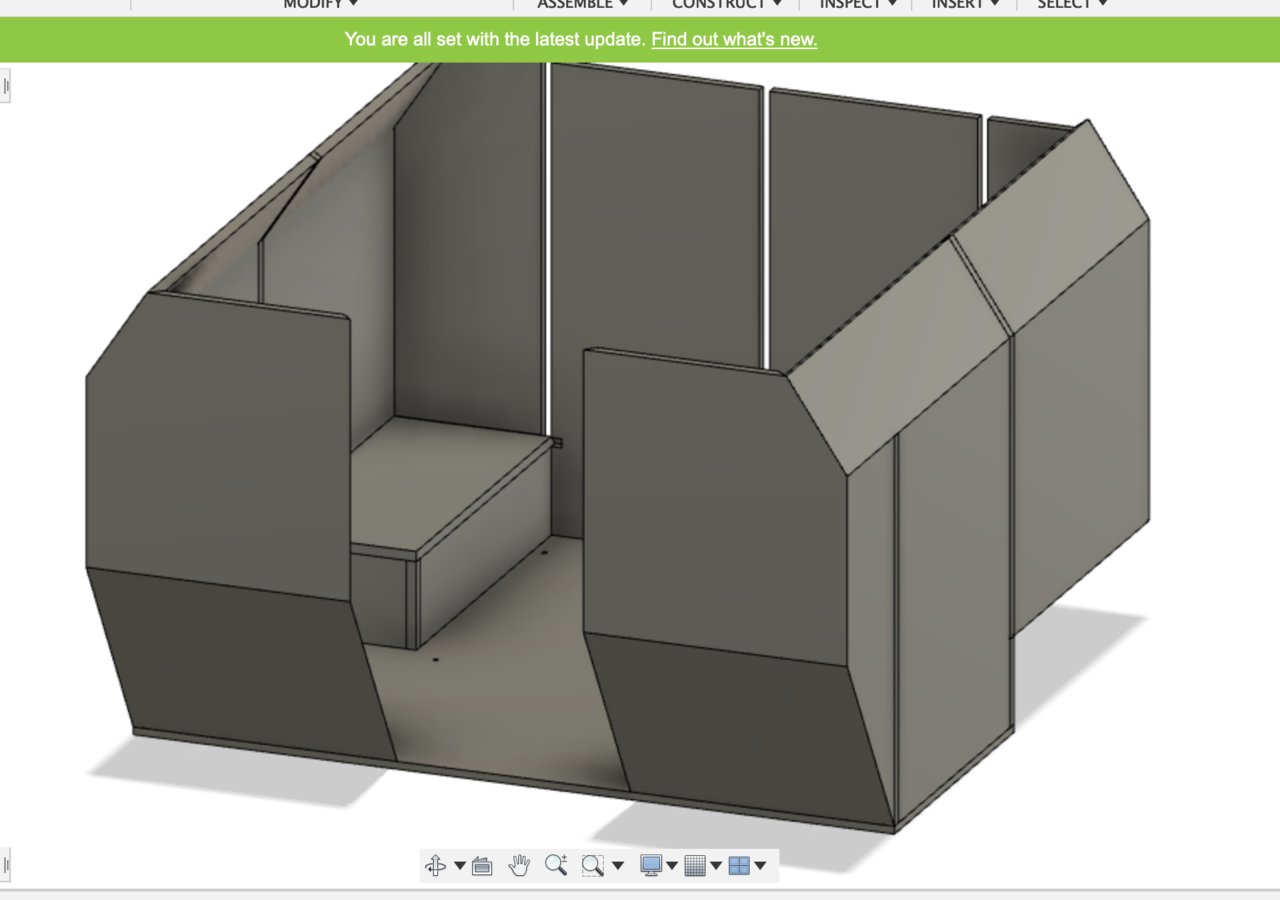

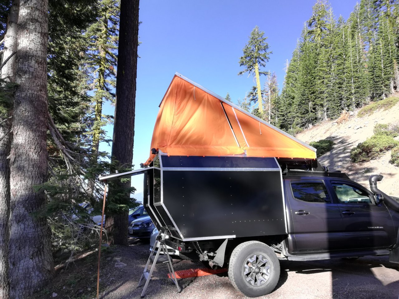

    Okay. Let me introduce a small intro as a part of the climbing video. This is about my new project to replace standard shell and RTT by DIY truck camper. I will post more info later with detailed step by step videos about how to make it.

    My new adventure across locations from my bucket list

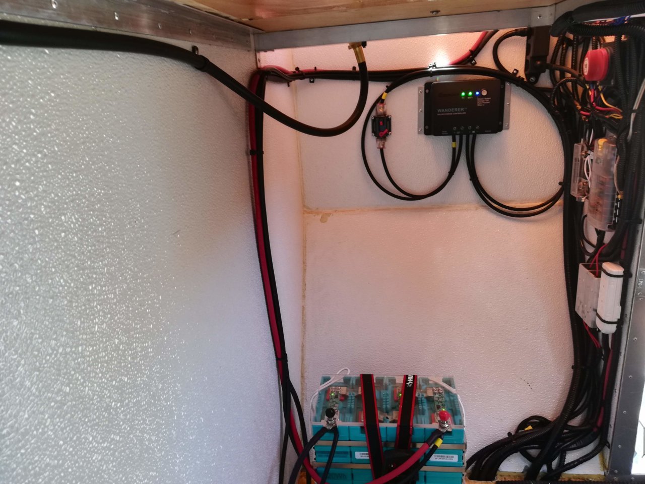

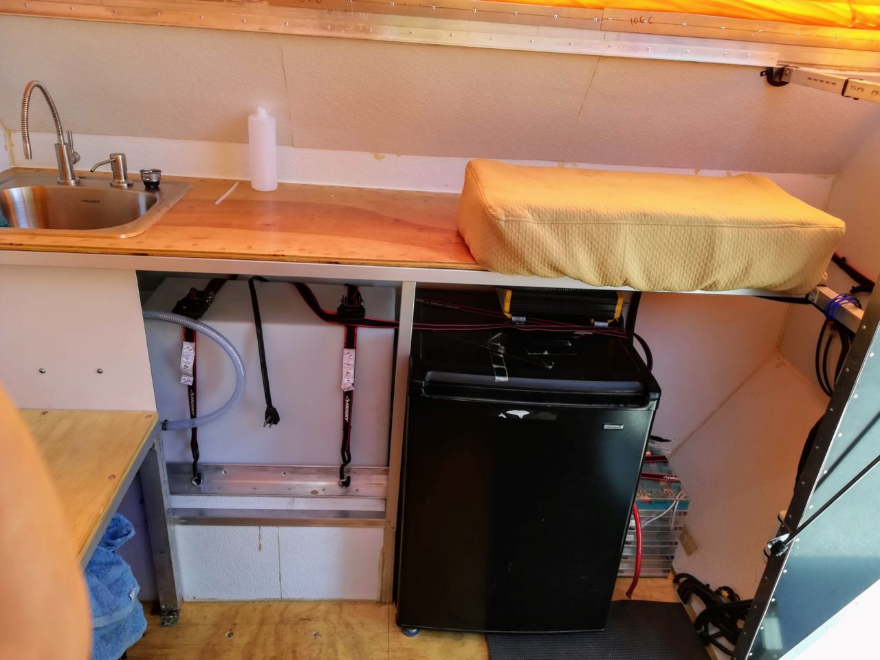

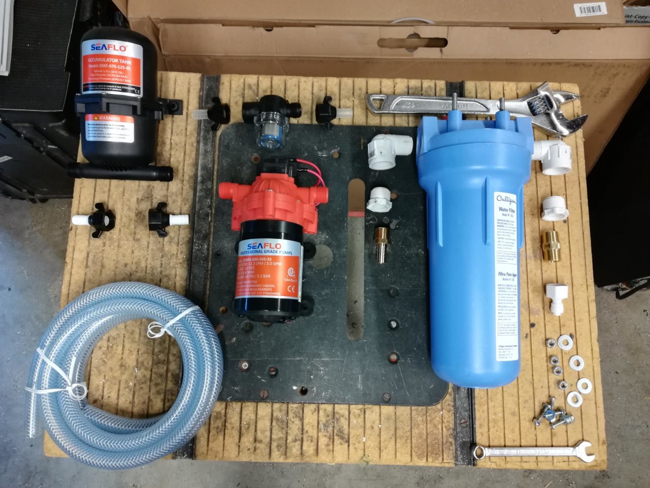

    Finished the main part of electric and plumbing. Now the only thing I need to finish is DC-DC battery charger installation. I want it to charge AUX battery only when it needs to be charged, so, trying to use Victron BP-100, it has smart output.

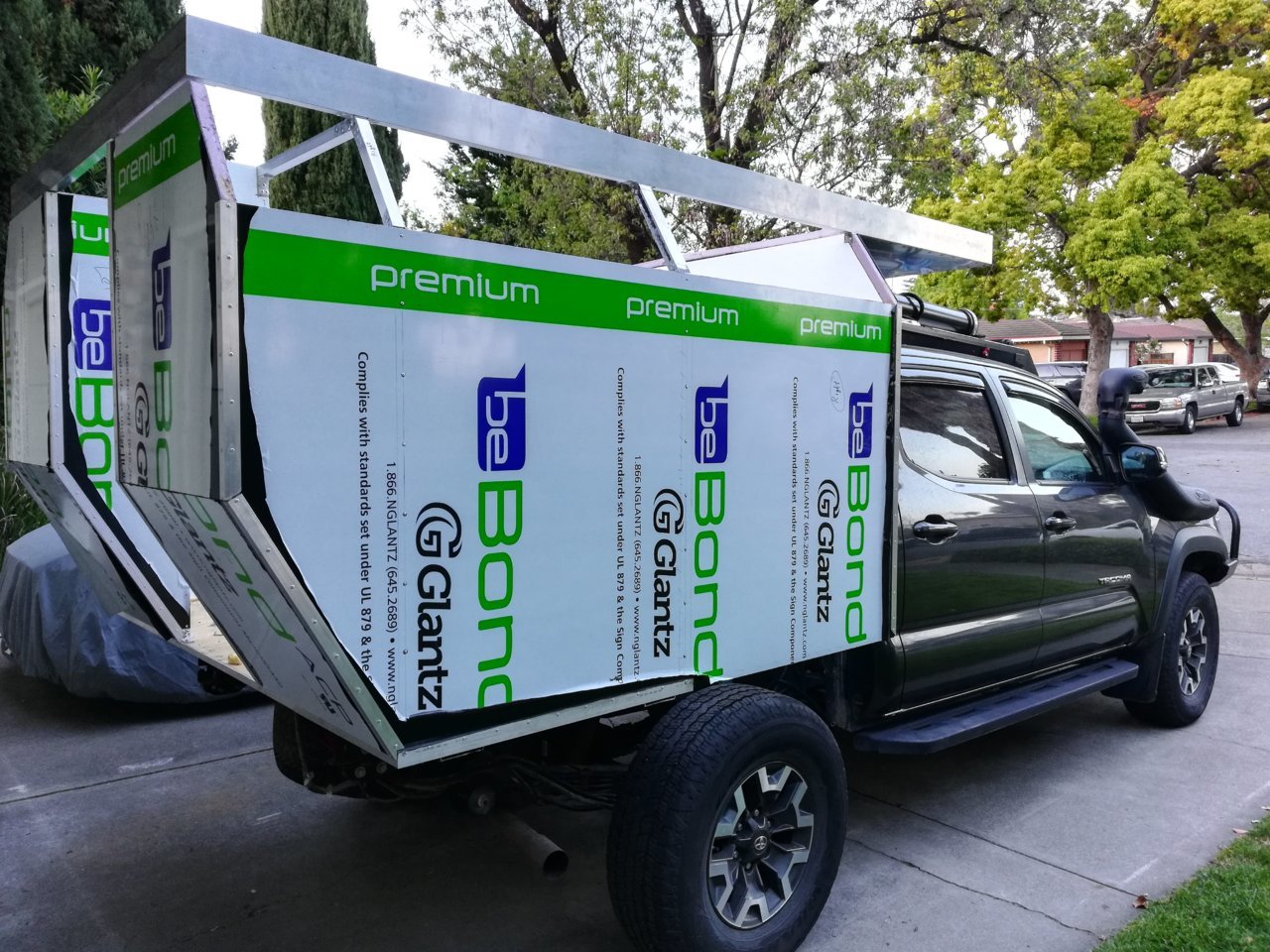

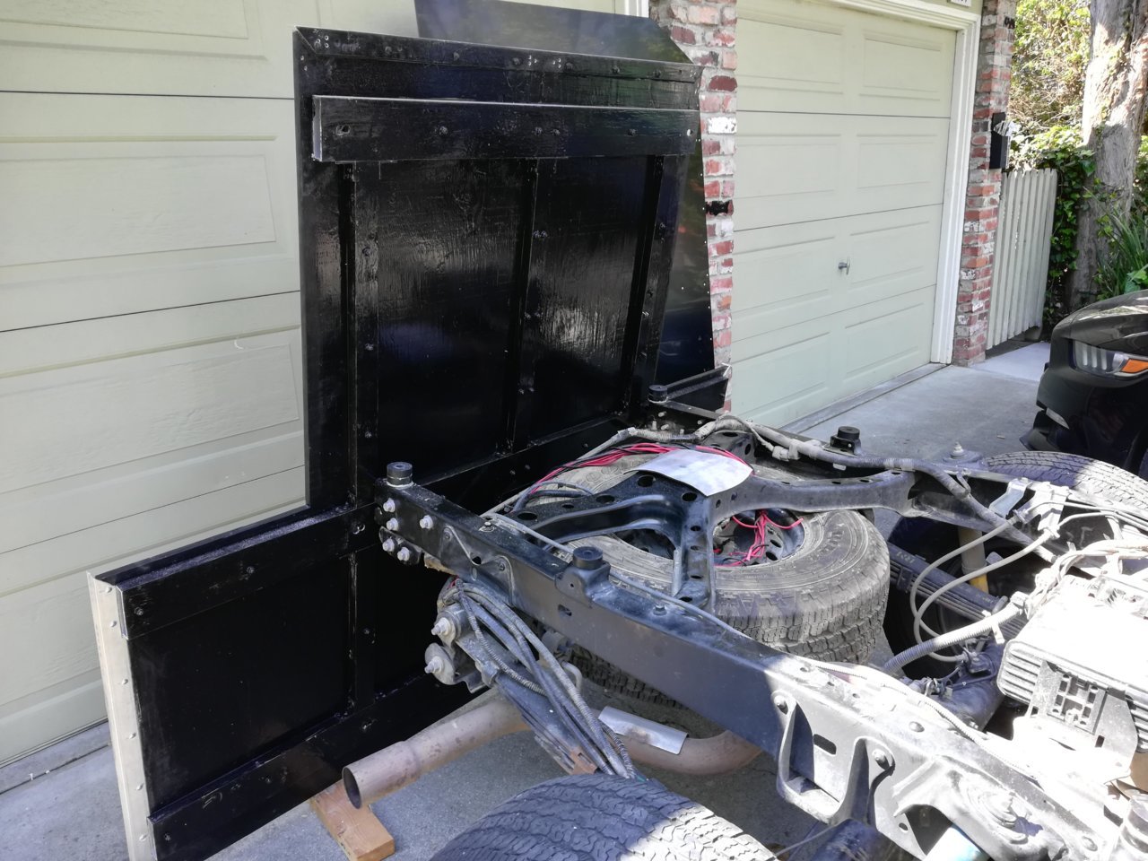

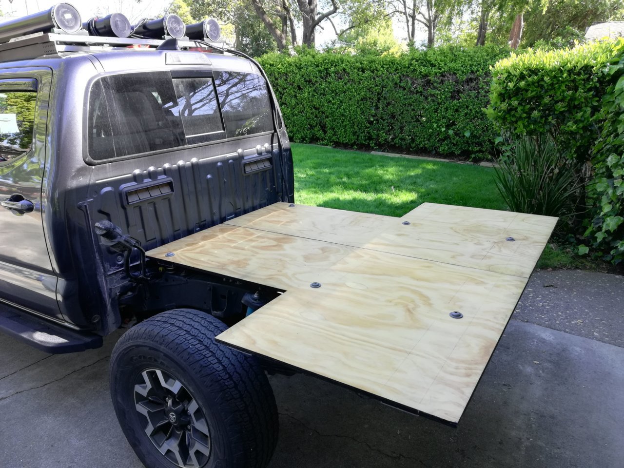

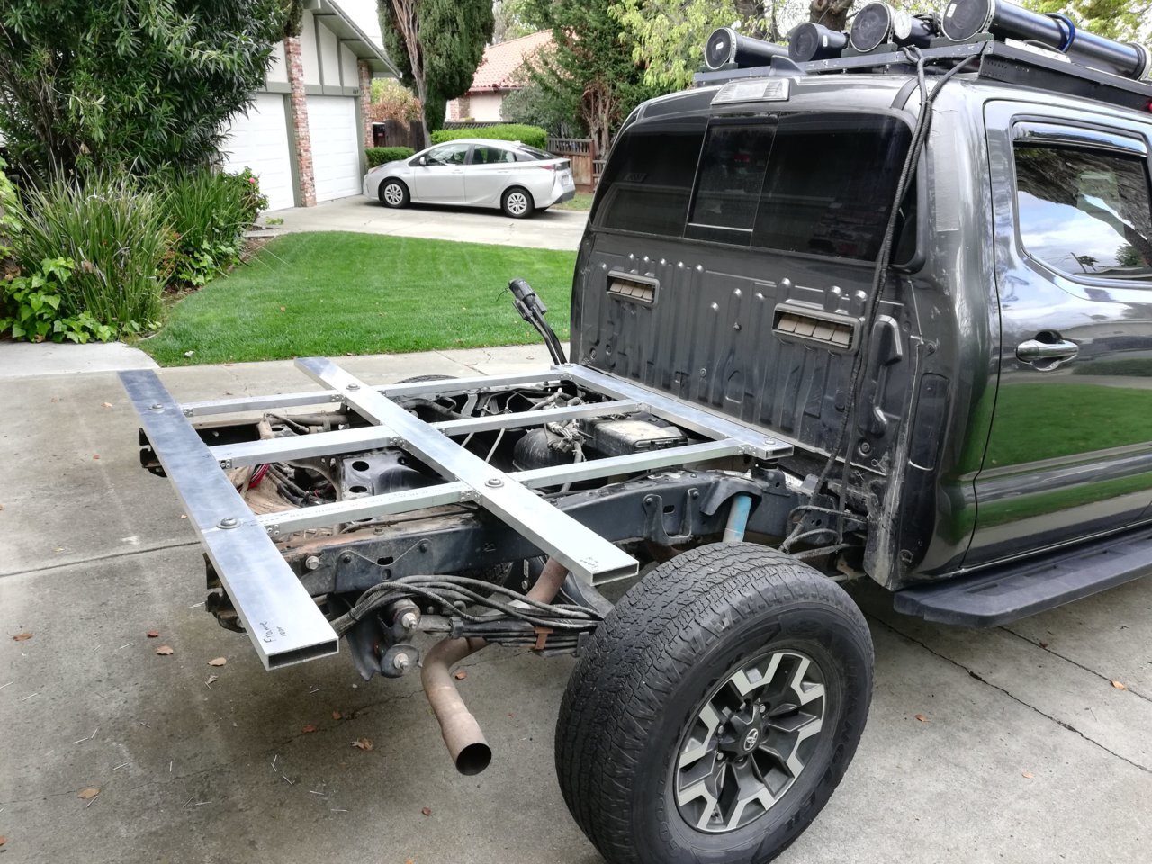

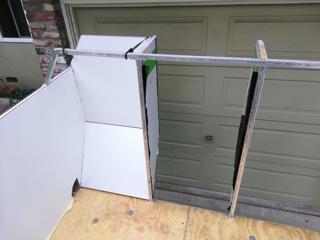

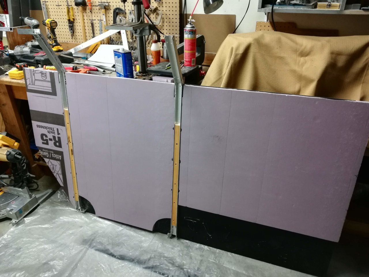

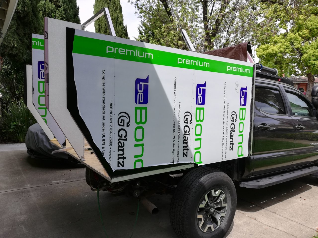

    Some details about the basement. I used aluminum sq tubes 1x4 and plywood. Just glued/screwed together and install. For protection, I used Flex Seal rubber for the outside and polyurethane for the inside.

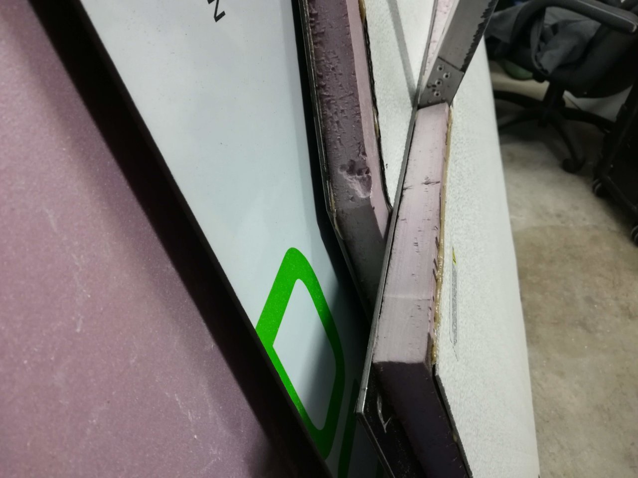

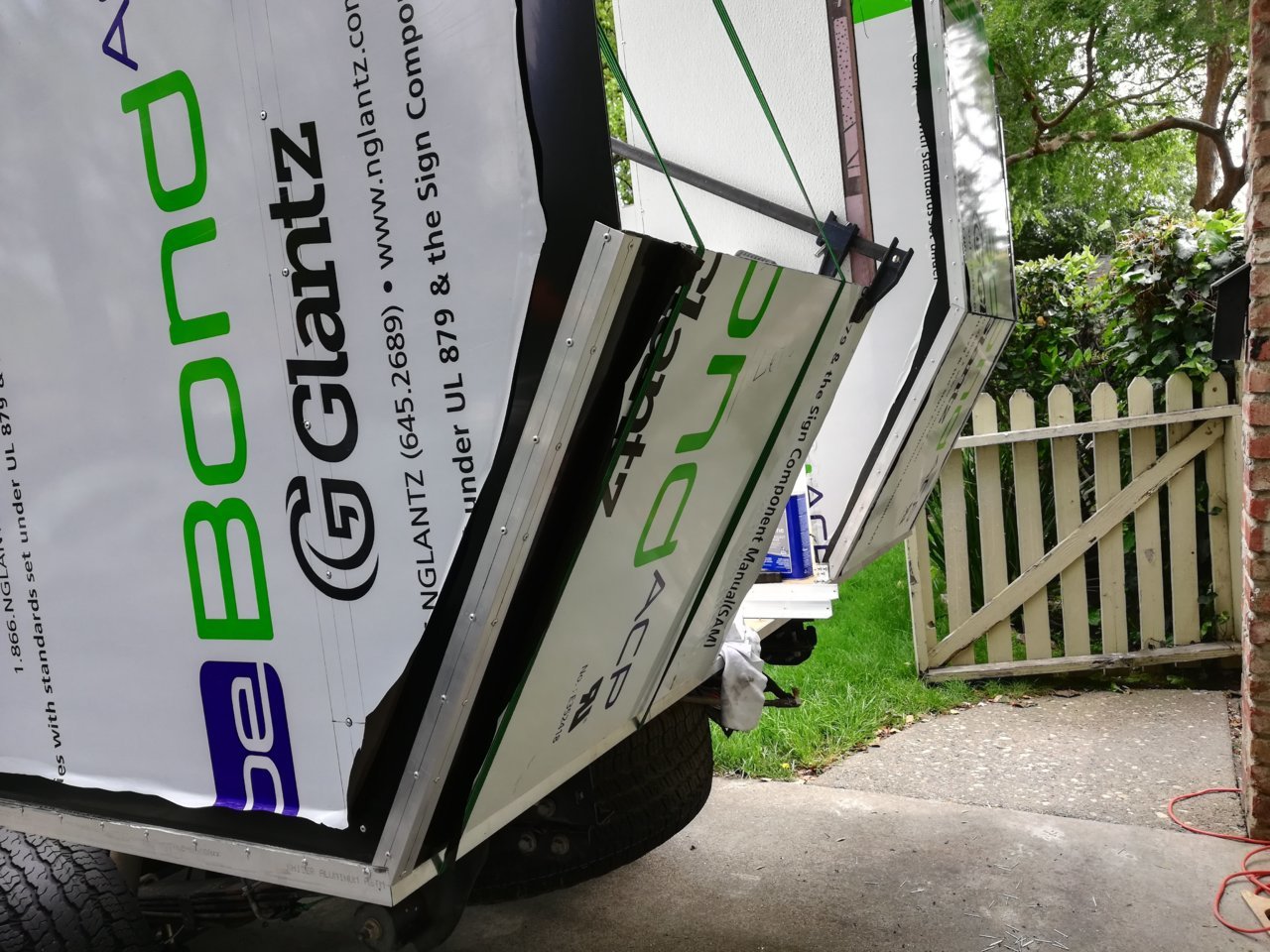

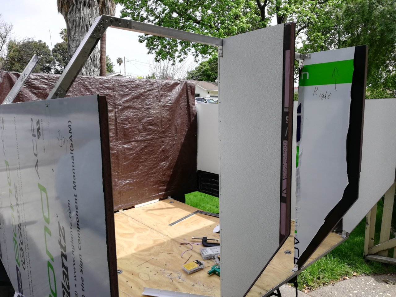

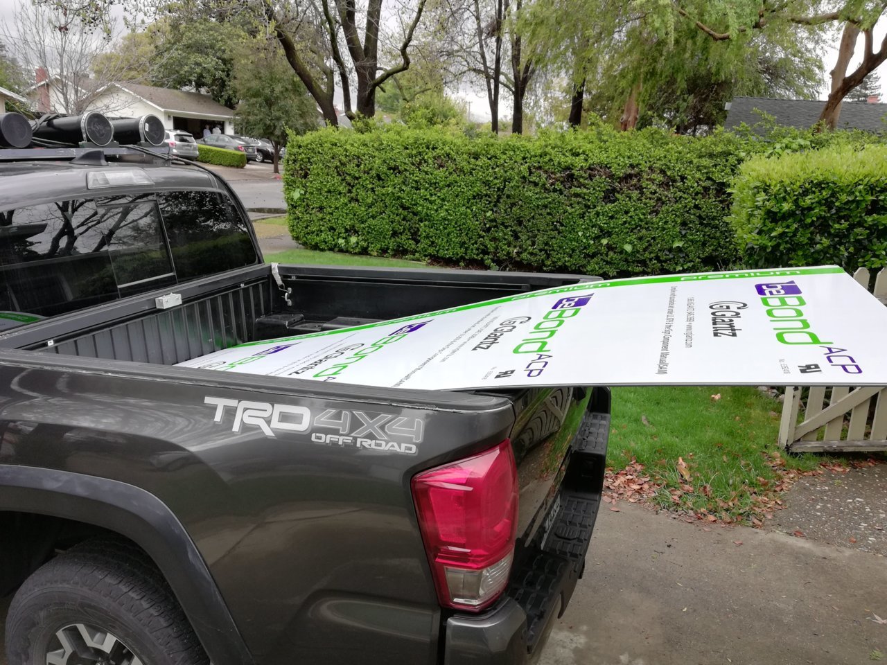

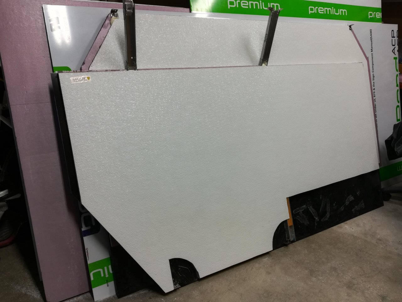

    The walls are my own composite: beBond, XPS, FRP. The frame is 1x1 aluminum tubes. Wooden inserts for the interior mount point.
