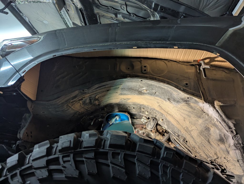

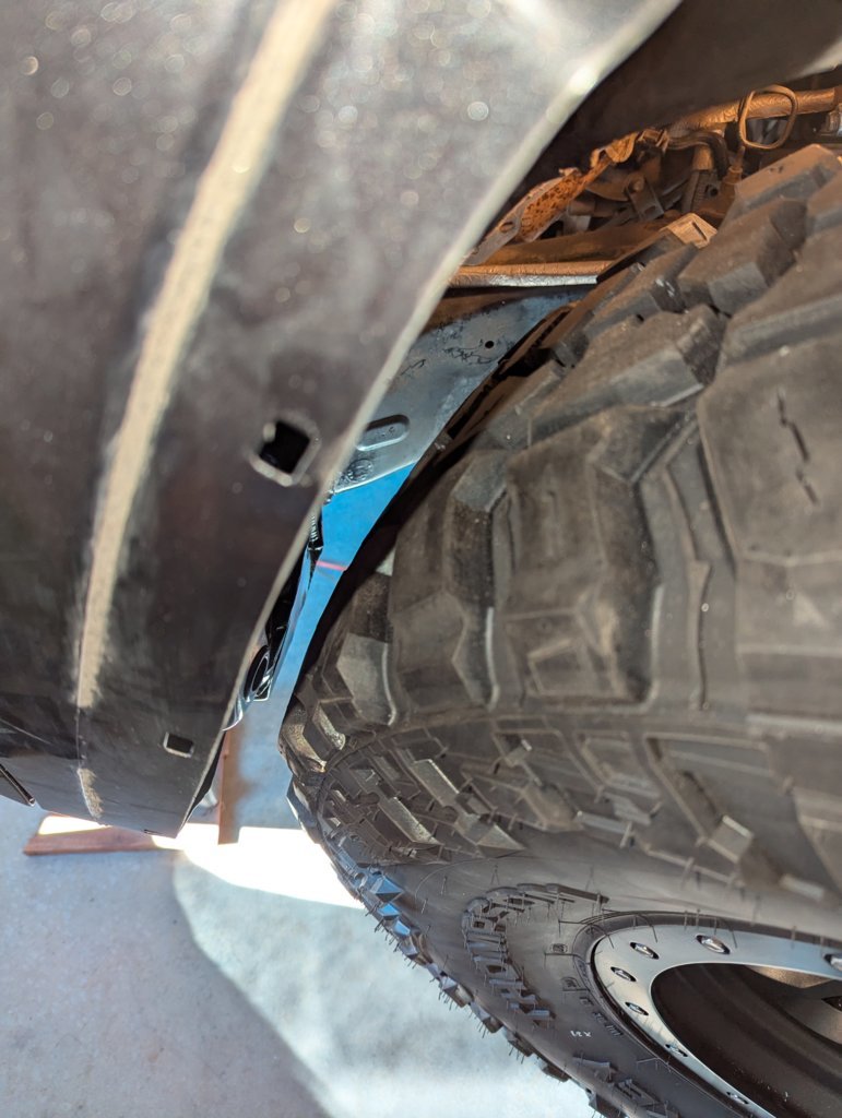

  1. Jan 13, 2025 at 10:46 AM
    #81
    essjay
    essjay Part-Time Lurker
    Nov 29, 2018
    #274276
    3,203
    Concord, CA
    2011 Tacoma SR5 (V6/AC/4WD)

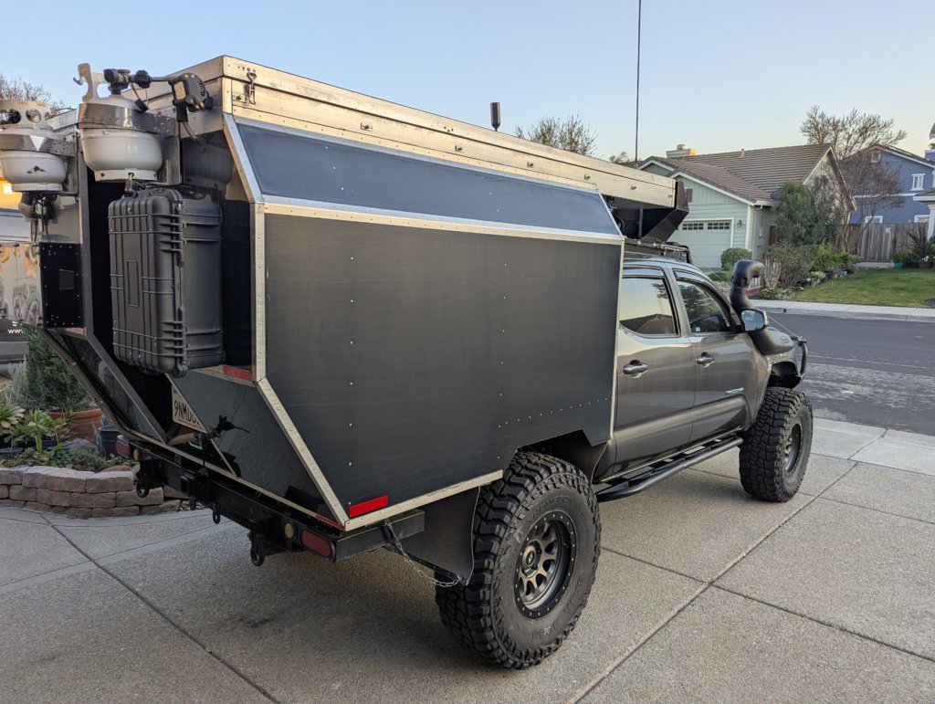

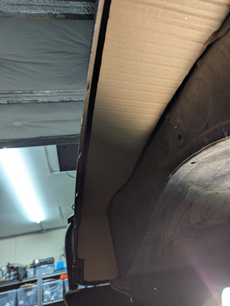

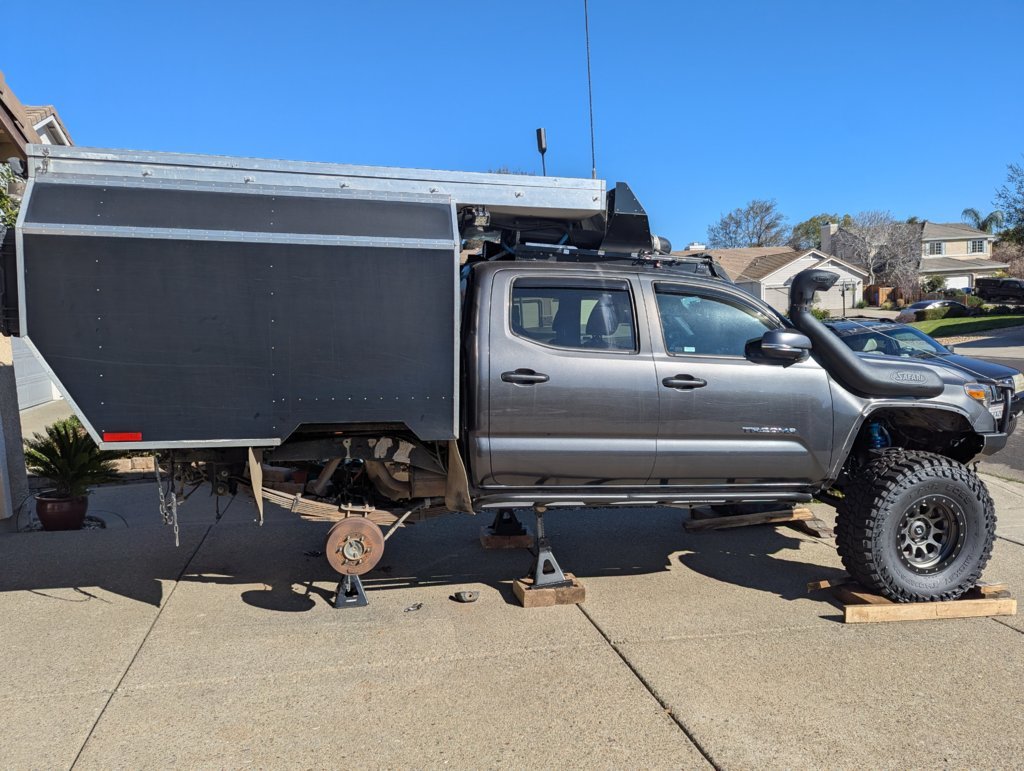

    Are you modifying the camper to add a wheel well, or lifting the rear more? It looks like you're going to have extremely limited travel in the rear with those new tires as it's presently set up.
  2. Jan 13, 2025 at 11:36 AM
    #82
    realsystem
    realsystem [OP] Well-Known Member
    Nov 7, 2017
    #235356
    511
    Stanislav
    SF Bay Area, CA
    2017 MGM Tacoma TRD OR DCSB | 2021 Cement Tundra SR5
    LT,37s,5.29,Kings,Camper,Deavers,snorkel,winch,CVCtune
    I will cut the outside arch on the camper side(very easy) and lift the camper(need to fix design issue as well). Also possible contact to the camper sub frame, maybe relocation needed. It will be determined when I do flex test.

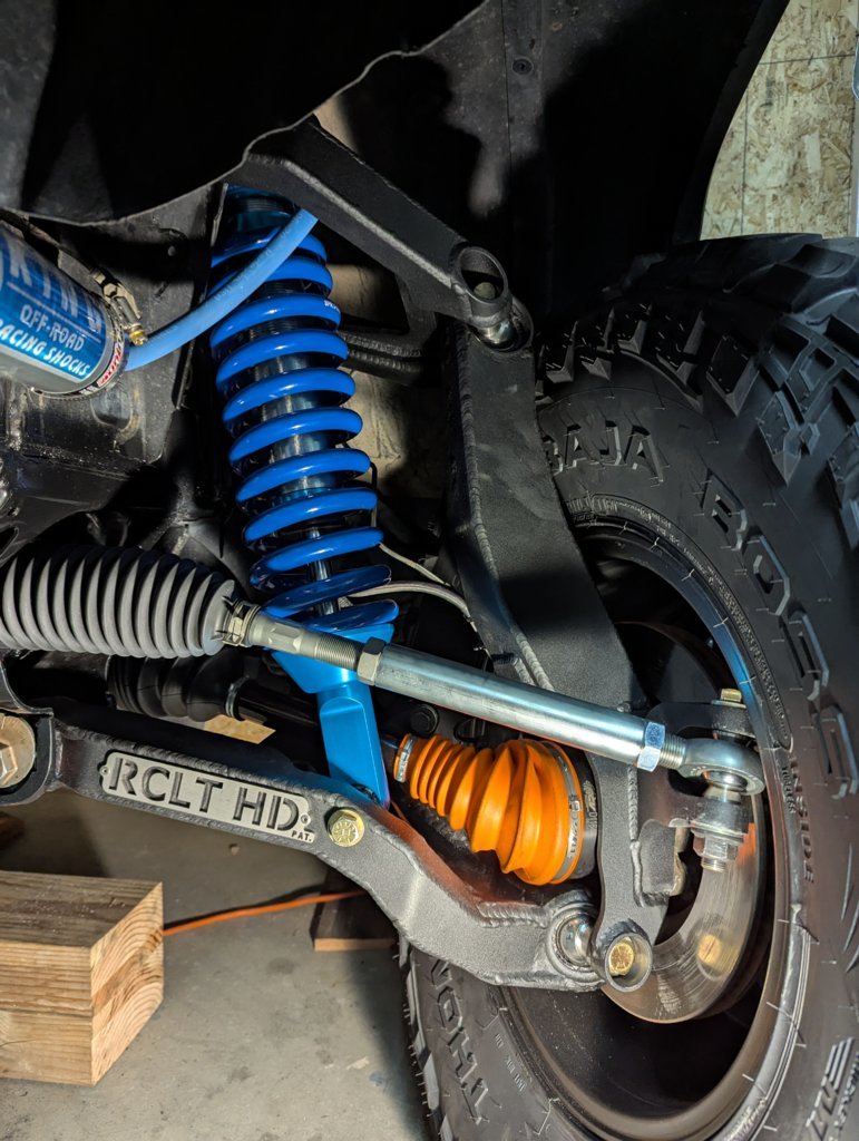

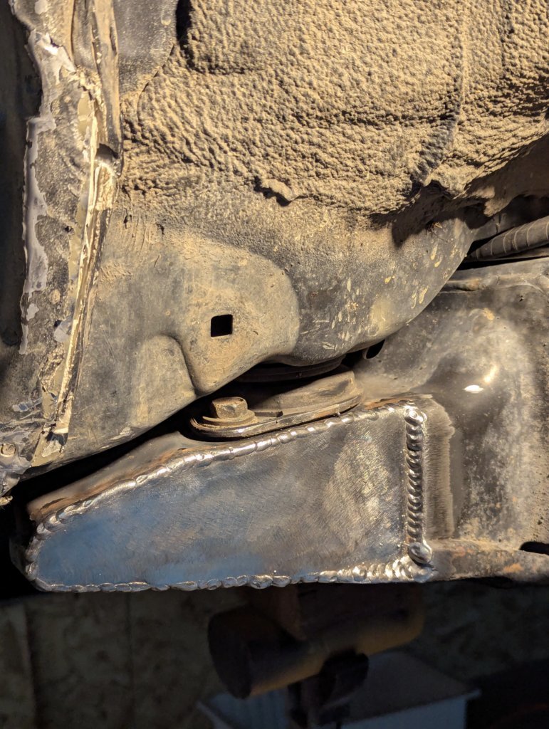

  3. Jan 17, 2025 at 9:59 AM
    #83
    realsystem
    Nov 7, 2017
    #235356
    511
    Stanislav
    SF Bay Area, CA

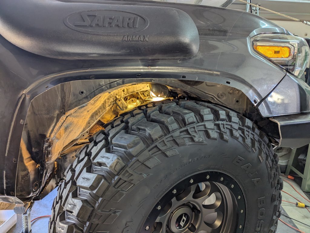

    Installed everything, reinforced something, getting ready for 5.29

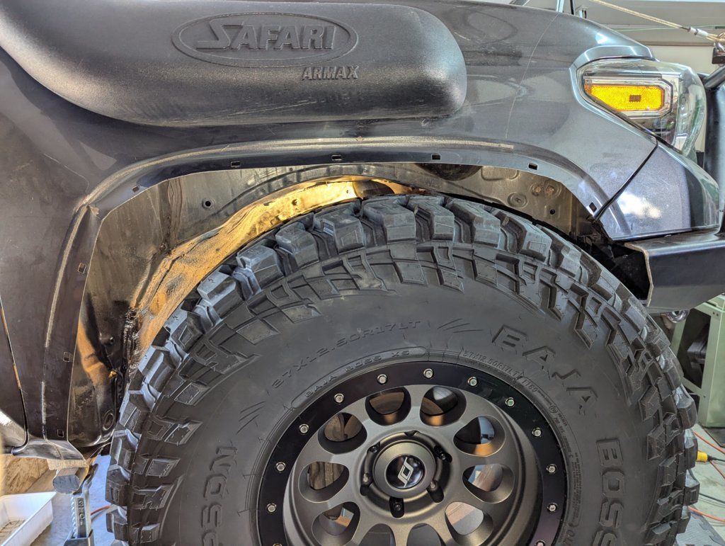

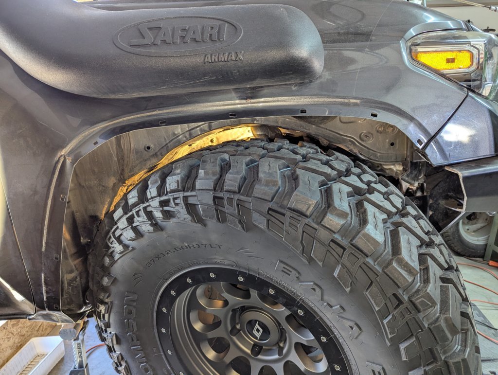

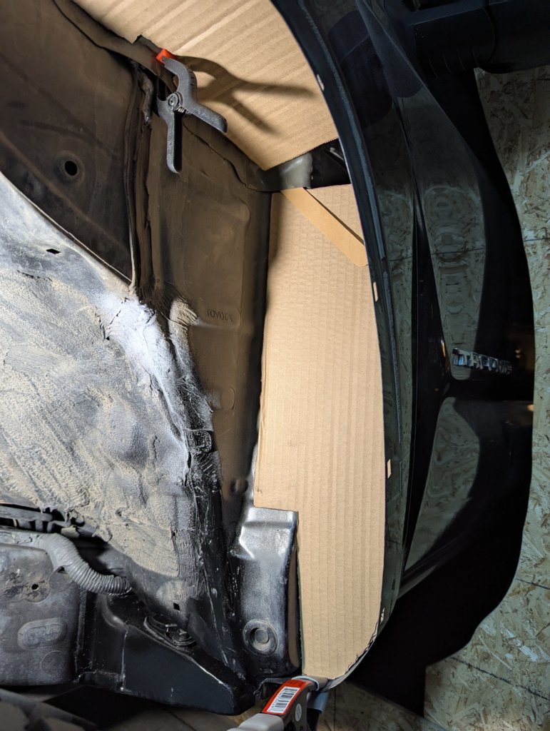

    A little bit of details: CMC is done

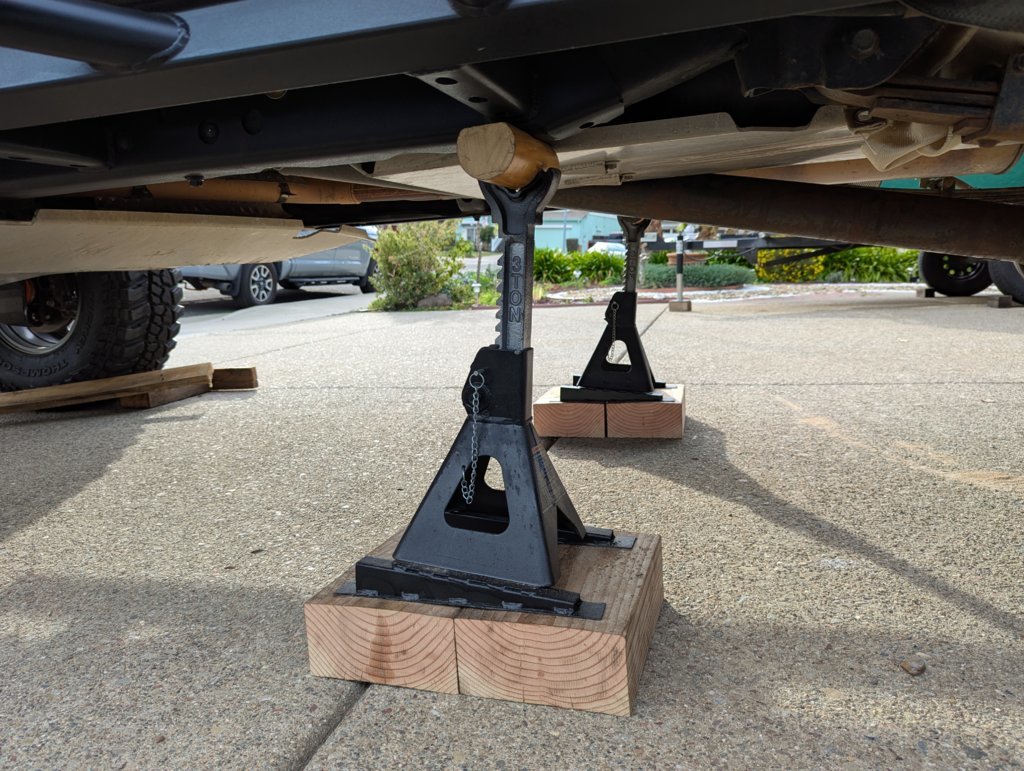

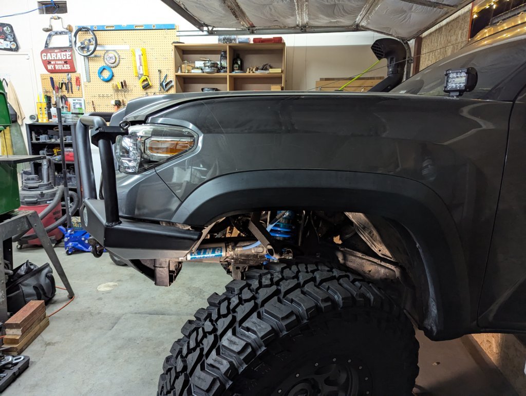

    Next, checking the up travel without coilovers and bumpstops to understand the scope of work
    PXL_20250120_190156596.jpg PXL_20250120_190354389.jpg PXL_20250120_190703028.jpg PXL_20250120_191059822.jpg PXL_20250120_191112682.jpg

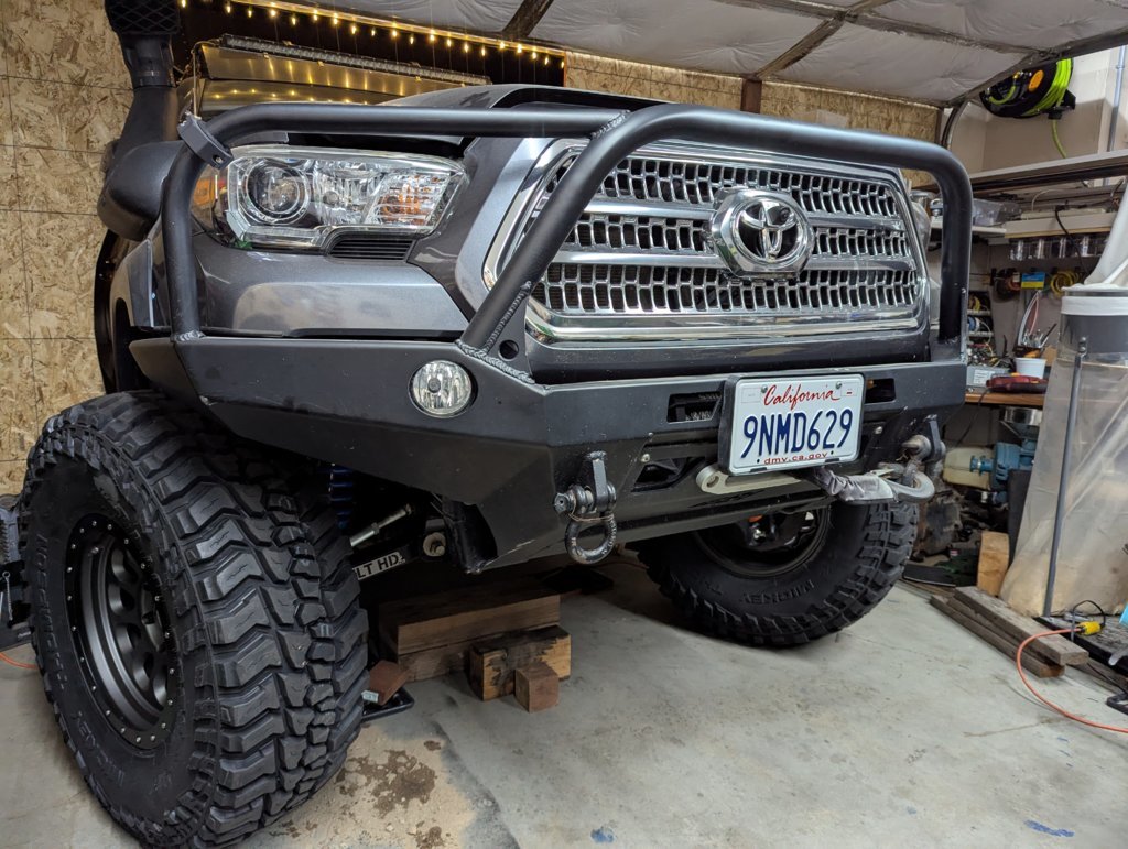

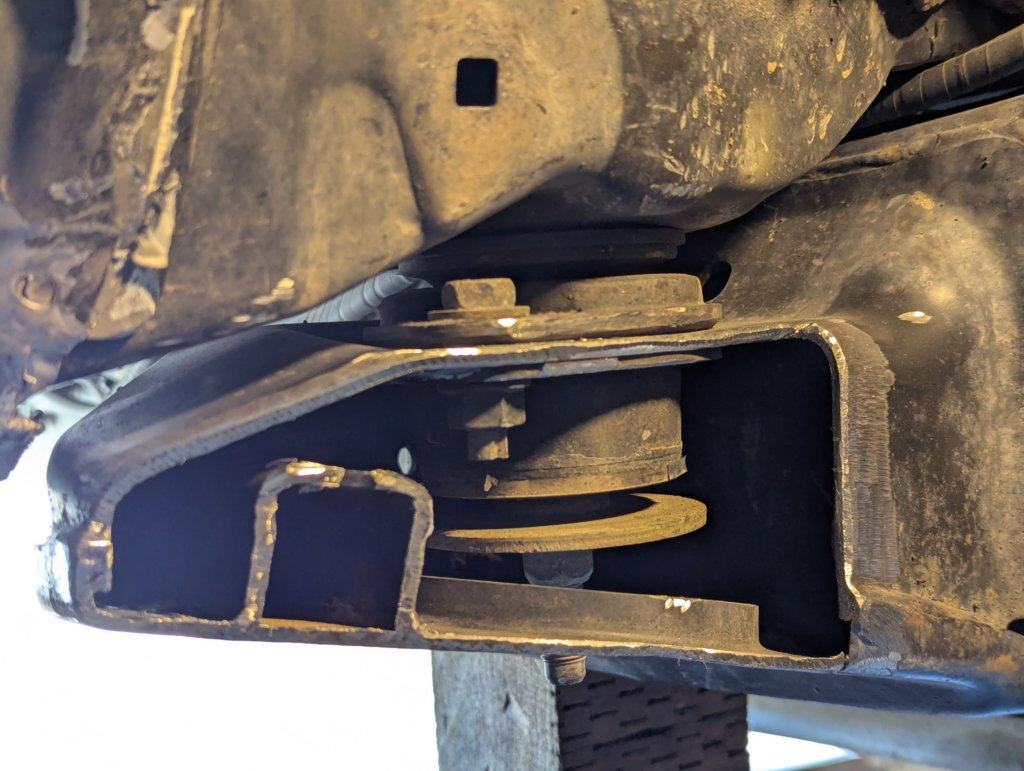

    Saving $500+ by doing some fabrication finally
    PXL_20250124_054841959.jpg PXL_20250124_054903777.jpg PXL_20250124_055101079.jpg

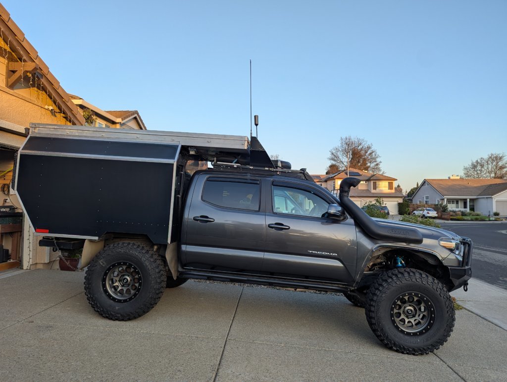

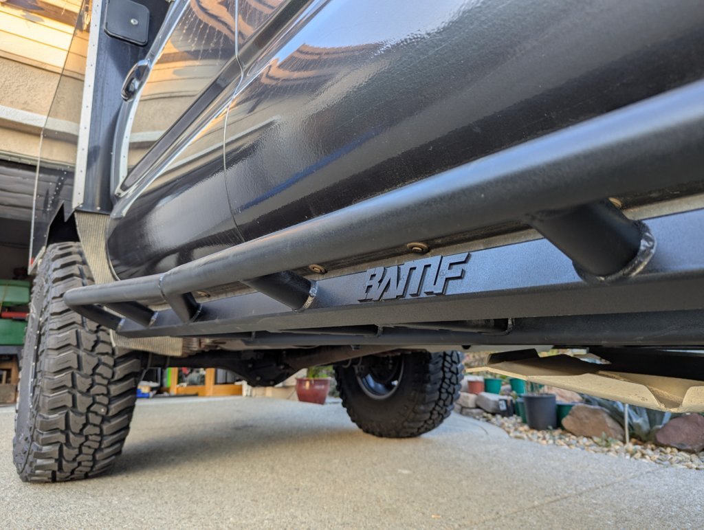

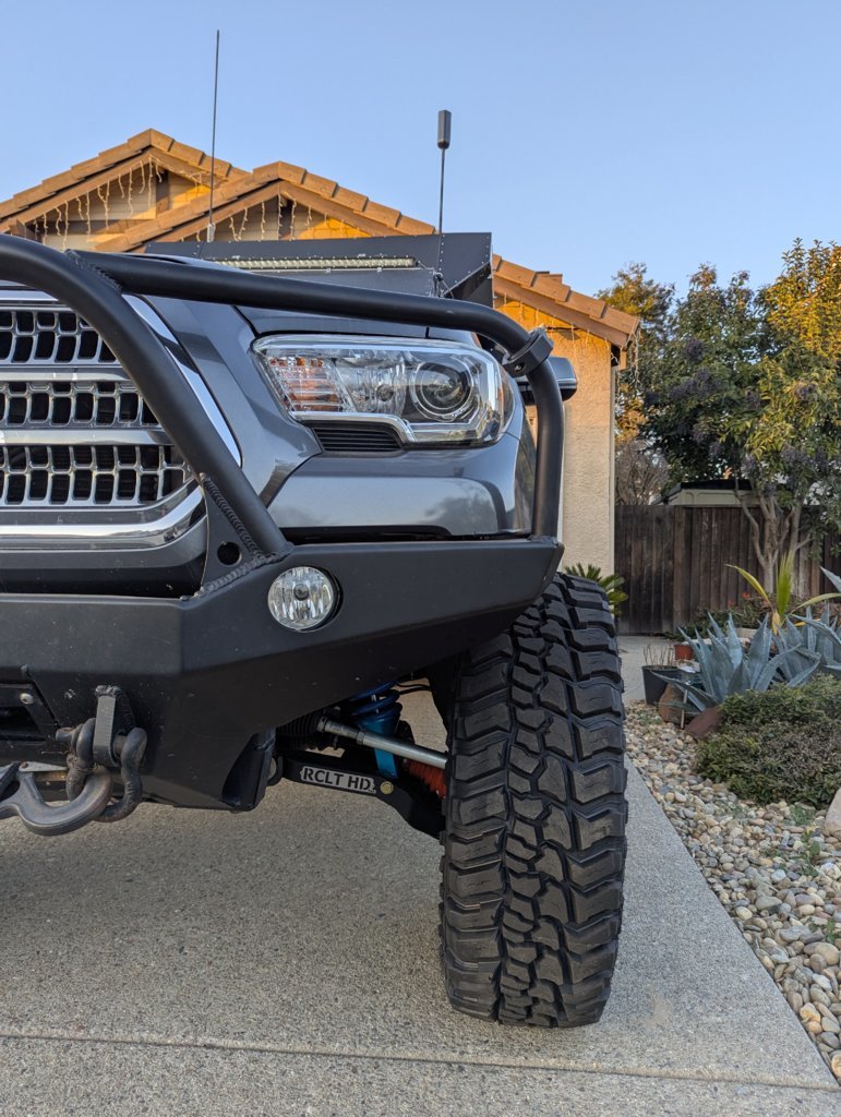

    The first(main) phase is done: LT, 37s, 5.29, rock sliders
    PXL_20250130_010307499.jpg PXL_20250130_010206177.jpg PXL_20250130_010141483.jpg PXL_20250130_010125007.jpg

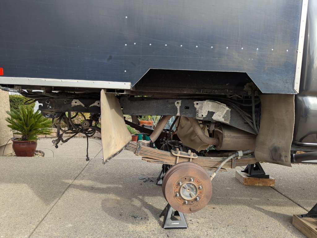

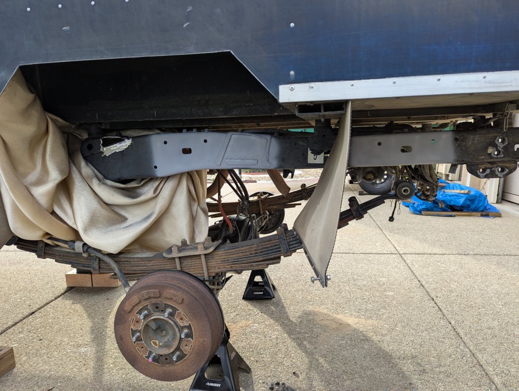

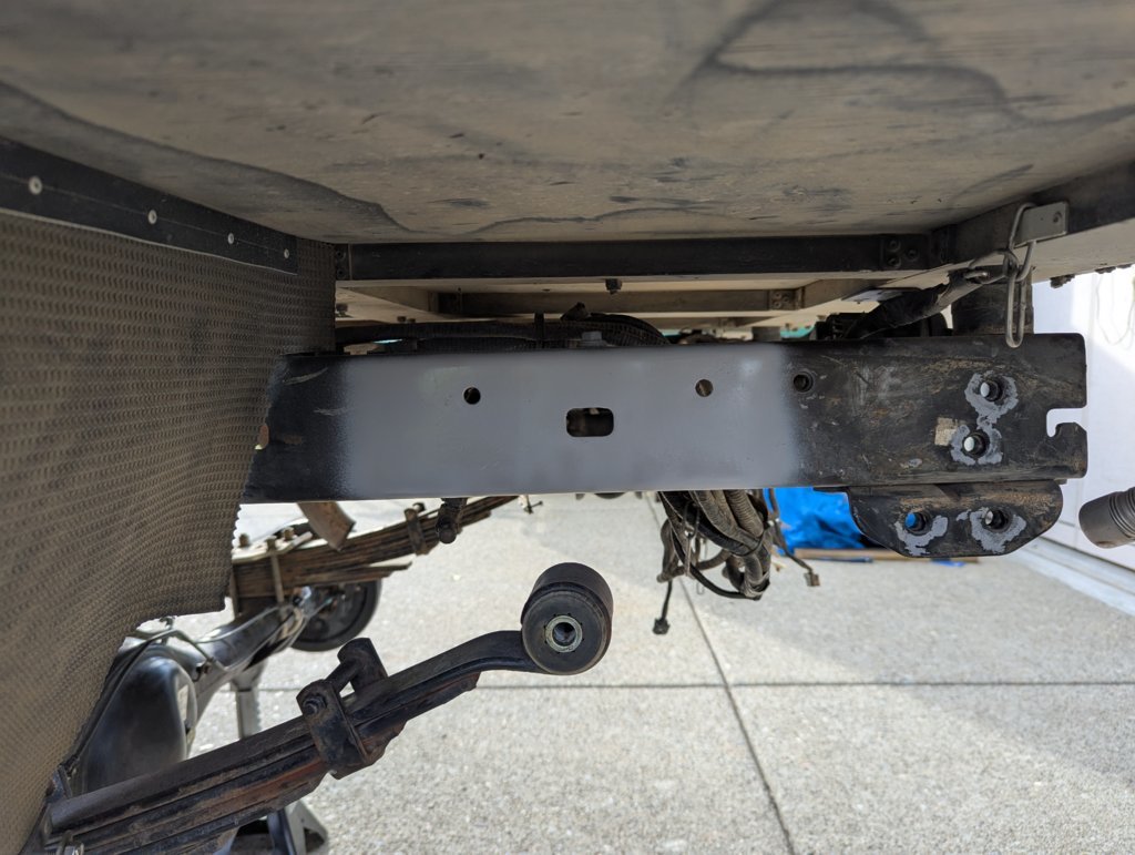

    Started to work on the rear. The rivets were tight but the air hammer did the job.
  10. Feb 24, 2025 at 7:02 PM
    #90
    realsystem
    Nov 7, 2017
    #235356
    511
    Stanislav
    SF Bay Area, CA
    To fit @ARCHIVE stuff I need to lift the camper, fix the bent subframe of it and cut the part of the wheel well.

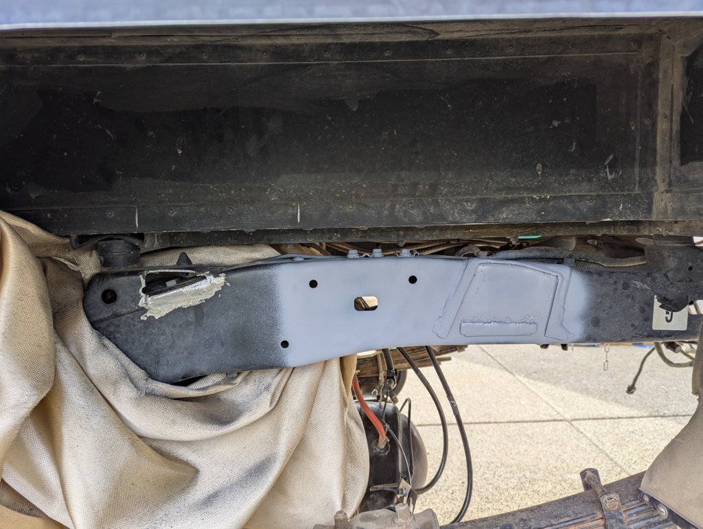

  11. Feb 25, 2025 at 11:18 AM
    #91
    realsystem
    Nov 7, 2017
    #235356
    511
    Stanislav
    SF Bay Area, CA

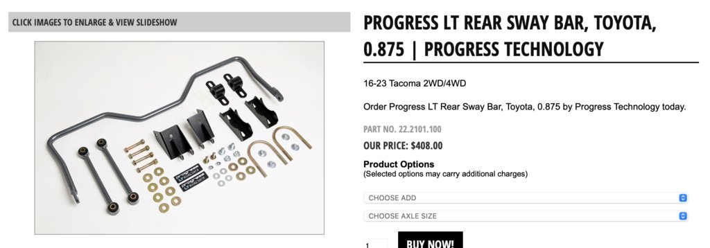

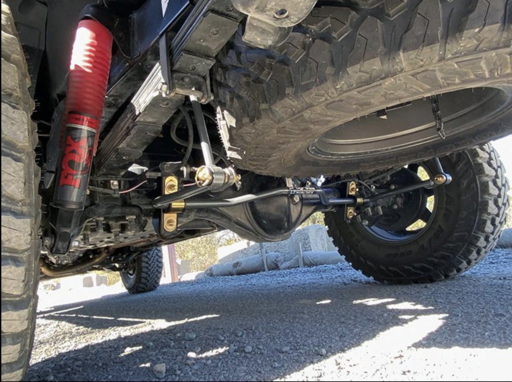

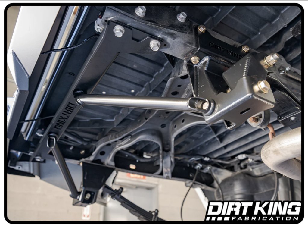

    @El Taco Diablo @10YSON what's your opinion about:
    1. cross member for the leaf hangers
    2. rear antirock sway bars for our trucks
  12. Feb 25, 2025 at 11:23 AM
    #92
    essjay
    Nov 29, 2018
    #274276
    3,203
    Concord, CA
    You definitely want that crossmember connecting the shackle hangers and the OEM spare tire crossmember, Stan.
    realsystem[OP] likes this.

    Agreed

    This is what's on my truck and I'm really happy with it so far.

    Regarding the sway bar, there are kits out there but I've never seen one out in the wild.

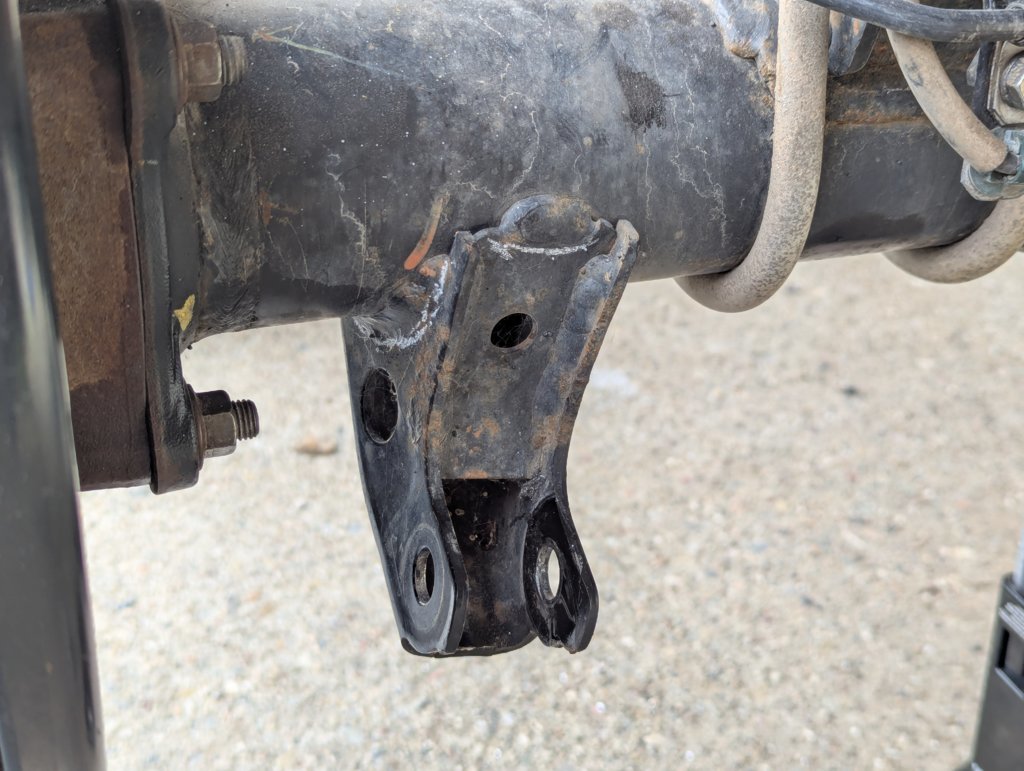

  16. Feb 28, 2025 at 8:20 AM
    #96
    realsystem
    Nov 7, 2017
    #235356
    511
    Stanislav
    SF Bay Area, CA

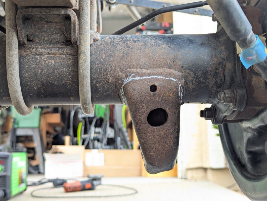

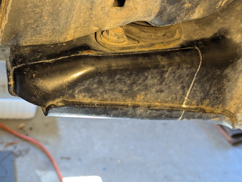

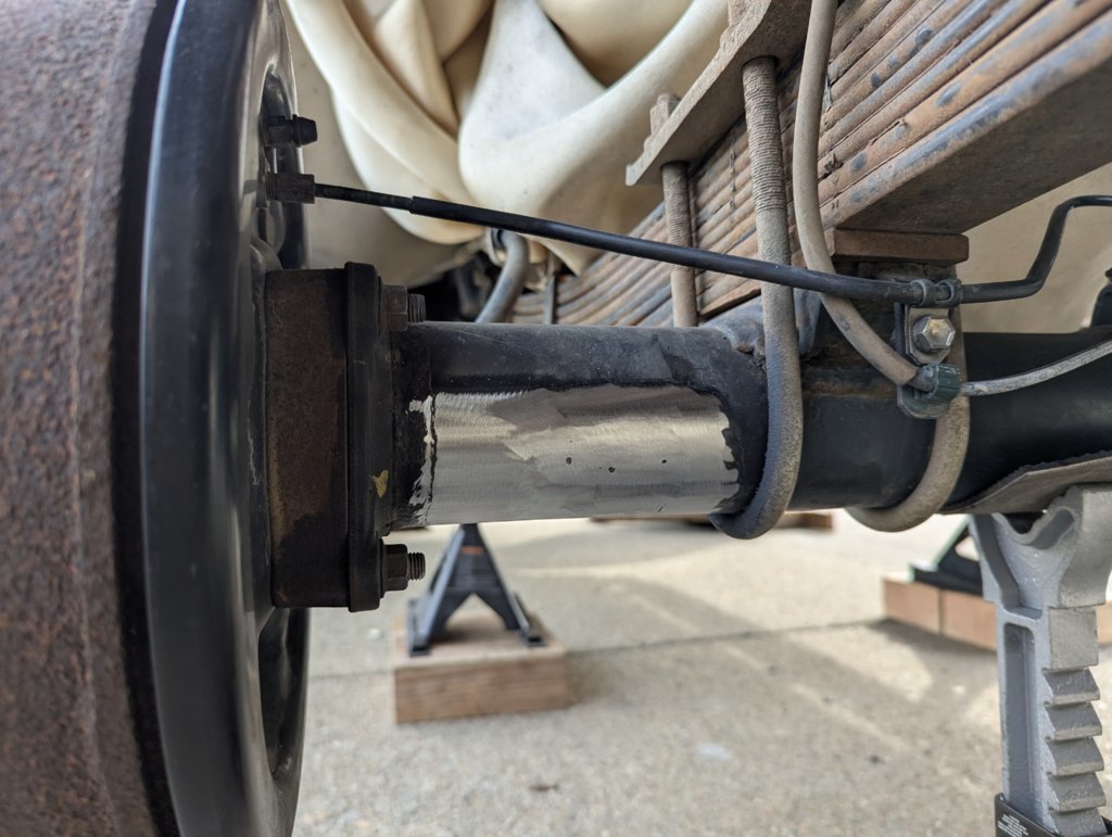

    The most strongly welded part is lower shock mount to the axle
    El Taco Diablo likes this.
  17. Feb 28, 2025 at 9:39 AM
    #97
    10YSON
    10YSON Well-Known Member
    Mar 17, 2019
    #286979
    527
    GREG
    TACOMA & 4RUNNER
    TOTAL CHAOS / KING / DEAVER / PRP / DIRTKING
    What towers and shocks did you end up going with? Cutting off the lower shock mounts sucks. I feel your pain.
  18. Feb 28, 2025 at 10:25 AM
    #98
    realsystem
    Nov 7, 2017
    #235356
    511
    Stanislav
    SF Bay Area, CA

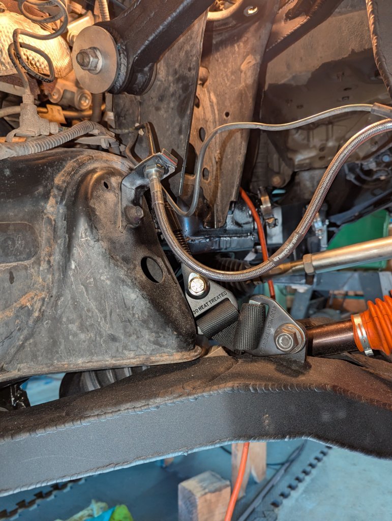

    @ARCHIVE shocks relocation and hammer hangers
    @TOTAL CHAOS bump stop mount
    King 2.5 smooth shocks and bump stops
  19. Feb 28, 2025 at 12:01 PM
    #99
    Scott B.
    Scott B. Well-Known Member
    Nov 11, 2014
    #142118
    4,474
    Scott
    Georgia
    2015 ACLB SR5 4x4 Expo
    Did you start with a plasma cutter?
    I am about to do mine - I have the Archive kit to install.
  20. Feb 28, 2025 at 12:34 PM
    #100
    realsystem
    Nov 7, 2017
    #235356
    511
    Stanislav
    SF Bay Area, CA
    yes, plasma with a big allowance to keep the axle tube out of the flow, but still have some cuts on the tube after grinding it off. Be careful, drop the oil or at least open the inlet plug.
