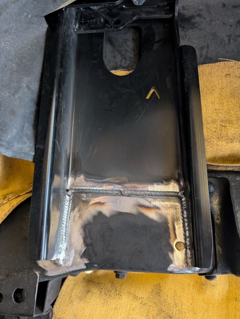

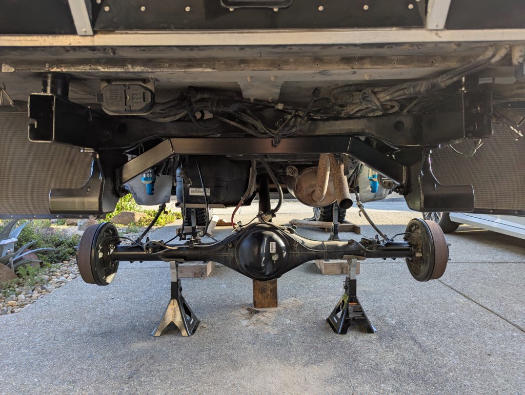

    The high clearance cross tube also done. Fabricated additional shim plates to install it properly because the frame missed the square. Also boxed the frame rear ends.

    The rear part is done, now need to find out best place for limit straps and fix the reservoirs.

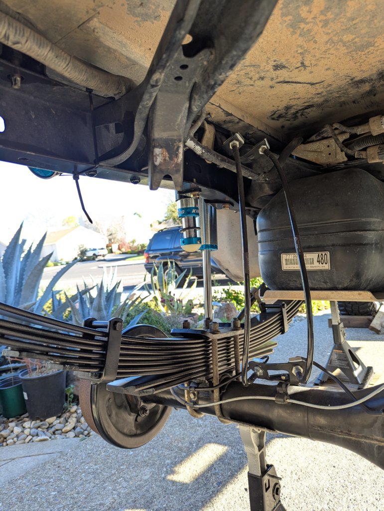

    Permanently installed reservoir

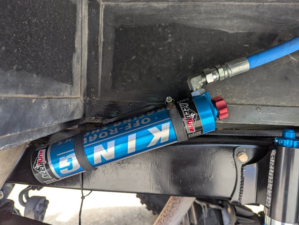

  6. Mar 19, 2025 at 7:40 AM
    #146
    zippo88
    zippo88 Well-Known Member
    Jun 11, 2018
    #256154
    342
    L
    2012 sport
    Nice use of heat shrink on the resi clamps
  7. Mar 19, 2025 at 8:45 AM
    #147
    realsystem
    realsystem [OP] Well-Known Member
    Nov 7, 2017
    #235356
    511
    Stanislav
    SF Bay Area, CA
    2017 MGM Tacoma TRD OR DCSB | 2021 Cement Tundra SR5
    LT,37s,5.29,Kings,Camper,Deavers,snorkel,winch,CVCtune
    actually it's not me, it's included in the kit from @AccuTune Offroad

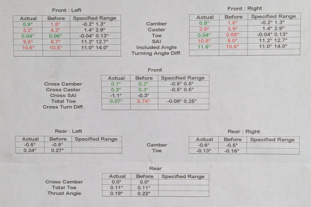

    Finally, alignment is done

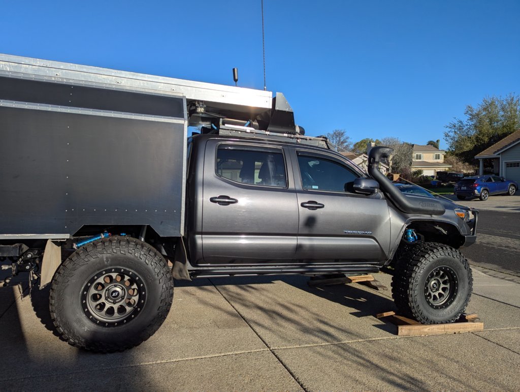

    Let's see this build in motion:

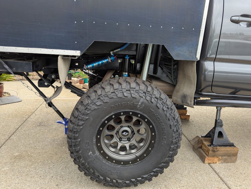

    Cab mount chop and fender cut to fit 37 inch tires

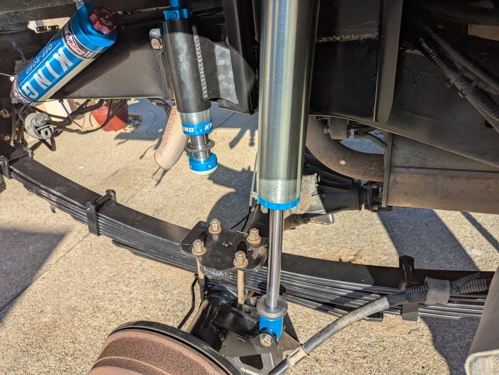

  17. Jun 19, 2025 at 8:40 AM
    #157
    realsystem
    Nov 7, 2017
    #235356
    511
    Stanislav
    SF Bay Area, CA

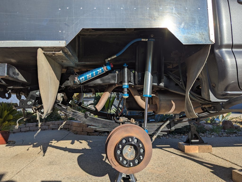

    Rear suspension: King shocks and hydro bumps, Archive garage Hammer hangers and shocks relocation, Total Chaos bump stop brackets, maintenance for Deaver stage3 leaf springs
