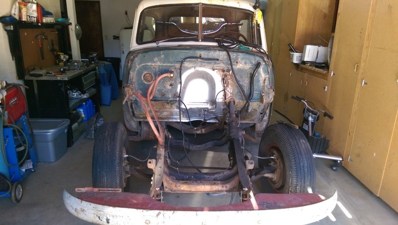

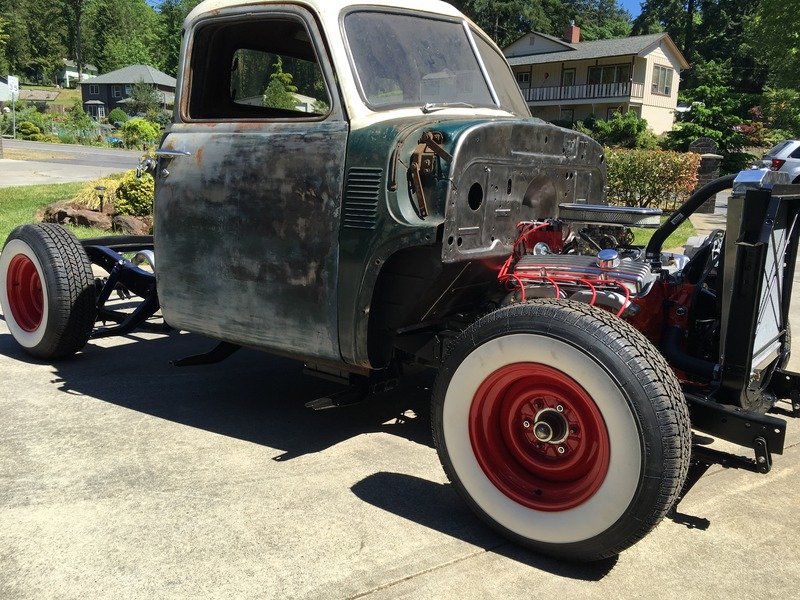

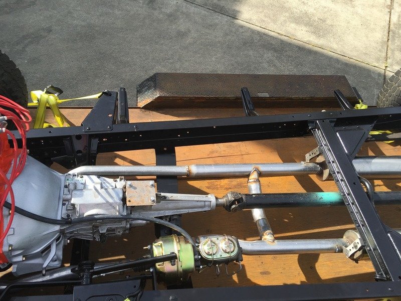

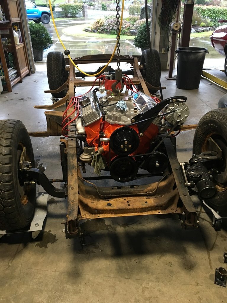

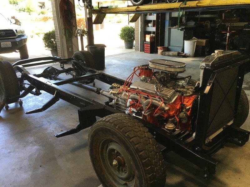

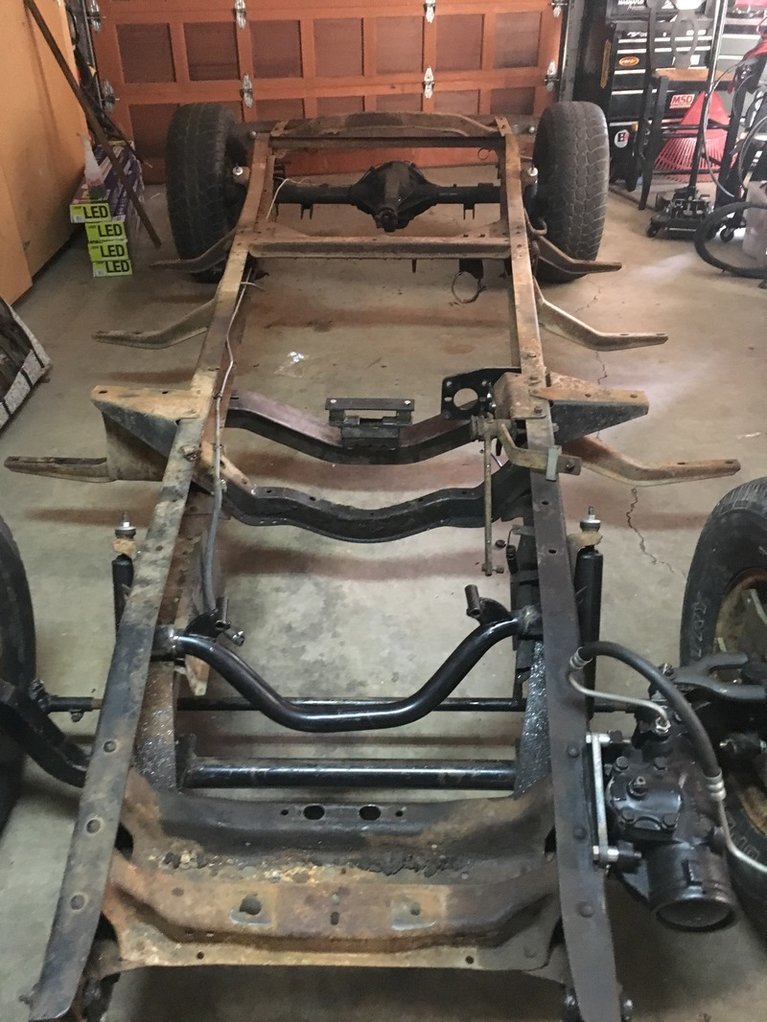

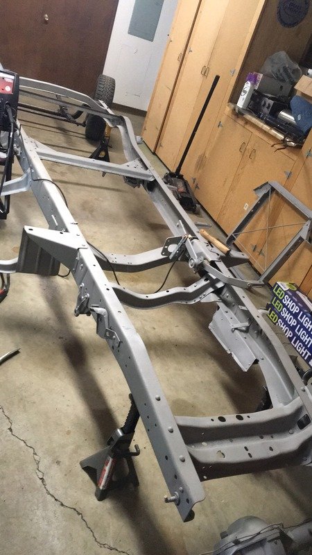

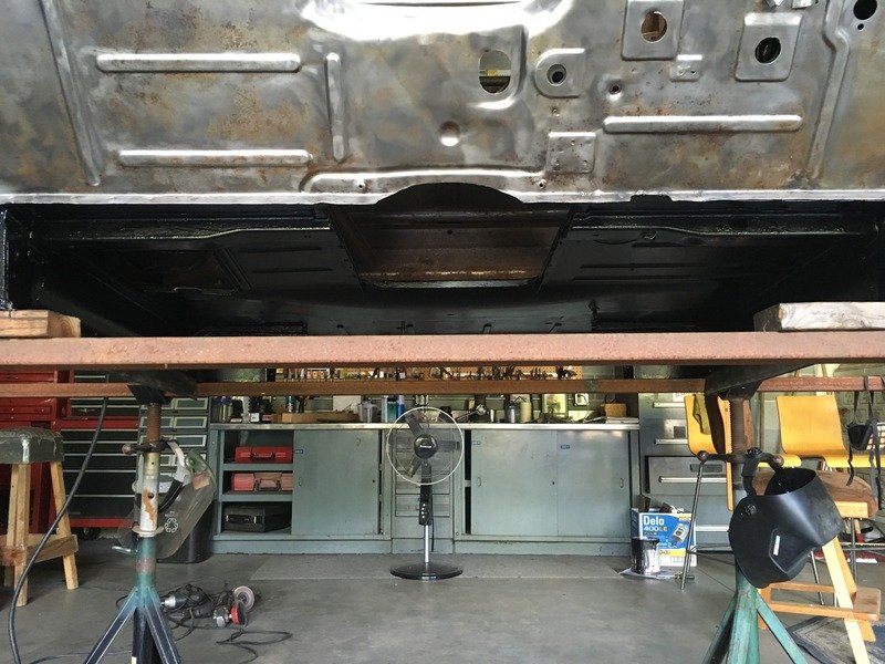

    I'd like you guys to see my project girl. I bought her 3 years ago as a complete truck. It had a 235 and 4 speed behind it. With a last known registration of 94' I brought her home changed the points poured gas in the carb and bam! She was running. Once I knew it was safe after doing all the brakes, and a few other engine issues sorted I drove her locally for 2 years.

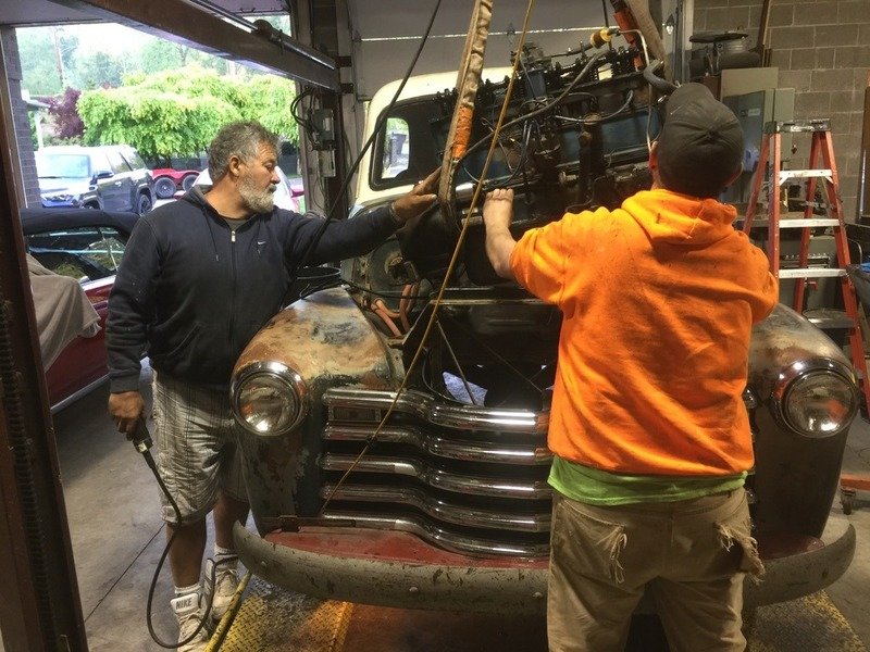

    About a year ago my father in law and I pulled the factory drive train and I slowly started my build.

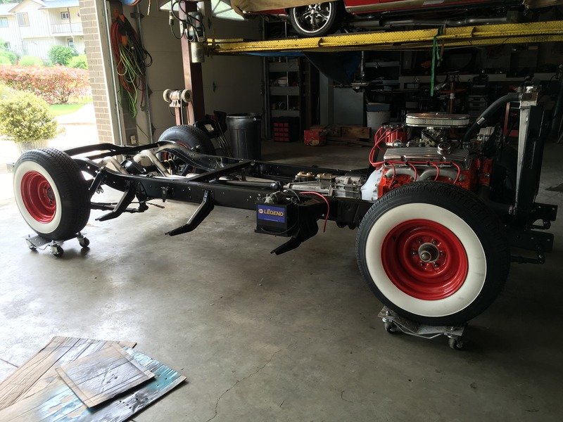

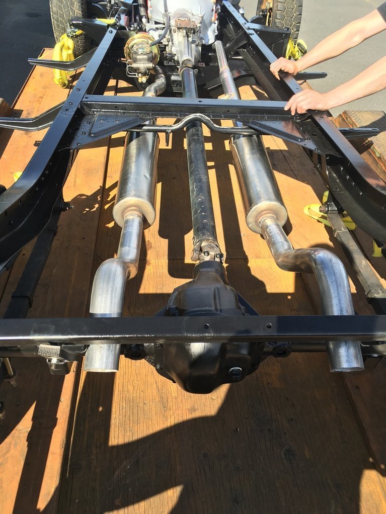

    Here is the parts list and the photos.
    Some are before it was torn down and it will look similar only lowered more.
    327 V8
    S-10 T5
    Speedway Drop Axle
    Dana 44 rear
    3" lowering leafs
    C-10 Power steering
    Disc brake conversion up front
    Factory Location 7" Brake booster
    15x8 Steelies
    Coker Classic white walls
    913020E7-8E6C-498C-9A77-2700912288A8-503_dbb0bfd87ea548dd0266a70998f2f5f5d3044be6.jpg
    B5166AB2-615B-465E-BFF1-AD8973572184-649_333f6735dba2b87bed0bec68a0b72638b51bbae7.jpg
    78494AA9-5736-4B79-8D12-860EE442E1CD_zps_043e09fbacb5be9b826e4c6148f991bfcaede3b2.jpg
    D7405606-EFC6-49F9-9F83-D0C999FCF0E6_zps_15f6af09ab7c1ecff98187581585b96b61b4aa87.jpg
    1CD3E285-8071-4466-B7D2-772507B7E2BD_zps_4d72d8dc53fcaa7caaac683c8d6f7090a8926ad3.jpg
    8AB11F7A-56A9-45E1-81E8-AA7B58609234_zps_ed4283832669fe0e0310c9b1075e7efdef4b8698.jpg
    BC0D2F59-FFFE-43CE-BBAF-24D7D4E7C2EE_zps_e2d4d61953e45fe0dd13d59c55369c08343e6987.jpg
    1BCA7C52-4FBD-4931-9354-DD0EF2A0E795_zps_4f36906d5607f62a8de1f4d401e670ba28ff98ac.jpg
    F5628882-65EF-4122-A716-D661858D6EBA_zps_6c57684fff5219975f2d429b10579d4b3724a745.jpg
    BD1801CD-6EFF-46A6-A6DD-0CBACB9AB39F_zps_8c184a4aa0fbbc0f34f5d4abc8c05a8b01c90b26.jpg
    0E06371A-86DD-467D-901C-7F53D5354712_zps_a47285e545a0cd4ece25fec0943ea318dbbed116.jpg
    38873765-9F4B-4BE0-8B38-FE953EC41E75_zps_3019f84530c0dfb4d8c6123da831a6946d44c153.jpg
    EC5F2301-5892-4D35-8EE9-892760FA385C_zps_0f948ba5a7526e04e42d5c7279ea5fd3a4c52288.jpg
    719A5708-CB10-434B-BC0A-DC99983B0C39_zps_c342ac0788253dc71f6f3a530a94121026654ba0.jpg
    FB3299B7-E1BA-469D-BB40-8398F41CE592_zps_a754619d2c6141b4ad8b2edd4767026b743e9e9f.jpg

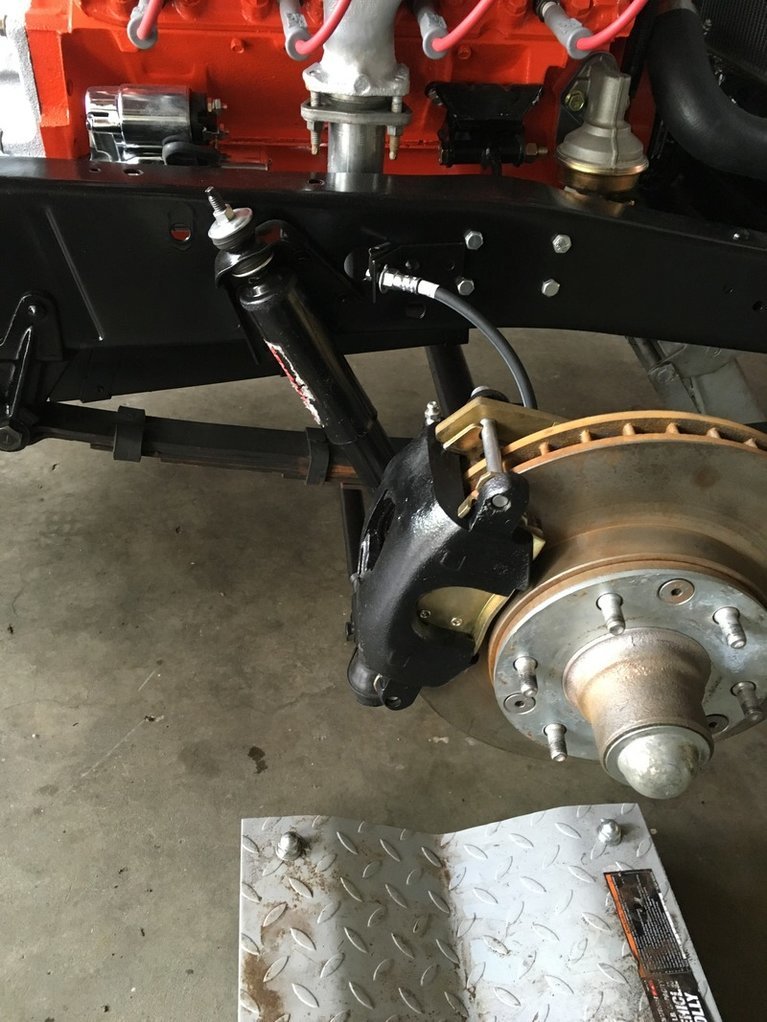

    Disc brakes are done and the new wheels and whitewalls are on
    9D46E6DF-829C-43E6-B805-C2C62391650C_zps_8c01dc8ea826fd78703a42a5a0201f76f31e0a9f.jpg
    B1E53F11-7145-48BC-944A-30F5230940F8_zps_6d431602459363ef7900fb73a8e22f8d53cc41b7.jpg

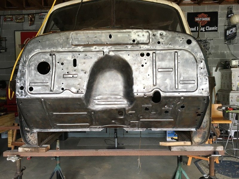

    I buffed the firewall and planed on painting it the factory green. But decided to just satin clear it.
    481A74C1-38F1-4DF6-961D-32BA702296B1_zps_b69afcb1eccdeed488f2465cc9be3fa187f46f67.jpg

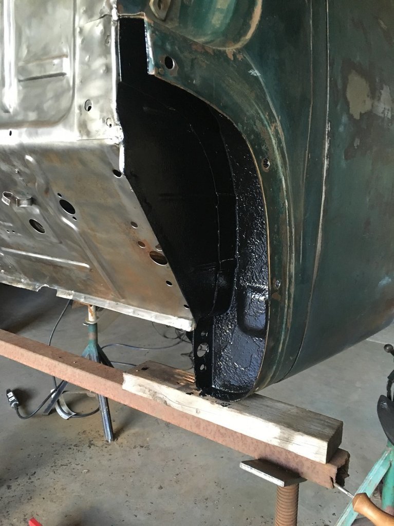

    I wire wheeled the bottom of the cab and used Rust Shield paint and will spray underbody coating once dry.
    FE1190F2-3519-41B8-B0B1-D38A36516A3C_zps_16aadddccc3e5b4f0d3a938399896ded2aa133fd.jpg
    BC3E424D-11E4-43F5-BFC9-2A0B4BDEF67D_zps_7bda4c62d9e168a53c1058257de106550ea64861.jpg
    C0DB1EE8-E171-4A47-AEA7-35E2A8A1D9D0_zps_0e4bd50ea9083d2e1709fb7da1e22a308fb9aa05.jpg

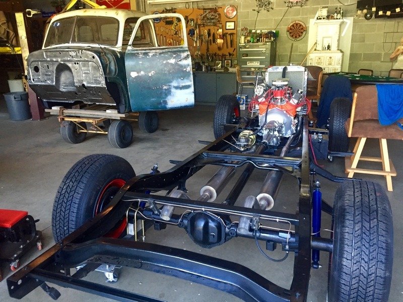

    We finished the brake lines and then mounted the cab. I'm getting excited!
    0B029D30-B00D-4DDF-BAEF-37CE02FF83F7_zps_76139c17468d8f2f8442d223d68f2e754c1e954c.jpg
    8B6C925B-5131-4C81-8AB0-5963592F8E4F_zps_6abacad32259153a5b18c33d10f079c34e954da7.jpg
    And that's where it sits now. Once it's assembled I'll be doing the interior. Rust prevention, paint, and sound deadening. Carpet and seat covering after that. Hopefully it will be on the road next month sometime. Thanks for looking!

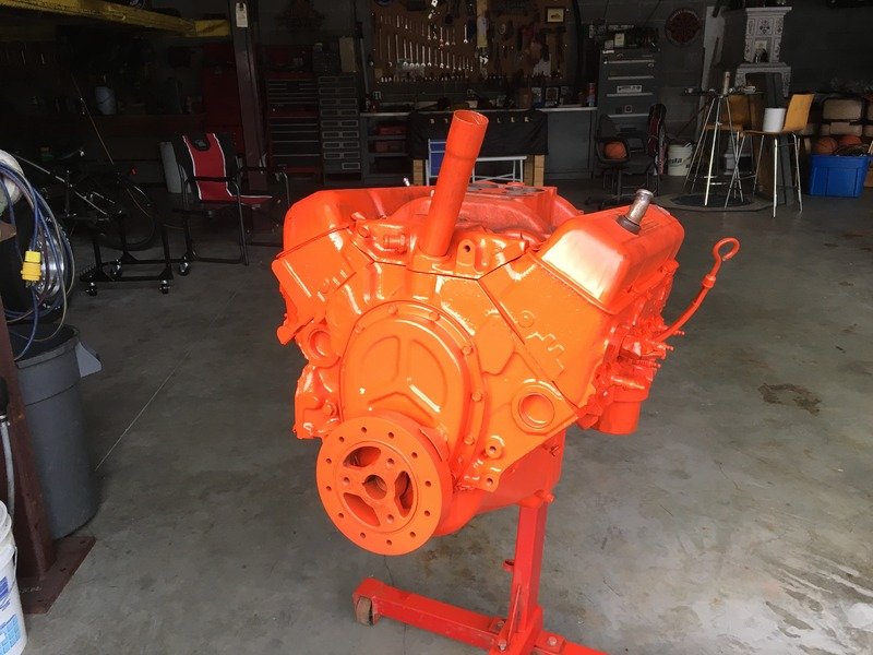

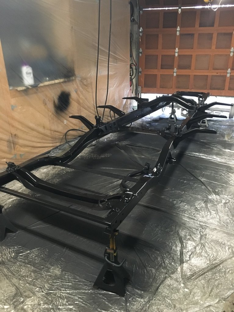

    What'd you paint engine with? Frame?
    ChadsPride likes this.
  5. May 11, 2016 at 10:20 PM
    lo1dakota
    lo1dakota [OP] Well-Known Member
    Jul 11, 2015
    #159266
    198
    Brandon
    Longview, Washington
    2007 Speedway blue double cab TRD off road
    OME K&N Short Thow shifter Pro Comp 16" Wheels Toyo 33" Tires Road Armor Bumpers N-Fab full length bars

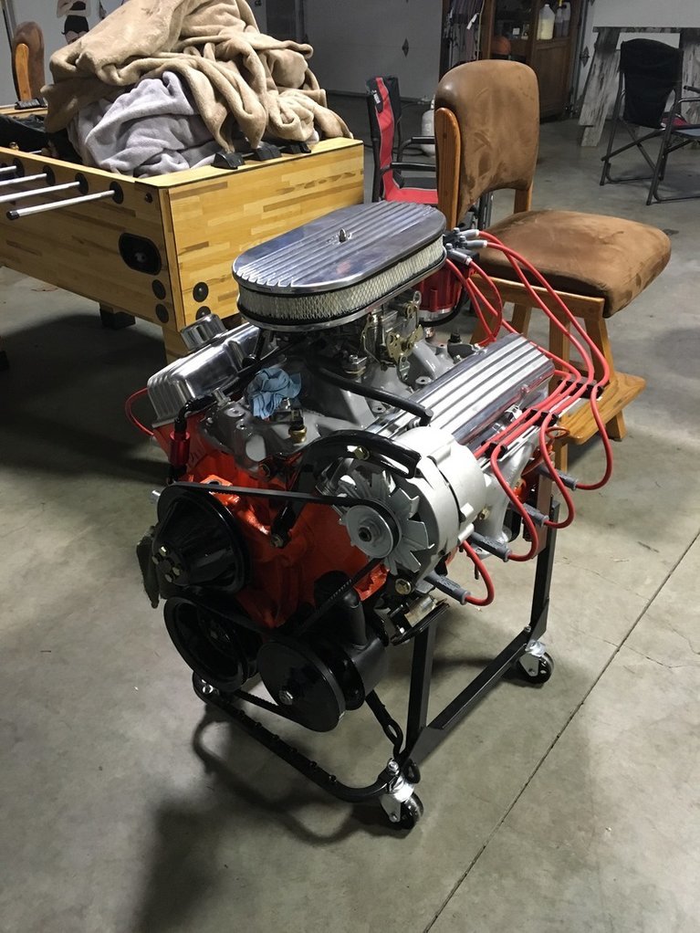

    The engine is Chevy orange. It's a high heat rattle can.
    The frame is painted with Rust Shield from SEM.
  6. May 11, 2016 at 10:22 PM
    T4RFTMFW
    T4RFTMFW Well-Known Member
    Jul 23, 2014
    #134525
    69,755
    Is the engine VHT or Duplicolor?
    Asking because my own project 327 is VHT coated, and everything is good except the paint on the block didn't adhere to the primer on the block.
    Paint and primer are good to go on the oil pan, valve and timing covers. Primer is good on the block, just the paint is flaking off. :bananadead:
    Curious if you used the same product and had any issues. Google tells me it's common with VHT/Duplicolor.

    Mine is Duplicolor. I hope it doesn't flake.
