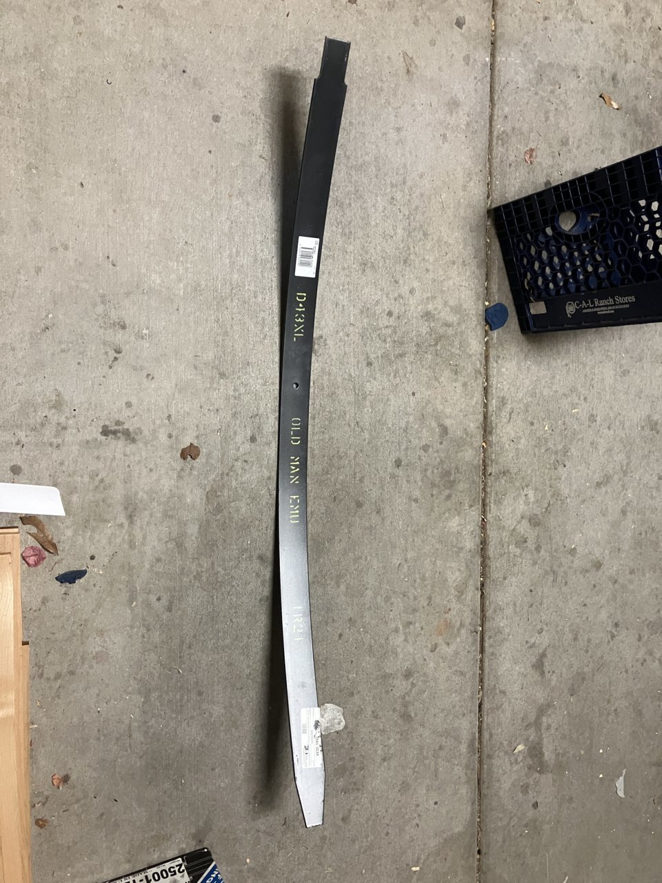

    Couldn’t find a good thread in search for this, maybe because it’s a dumb question. I recently installed a Dakar OME lift with no AAL, and after loading the back I realized I should have definitely added it. I just bought the AAL from wheelers (I also got the original kit from them). When they showed up I started to question this leaf though, one side is squared and the other is tapered. I don’t see how this fits in the leaf pack when all other leafs are tapered on both ends. I called Wheelers and they told me to take a picture and email them… but I haven’t heard back yet so I’m stuck for the weekend. Anyone have any input? the AAl listing says it’s for leaf set cs046r, which I couldn’t match with any part number on my set, but when I bought the set it linked to the d43xl aal as an option, which is the one I just ordered. What am I missing here?

    The squared end faces forward. Once installed, its position is #3.
    Here's a snip from Wheeler's when I asked the same -
    For the center pin torque, I used factory spec which is 33 ftlbs. Feel free to reach out to ARB tech support. They can confirm. 1-866-293-9078

    You will need longer u-bolts - at least I did. I want to say the center pin as well, can't remember for sure.

    It seems strange to me that these add-a-leafs don't have the drilled out holes for spacers on either end if they go 3rd from the top---all the other leafs are spaced. I'm not sure if I want to install these things after all, seems like I might be better off doing an airbag set up in the end anyways.

    Thx for the info., never heard of Alcan but most of this is new to me. I put on the add a leafs and like you was sort of mystified why they aren't drilled out for the spacers, I just put 'em on w/out holes and spacers.
