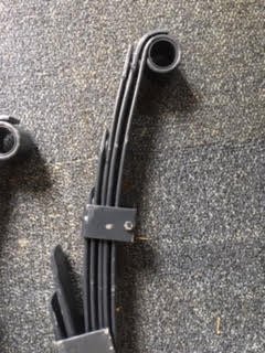

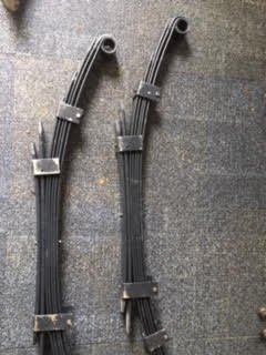

  6. Jun 6, 2019 at 10:54 AM
    JFoffshore
    JFoffshore [OP] Well-Known Member
    Jan 23, 2019
    #280358
    51
    John
    2011 Toyota tacoma TRD 4x4
    None yet
    See attached photos. Thank you for the helpful response. Much appreciated
  7. Jun 6, 2019 at 10:56 AM
    DaveInDenver
    DaveInDenver Not Actually in Denver
    May 18, 2013
    #104390
    3,619
    David
    Grand Junction
    2008 Super White TRDOR AC 6MT
    Unexceptional
    Yup, 3rd one from the top (or from the right in your photo).

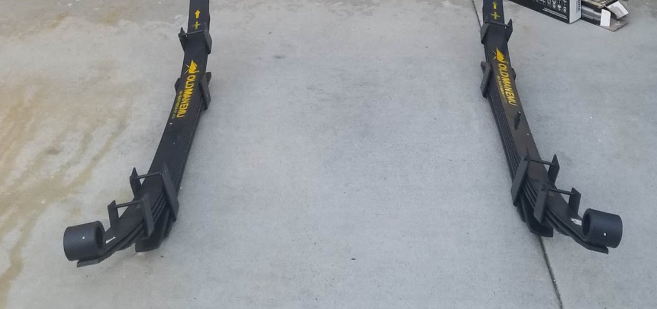

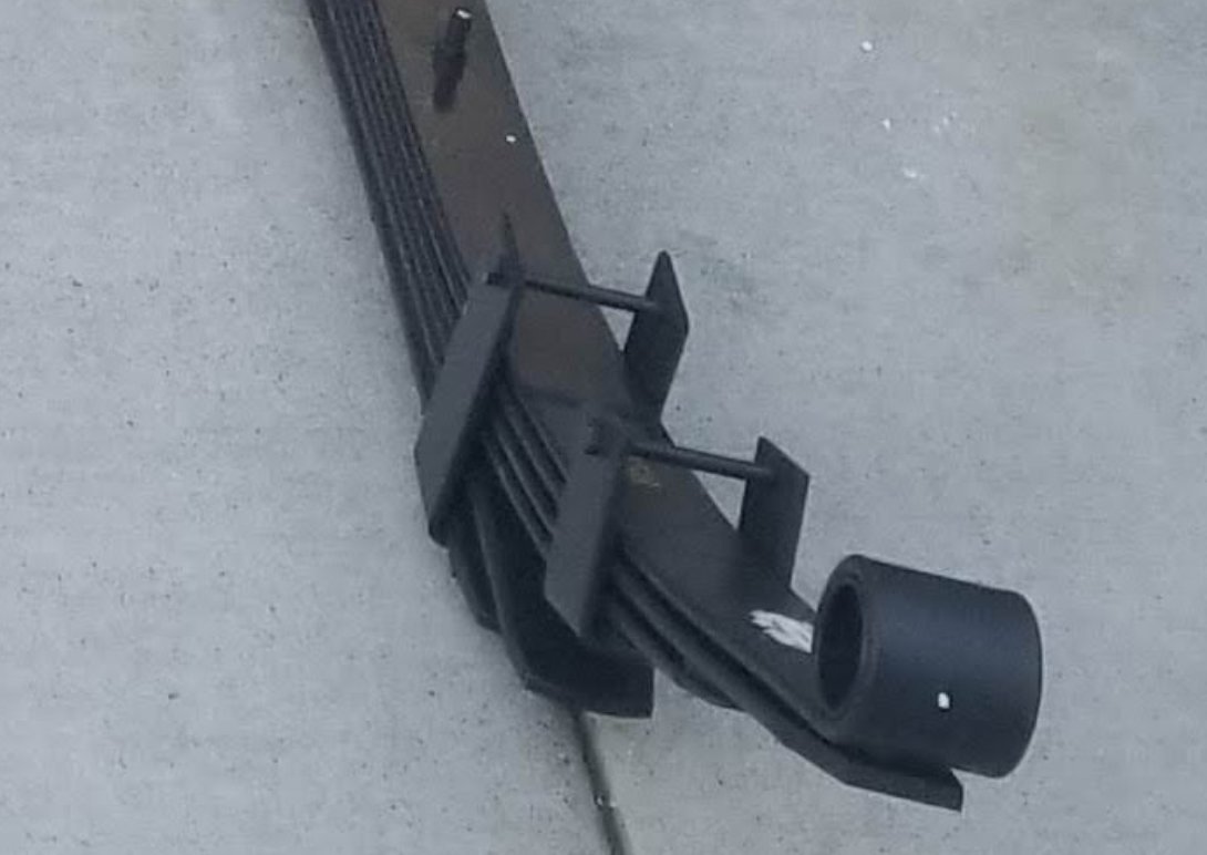

  13. Jun 6, 2019 at 11:19 AM
    jcmotr
    jcmotr Well-Known Member
    Dec 20, 2017
    #239018
    118
    These are my Medium Dakars. Hope it helps.
    From this POV, it seems that my pack differs from yours in your 2nd leaf.

  15. Jun 6, 2019 at 12:01 PM
    DaveInDenver
    May 18, 2013
    #104390
    3,619
    David
    Grand Junction
    Unexceptional
    Look at the forward end, the difference is the second leaf should have a turned up section and the normal 3rd leaf will be flat on both ends.
    If they don't do military wraps then it might not matter and could be 2nd or 3rd I suppose.

  16. Jun 6, 2019 at 12:21 PM
    #16
    JFoffshore
    Jan 23, 2019
    #280358
    51
    John
    None yet
    The leafs are the same. I just have a pic of the other end. I think i'm leaning towards leaving the HD leaf in and see where it sits. Thank you all for the help. i will post pics once I install.
