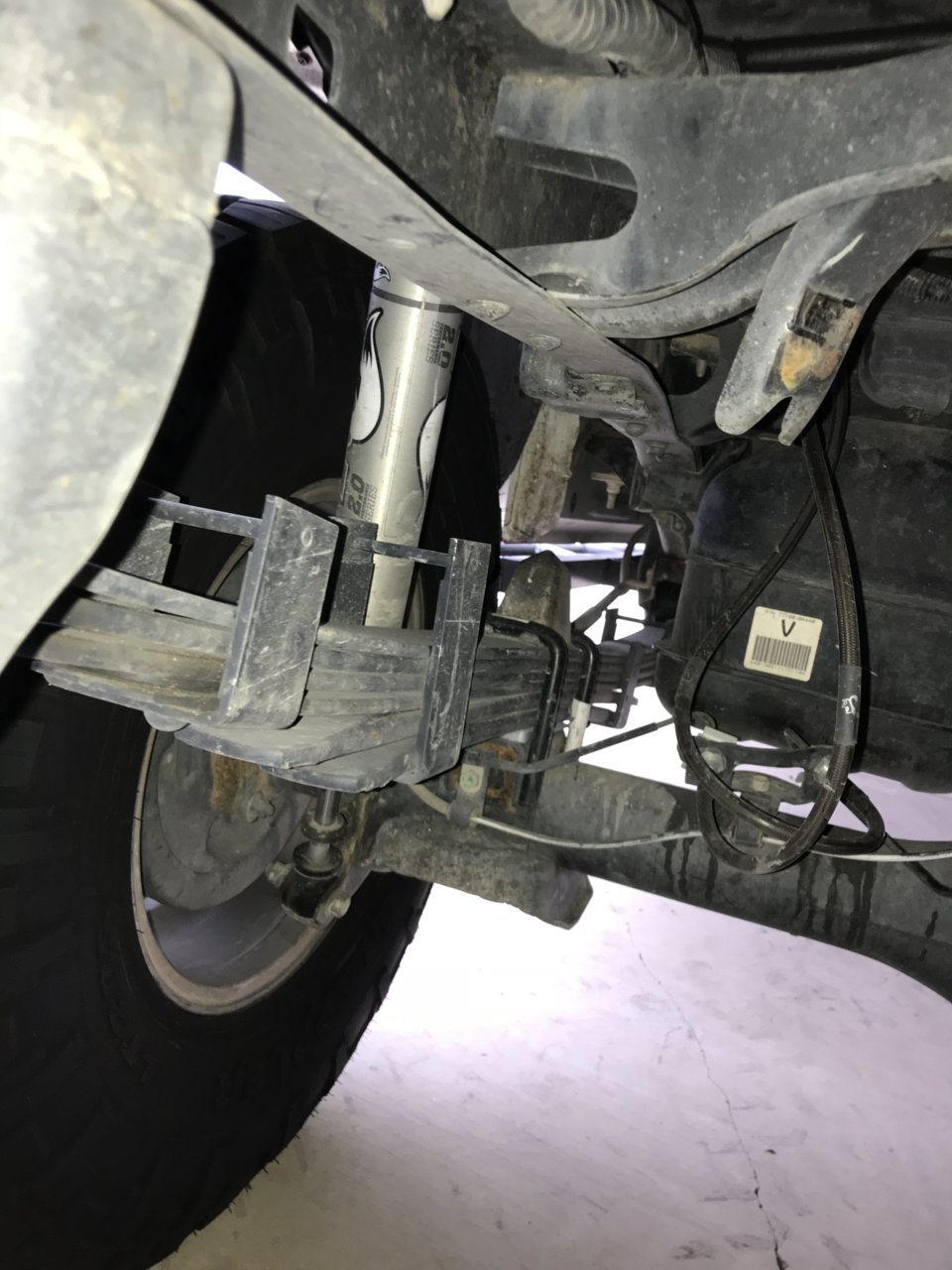

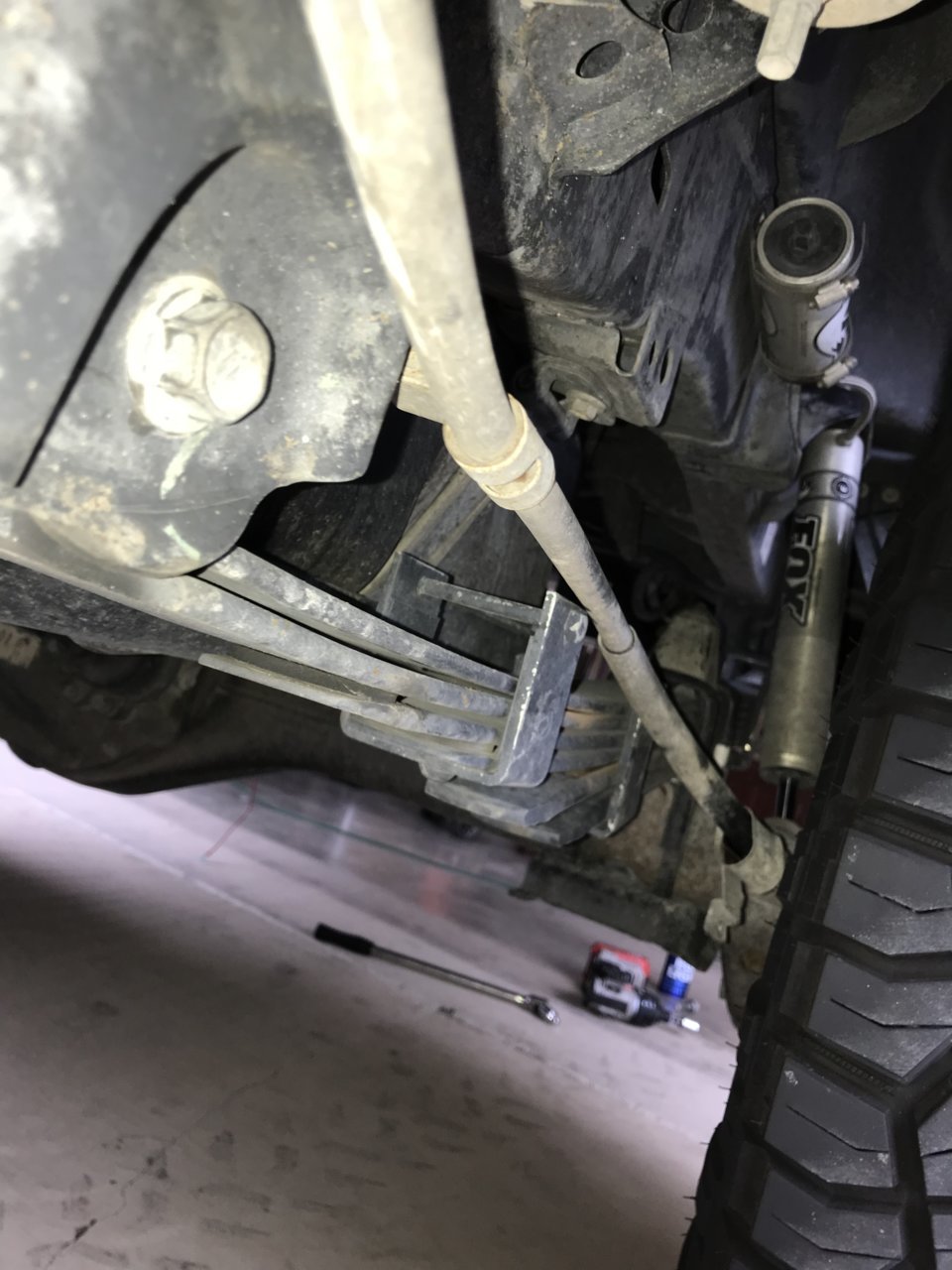

    i installed a new set of Dakar leaf packs, medium, in February. About 10K miles. They look like they’re making an ‘S’ shape! I’ve done about 2 miles off-road since I installed them. I’m welding a hitch into my eBay bumper now so I haven’t towed ANYTHING with them. I don’t have lift blocks, no supercharger, no reason for this.
    Is this normal!
    2C4A8BAF-1347-4232-A29E-9AEF62848D63.jpg EDDCF190-DECE-4794-8433-3D9AFBBCA607.jpg

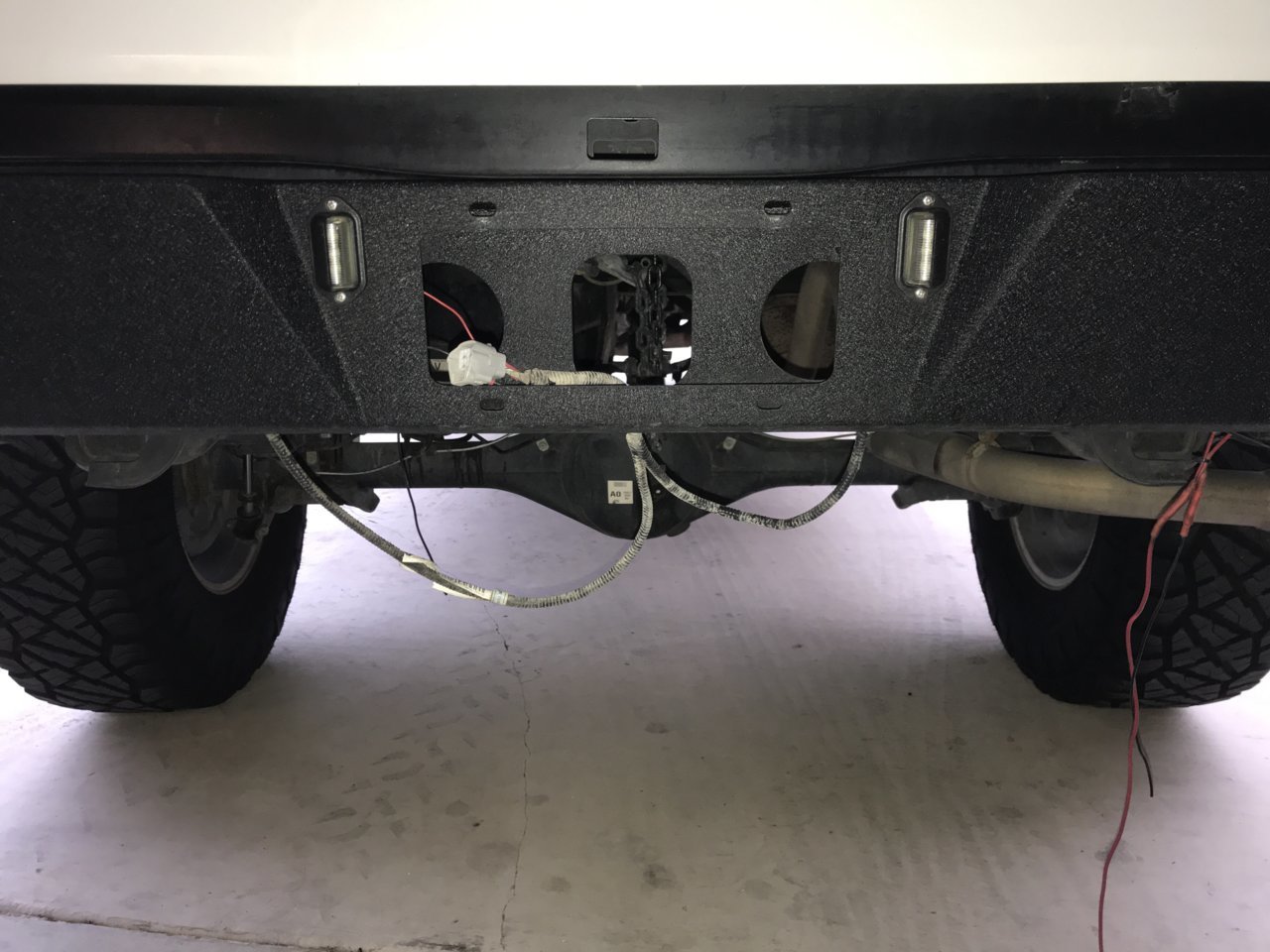

    Proof of no hitch. I’m literally welding it in in about 30 minutes. image.jpg

    Lots of weight? It’s not not normal.

    They don't look "bent" but maybe loaded (normal). Another thing to consider is the deflection in your frame. In the first pic, you can see that the frame is bent at the bump stop contact pad. From a hard landing maybe? Not sure if that has anything to do with the appearance of your leaf pack.

    I would call that normal, the medium duty is designed for stock weight and anything extra is going to "mustache" them a little. Honestly if you are seriously concerned about it, you can always order the extra leaf and stiffen them back up.

    Where did you buy them? They don't look abnormal to me for mediums. OME springs have a pronounced flat section in the middle normally and they're not inverted. They're not even flat or engaging the two strong leafs at the bottom yet. I'd say you're right at or just on the upper end of their ideal loading.

    I've got the older CS047R leafs and they maybe have a little more arch still but not a ton. They are definitely not harsh riding at all, I'm adding a leaf eventually.
    Also realize I have 5 main leafs already while you only have 4. I gather that the 4+2 and 5+2 configurations from CS047 to EL095/EL096 aren't exactly the same.
    But I have quite a bit of junk in the bed and a fiberglass topper. I dunno, 400 lbs of crap. Sorry for the poor photos, still dirty and I have a spare tire still under there.
    I have about 24" from hub center to fender lip, which is about 2" over stock for my truck. They'll be sitting almost flat when you're fully loaded (e.g. "to GVWR"), maybe even on the large overload leafs at the bottom.

    I guess I don't see the reverse arch you are, they look fine to me, not much different than mine which are 3 years old, 40k miles.
