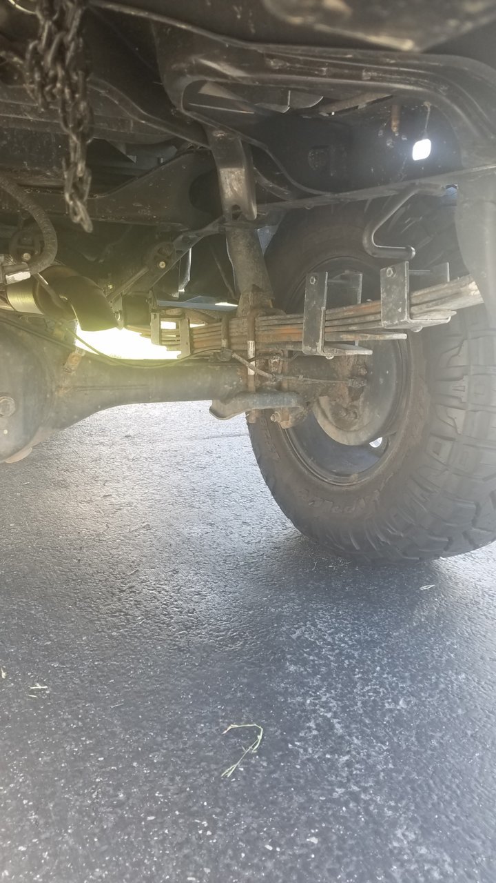

    Normal, my first gen Dakars did this too. Dakars are not known to have the u-shaped arc that other springs have like All Pros, for instance. When I added an AAL to mine it helped shape them some but Dakars are known to be soft riding springs and I think this is partly why.

    You're running 4 extra leafs in your Dakars? Dang.

    I'm going to ask this... do you know for a fact that you installed them correctly? Torqued after compression?

    Yes. Torqued when I installed then. Loosened & retorqued after ~5K miles with vehicle weight on them because I couldn't remember if I did it with it on the ground the first time. Rechecked after ~1K miles to make sure they stayed torqued.

    Your installation sounds fine. Just exactly how much lift are you getting, then?

    Before lift:
    DS 21.75
    PS 22 1/8
    After lift:
    DS 24 1/8
    PS 24.5
    So roughly 2.5" lift in rear.

    Looks completely normal for dakars.

    That's about what they are supposed to be with an empty bed and minimal cargo. Could use a trim packer on the driver's but otherwise they have positive arch at the end, the middle is flat. I don't see what's wrong.
