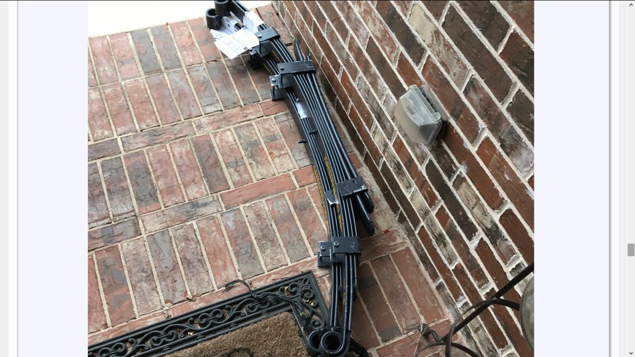

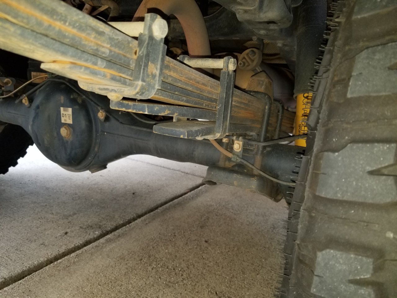

    When you went wheeling did you by chance flex out on the rear? Reason im asking is that i usually see the springs take this shape after flexing pretty hard without bump stops, thus de arching the spring at one point or another.

    The pic in my avatar is the hardest it's been flexed & the bump-stops were installed.

    yea its normal, thats what springs do.

    I have to strongly disagree with this. I've never had a set of leaf springs do this after 25 years of driving 4wd trucks, from an S-10 to a 1 ton dually, & 100's of 1,000's of miles. Even towing a ton of different trailers from a 4' trailer that weighs 300 lbs. to a 40' enclosed trailer weighing almost 20K lbs. loaded.
    I've never seen a set of leafs springs shaped like this, especially in 10K miles towing nothing.

    Didn't you notice the flat section over the spring perch when you put them on? That's how OME springs have been made for a long time. They're not perfectly elliptical.

    I have zero weight besides the same Bumper/spare and mine ride decent and do not have any negative arch.

    This is the shape of them when I received them.
    If OME intended for them to be S shaped, they'd of made them that way. They're clearly arched liked almost all other leaf springs.
    New they did have more of a flat section ~3" on each side of the pin than most leafs I've had but it's much more pronounced now. It's like they're already wore out.

    Yes I did but now they arch like a W instead of a U.

    You asked us if it’s normal in the OP. Everyone is telling you it’s normal for Dakar’s yet you refuse to accept that. Well, now what?

    The vendor who sold them says what to do - call OME. There'll be disagreement with what they inevitably say (it's normal for Dakars). At which point all that's left is to recommend removal and selling them to get Alcan/Deaver/All-Pro.
