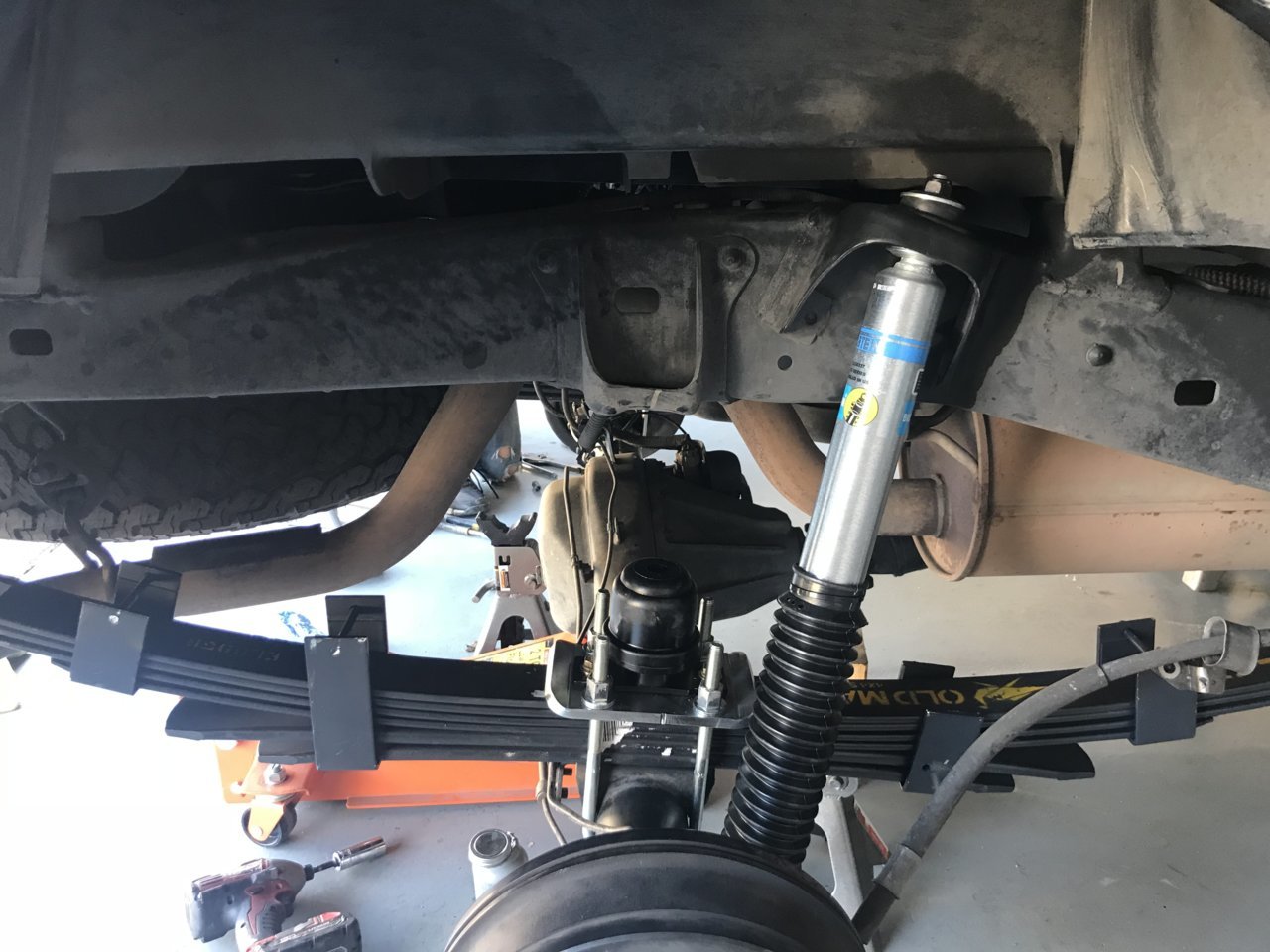

    Finally had time to take the tire off and get some pics. It’s clearly not an optical illusion. Also, they have almost zero movement so their performance is not what’s to be expected as well. I’ll be sending pics to OME tomorrow.

    You have the jack pushing up on the rear end. If you had zero movement you would have no arch on the leaf spring as the lift is pushing up the rear end.

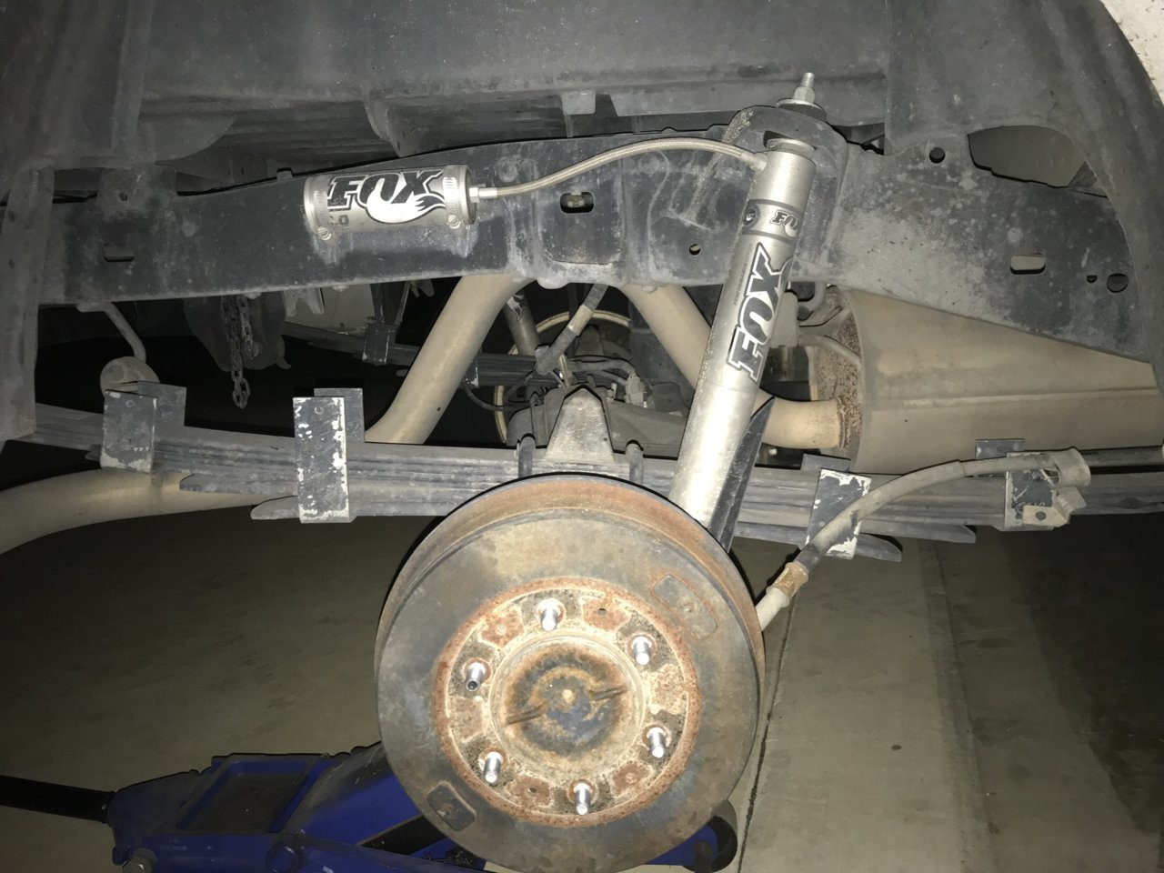

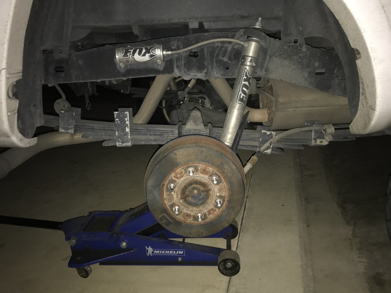

    Dude. My standard duty Dakar’s look identical to yours. My pack rides fantastic albeit just a hair harsh because I have no weight in my bed. It flexes great and has treated me well since I installed it approx 6k miles ago. I too was once worried about what appeared to be an abnormal pack appearance but it all does exactly what it’s supposed to and what it said it would when I bought it. I don’t have a picture of it right now but mine looks exactly like yours and still performs and does all of the things OME said it would.

    There is nothing about those pictures that makes it "clear" that it is not an illusion. Not without holding up something that is **known to be straight** to compare it against.
    Those springs, in fact, do NOT look like they are reverse-arched.
    Also, your jack is lifting up on one side, but not the other, so the truck is NOT standing level, and you are NOT subjecting the two sides to even load.
    And I'm not sure what you mean by "zero movement". Are you trying to suggest that your truck doesn't go up and down with respect to the rear axle? If that is the case, I promise you it isn't the springs. The only thing that can cause THAT to happen, is the SHOCKS.

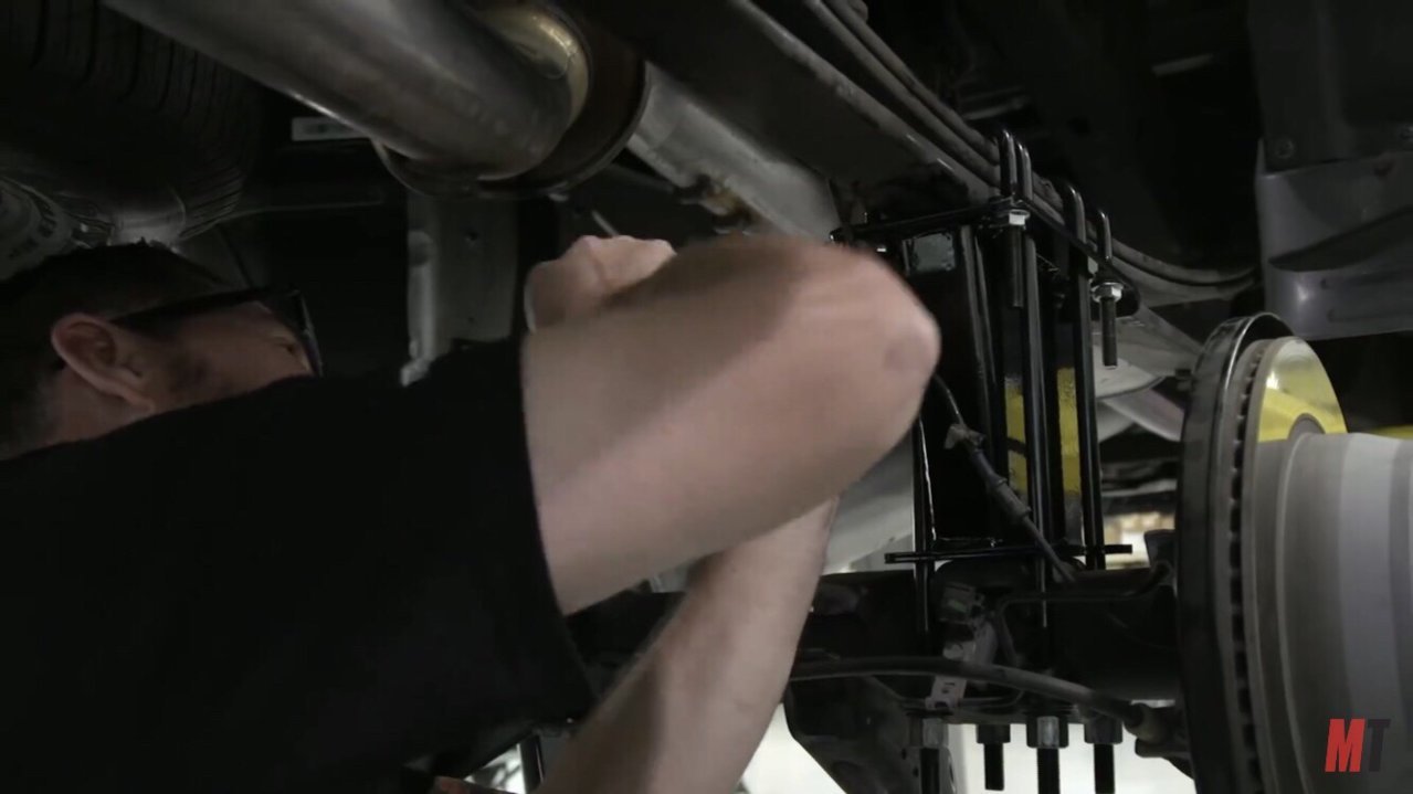

    This motor trend video is where it’s at. This is typical mod style on big chevys from what I’ve seen. Pay attention to the big chevys you see driving around with 8 & 10” lifts. I bet most of them have blocks like that.
    https://youtu.be/SEy5tV6_Dlg

    Watching them install the front shocks makes me cringe at the number of failure points on the lower shock bolt...
