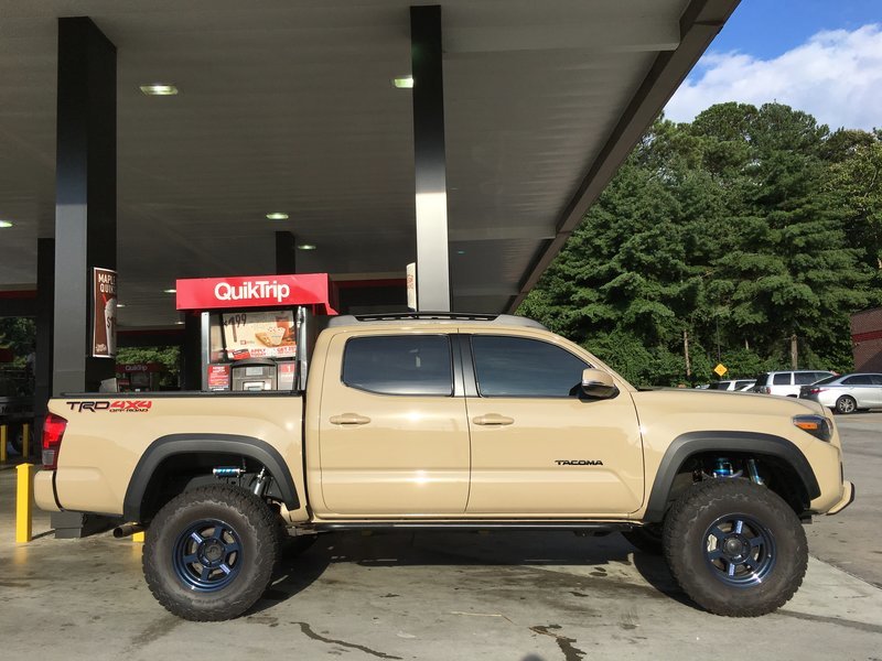

    I have everything you're installing but opted for Kings. The rears sir fairly high initial but will settle down some.
    I thought everything was pretty straight forward during the install. I did it all by myself one night.

    It's your standard 285/75/16. I will probably bump up to a 35" tire once these tires are worn out.

    False. I sit almost level with a slight rake with my install. It will be very raked initially but it settles after a week or so

    I have the 2.5 FOX extended fronts, leaf pack in rear. I bet you will have some rake after the coils settle. I cranked mine up after settling, but on the verge of too much preload. I am going to switch the coils out for 14" instead of the 13" it comes withto get a level ride.

    Looks a little low in the rear to me. ;)
    Leave the extra leaf OP. A little rake is way better than lower in the rear.
