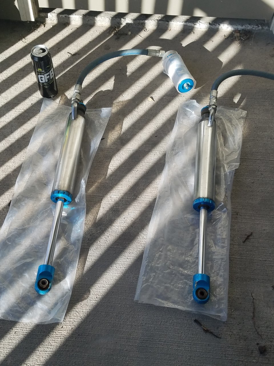

    Like @whatstcp said, it would be a good idea. The Bilsteins he quoted would do you well.
    You could also possibly find a set of used shocks in the BST area, etc that give you a little more bang for your buck.
    I got these Kings for a pretty good deal last summer off one of the local FB groups.
