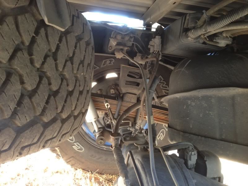

    I'm thinking this is the route I will be going. Are you removing the stock bump stop and using a 5'' bump stop, or just putting another bump stop where the stock bump hits the frame like in the picture?
  6. Feb 27, 2017 at 12:50 PM
    Moosedog
    Moosedog Well-Known Member
    Jun 11, 2014
    #131743
    145
    Bryan
    Harrisburg, Or
    99 tacoma SR5 TRD v6
    kings, dakars, relentless front bumper, NWTI rear bumper
    That would probably work, what's in the pic. That aftermarket bump is 4.5 in tall I believe, and another 2.5 in with the stock. I'm removing the stock bump and replacing it with custom bracket the wheelers superbump will sit on. Just so you know, if you go with the full droop of the dakars, you will need an extended brake line. And if you have the rear locker, you will need to watch the actuator harness.
