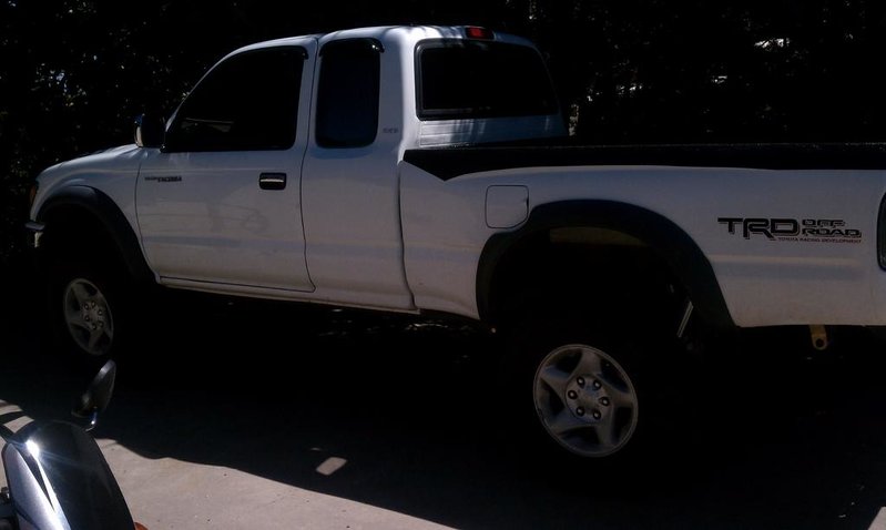

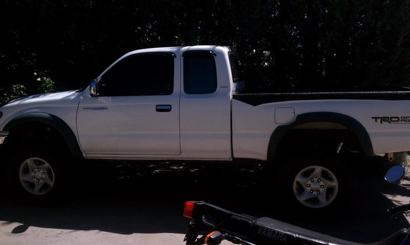

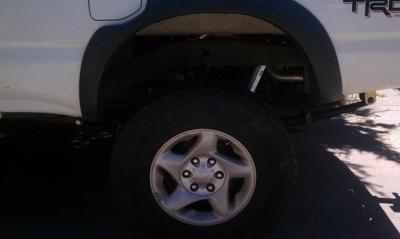

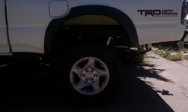

    Hey guys.
    Currently I have a 2001 taco with a 3.4 4x4 trd and I need help with my axle placement.
    I installed my new dakar leaf springs last night with axle shims. Unfortunately the pin didn't protrude far enough through the shim to lock in to the axle brackets. I know the different solutions to fix this but the real issue is that the axle is located too far forward in the wheel well to put 33's in.
    I think the reason why this is is because I combined the dakars with a toytec 1" lift shackle. I don't want to remove this because I need them to keep the bed from sagging when I pull my travel trailer. Plus I like a little rake.
    The rear axle needs to move about an inch and a half to the rear to center the wheels in the wheel wells. I've thought about drilling secondary holes in the bracket forward of the stock pin locaters. I've seen a website off of a jeep forum that sells a small plate that you bolt to the bracket to relocate the pins forward or backward.
    I am ordering extended leaf pack pins to clear the shim but I really need to move the axle back because I know the axle is placed correctly to the springs right now. I have a strong feeling that the extended shackle is pushing the springs forward a bit.
    Any suggestions? This is a very difficult topic to research on google. I can't find the right wording...
    I would really appreciate any help!
    Thank you :)

    Good shims should be bolted to the pack by the center pins. A shim that simply sits over the center pin is super sketchy. I would take that out.

    Ummmm, not real sure here... BUT are your sure you didn't put the leaf springs in backwards?? I don't understand how they could be that far off on centering the wheel unless the springs were installed backwards.
    I know on my 97 that is defiantly possible. The pin is not centered, it is offset from the center of the leaf. Meaning its a shorter distance from the center pin to one end, than it is from center pin to the other end.

    I'm pretty sure the shims just suck. I'm going to take them out tonight and do a carrier bearing drop. I have no vibes at all so it should be just fine.
    The shims' slot is too wide and long. It could slip and move if I hit a big enough pot hole. Soo stupid. They rotated the back of my axle down too far so that my e-brake line is dragging on top of my leafs. My e-brake light stays on even though they are just slightly engaged.
    When I take them out it should rotate the axle and wheels back far enough to mount my 33's. I will get the pins in the axle mounts then create rear traction on it with ratchet straps and my fists to move the axle as far back as possible as the pins will go.
    I will see what toyteclifts can do for me as far as a return.
    The shims as yotadan stated are absolute crap. I highly recommend not using them unless you relocate your axle mounts. If I have to, I will manufacture an axle shim for myself that will work for me.
