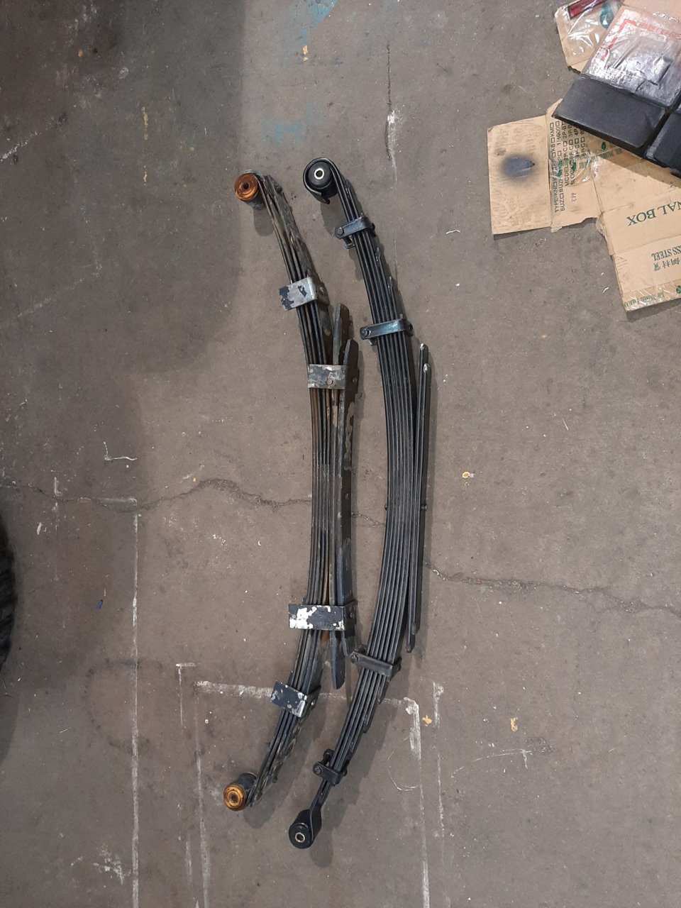

    So I just installed my leafs (they were used) so I also replaced the old bushings with a new set of OME ones. I did the install myself with the help of a friend who does off road racing suspension. He told me it was normal to hear the squeaking because the urethane bushings. We added sufficient grease where required at the pivot points.
    I guess I'm just wondering if and for how long to expect this creak/squeaking to carry on for. It's ungodly loud and causes lots of heads to turn in the wrong way.

    For forever, until you change them for different leafs

    Only fix is change them to deavers

    well hell...I was really hoping it was a "breaking in period" type of thing that would eventually quiet down. Shit.

    Lol no, they only get worse

    It's only been 2 weeks, but the squeaking has significantly quieted down! I can still hear some of it in some circumstances, but for the most part its improved to an almost unnoticeable amount.
    We'll see how long this lasts...
