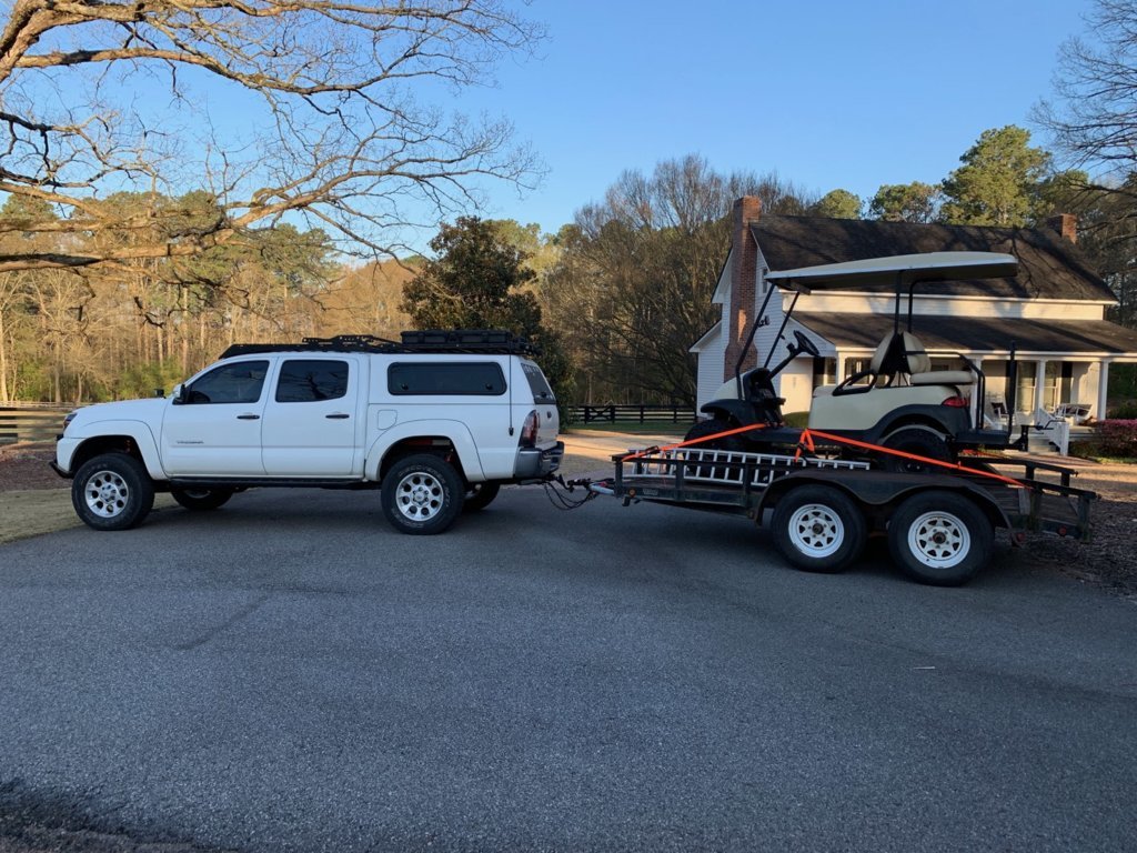

    I just installed the Dakar HD leafs and pulled a utility trailer loaded with a golf cart 600 miles from Ohio to GA and I’m glad I got the HD springs instead of the medium.
    I previously had the oem leafs with a progressive AAL and Ride Right airbags for 90K miles. It was a good setup but the Dakar HD pack rides better.
    The HD is just the medium with the added leaf that if you bought the medium and needed you can purchase. But cost wise it’s cheaper to by the HD and remove the leaf. If you want the medium.
    To compare, I also have a bed cap, rack, tools for constant weight and the Timbren Bump Stop U bolt flip kit. (Which is also awesome)

  4. Apr 7, 2019 at 4:38 AM
    EdinCincinnati
    EdinCincinnati Well-Known Member
    Mar 11, 2013
    #99457
    2,429
    Ed
    Ohio
    2014 4x4 TRD OR
