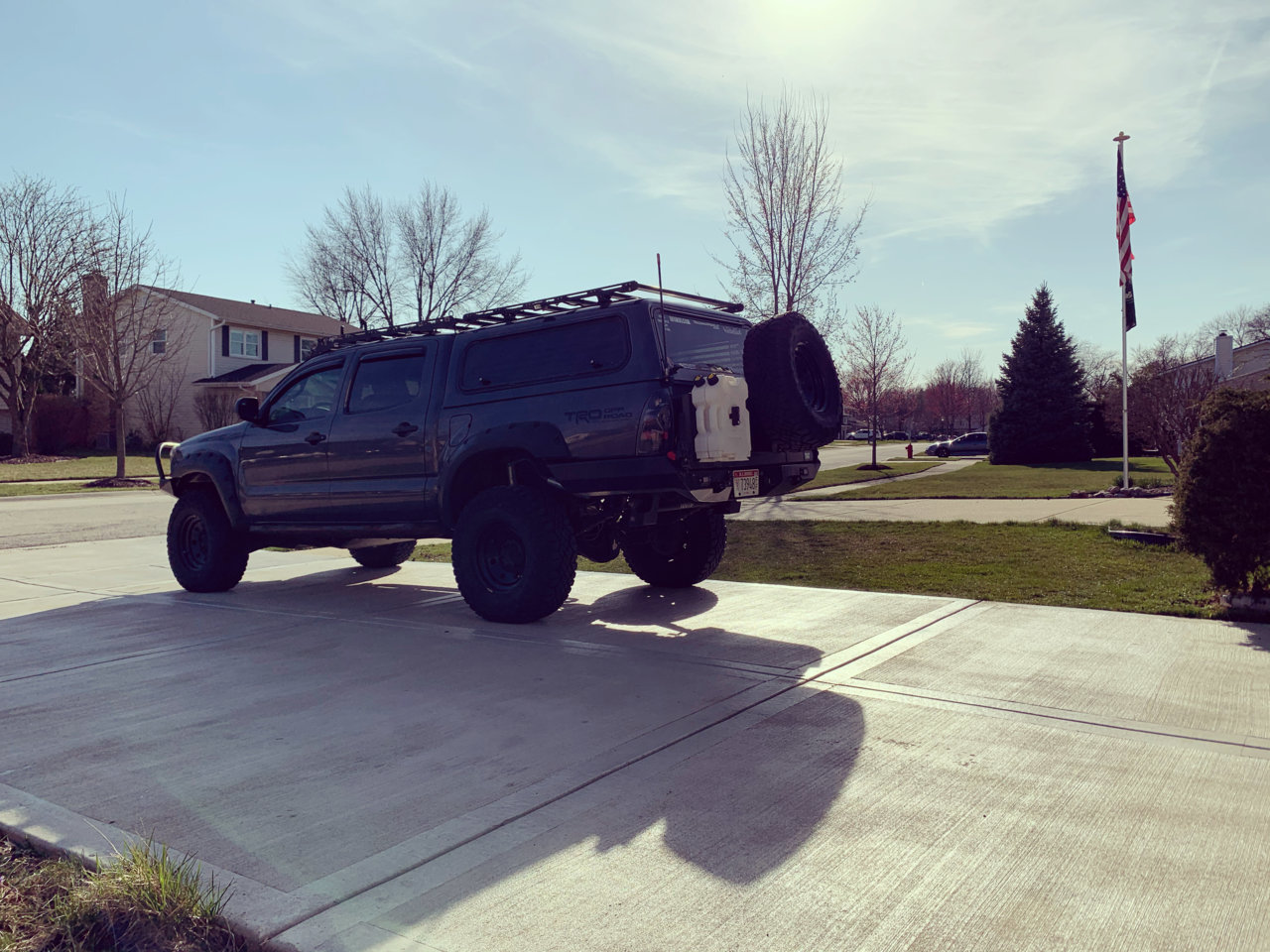

    What rear bumper is that?
    geekhouse23[QUOTED] likes this.
  17. Apr 14, 2020 at 11:28 AM
    #17
    geekhouse23
    geekhouse23 The "Liftman" - @DrFunker
    Jul 14, 2013
    #108251
    15,715
    2GMGMDCSB4WDTRDFTMFW!! TL;DR
    mostly stock, grocery gettin' Prius
    Chapter 7 armor my friend aka bankruptbilt aka pelfreybilt
