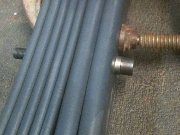

    ummm yeah
    are the center pins gonna be long enough?:confused:

    Send OZ-T a pm or look at his threads. He ran into the same problem. I didn't get axel shims with mine, instead I got a drive shaft spacers.

    pretty sure he didnt add the D29XL.
    pretty sure

    You should be fine , the Dakar centring pin is about an inch extra long on the top of the pack , the collar is only about 3/8" and the overloads are about 1/2" thick .

    We just cut off the extra bolt length when we were done .

    The nut is on past the cut so it would be no problem getting it off , I would just replace the centering pins if I ever added the extra leaf , I think they are about $8 a pair
